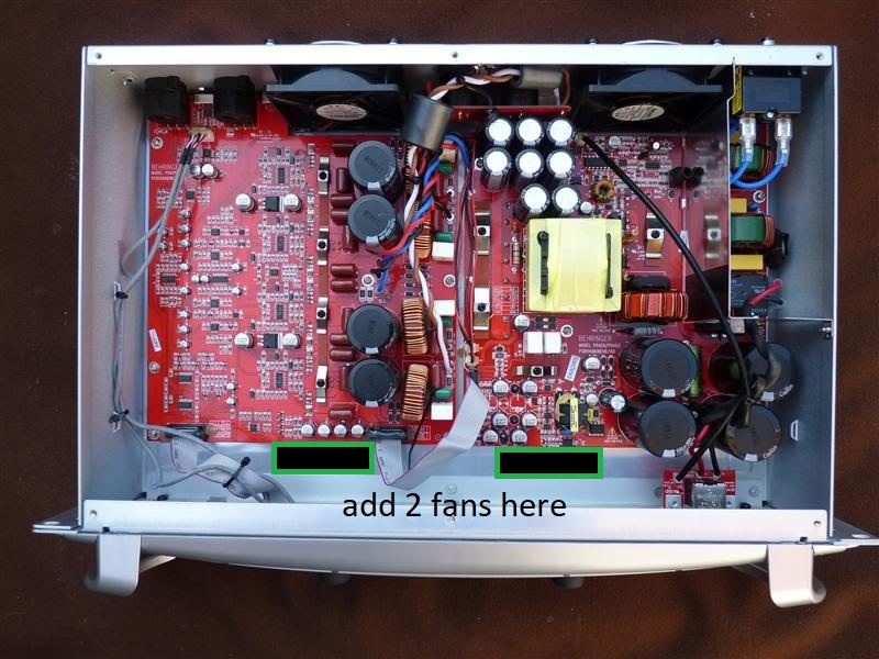

Weissi, I'd be worried about overloading the 24V supply with additional fans, but simply moving them to that side of the board might work. I guess the fans would need some kind of baffle, though, or they'll just short-circuit.

Someone has already tried reversing the fan and measured temperatures on a NU6000DSP: https://www.avsforum.com/forum/155-...01-inuke-nu6000dsp-fan-direction-results.html
The fan is not stock, it is a low noise one. The amplifier mosfets do not care about the direction, though a small component of the power supply prefers front-to-back.
I did reverse airflow on iNU6KDSP and changed from 4000rpm to low noise arctic f8 2000rpm:
Result: ~ 2 x 800W into 8 Ohms, both channels driven, continuously.
Someone has already tried reversing the fan and measured temperatures on a NU6000DSP: Inuke nu6000DSP fan direction results - AVS Forum | Home Theater Discussions And Reviews

I thought about the reversed airflow in the inuke before I bought 3 nu4's ; they run so cool that when you mount them lower then the other (hotter?) amps, there will be no problem. Just make sure air can exit somewhere at the top of the rack and has air inlet at the bottom; as warm air rises.
I would not reverse the airflow as that has great impact on the airflow in the case.
Changing the fan for a quieter one is ok as long as you don't use it at full power.

Depends on the application; cooling the case; yes. Cooling the chips in front of it; no - and that is their primary job.
Same reason you stand in front of a fan to cool down and not behind it; the airflow in front is directional and will cool a surface way better then air which is sucked from a location with least resistance, in this case about 2inches/5cm above the hot components.

... Except some measurements showed a slight improvement of output device temperature by reversing the fan direction, and a PSU component that's normally out of the air flow got cooled much better by reversing the fans.
It's important that all the amps in a rack have the same direction air flow (either F2B or B2F). I have some Powersoft amps that are F2B, so I'll be swapping the fans in my NX4-6000 (which has similar internals to the NU4-6000) to match.
The airflow must all be in the same direction because having amps with different directions will result in cycling the same volume of air, getting hotter and hotter. That's not good for the amplifiers.
