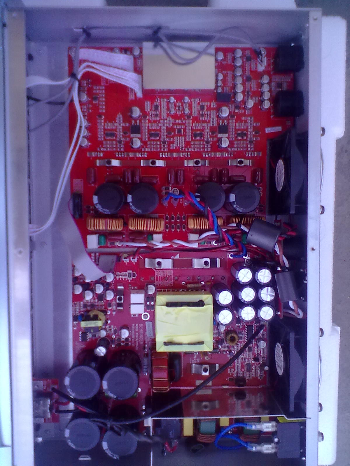

behringer nu6000 photo

Looks like the power devices on the nu6000 have V shape clips on them though I can't really see the power devices themselves .😕
Is this a bridged output for each channel? AND TWO fans !😱
Must be noisy as Hell !
I don't know if it is bridged, but it´s possible as I can see four output filter coils in the picture. A bridge class d amp is an amp straight out of hell, half the rise time, four times the power (in theory) and, most importantly, if you have the guts and a well built amp, you can get rid of the obligatory class D low pass output filter and all the distortion that these filters causes.

Today (09 November) I was tweaking something unrelated, and while assembling everything, I thought to myself "Why not try with the stock cover on?" The amp works fine, 12+ hours on. After being idle all night, the cover is slightly warm to the touch. Speculation: this may work ok for for my normal use of the NU3000, as a home stereo amp.
I hate the fan noise too, very disturbing unless pumping up the volume enough. 🙁
I measured the voltage going to one of the fans and it's at 7.6V
1. Will it make a big difference and be silent enough if I replace these with fans that say to be -7dB ?
2. How low can the voltage be before they stop spinning? I'm thinking of putting in a series of diodes, so the voltage drops at a minimum.

I've put my fans in series (iNuke6000DSP) No heat issues as I don't drive this amp at full tilt for long. (domestic use for HT)
If the amp heats up, the voltage rises, so there's a margin and a measurable way of knowing if you're going too far.
Problem solved, costs nothing.
