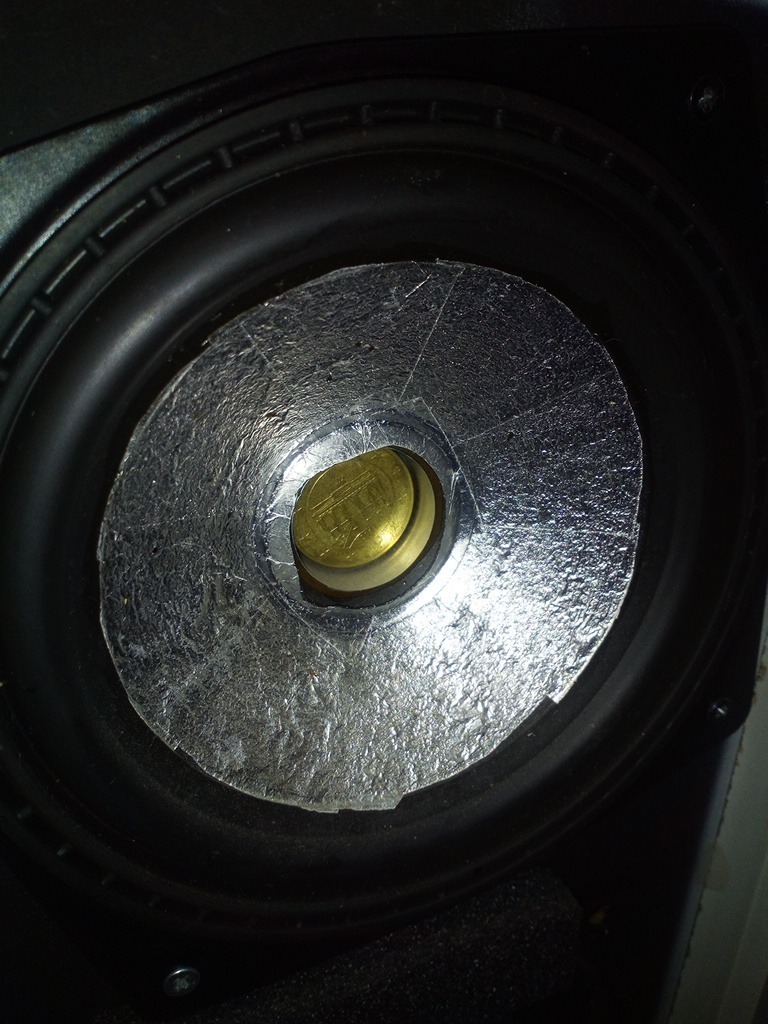

But besides frequency response, distortion reduction due to adding a copper ring to the pole piece can be heard if you DIY, here the 50 cent trick
https://www.diyaudio.com/community/threads/visaton-bg20-impressive-mod.408081/post-7576162
