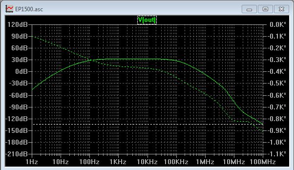

Hello to all,
I'm just doing some simulations using the EP1500 schematic that can be found on the net, and the AC analysis shows a frequency response that start dropping considerabily at 100Hz
I attached the graph of the AC analysis
I think it can be due to the double .15uF cap in series before the OP-Amp that drives the output stage, as You can see in the other attached image
Does anyone of You have a frequency response graph of the behringer in order to check it?
Or, could it be tha the values of the two .15uf caps reported in the schematic are wrong?

I just found that the 2 .15uf caps are part of the low-cut filter connected to one of the switches: bypassing them as per the circuit the response is now flat and dominated by a 10uF cap
