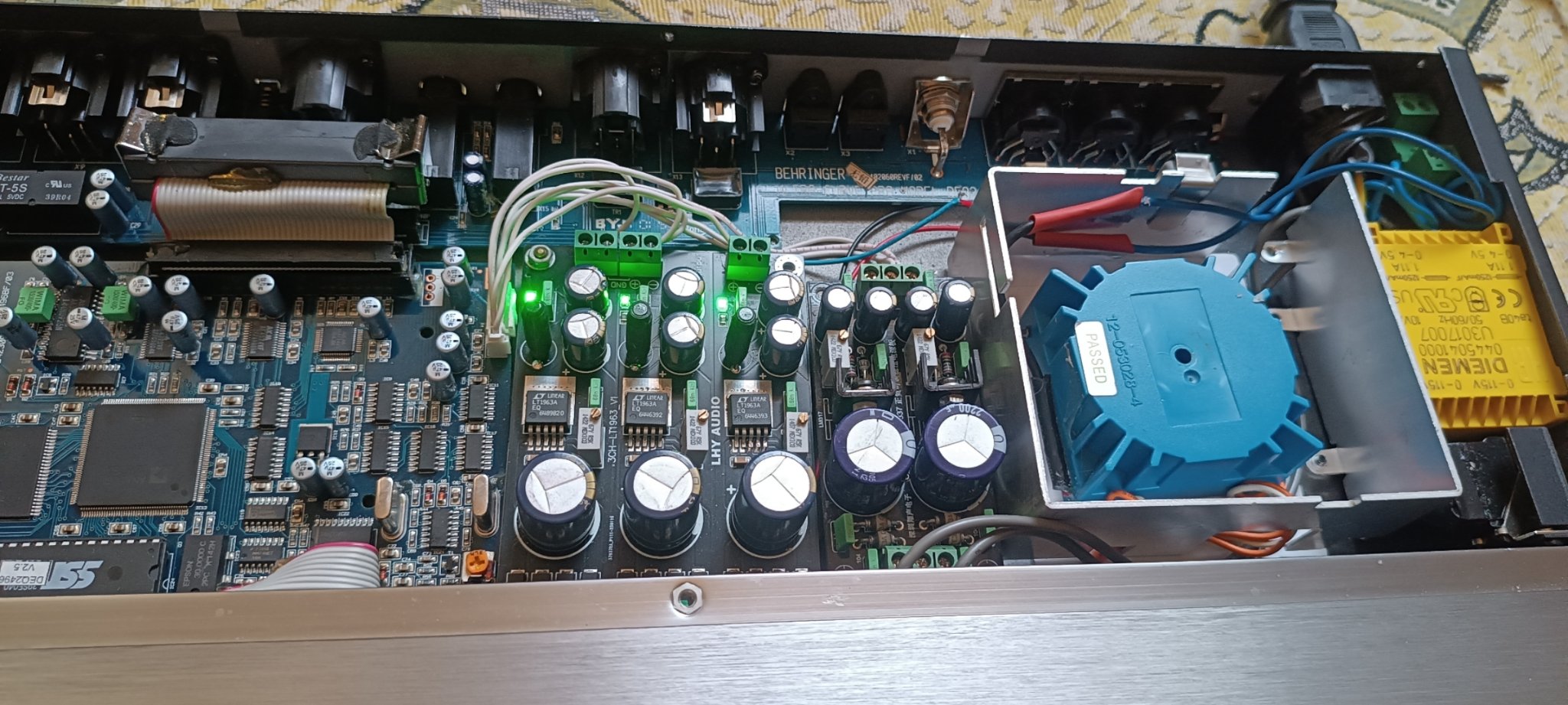

Behringer DEQ2496 linear power supply 2025

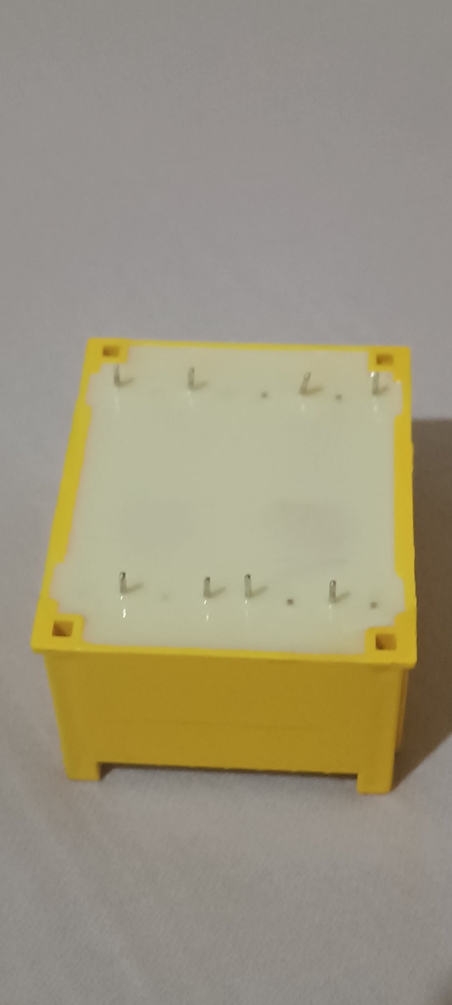

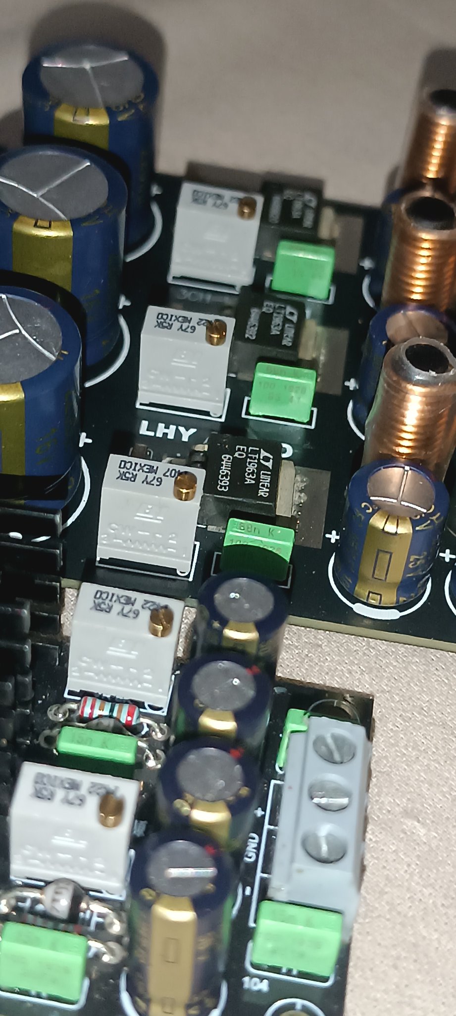

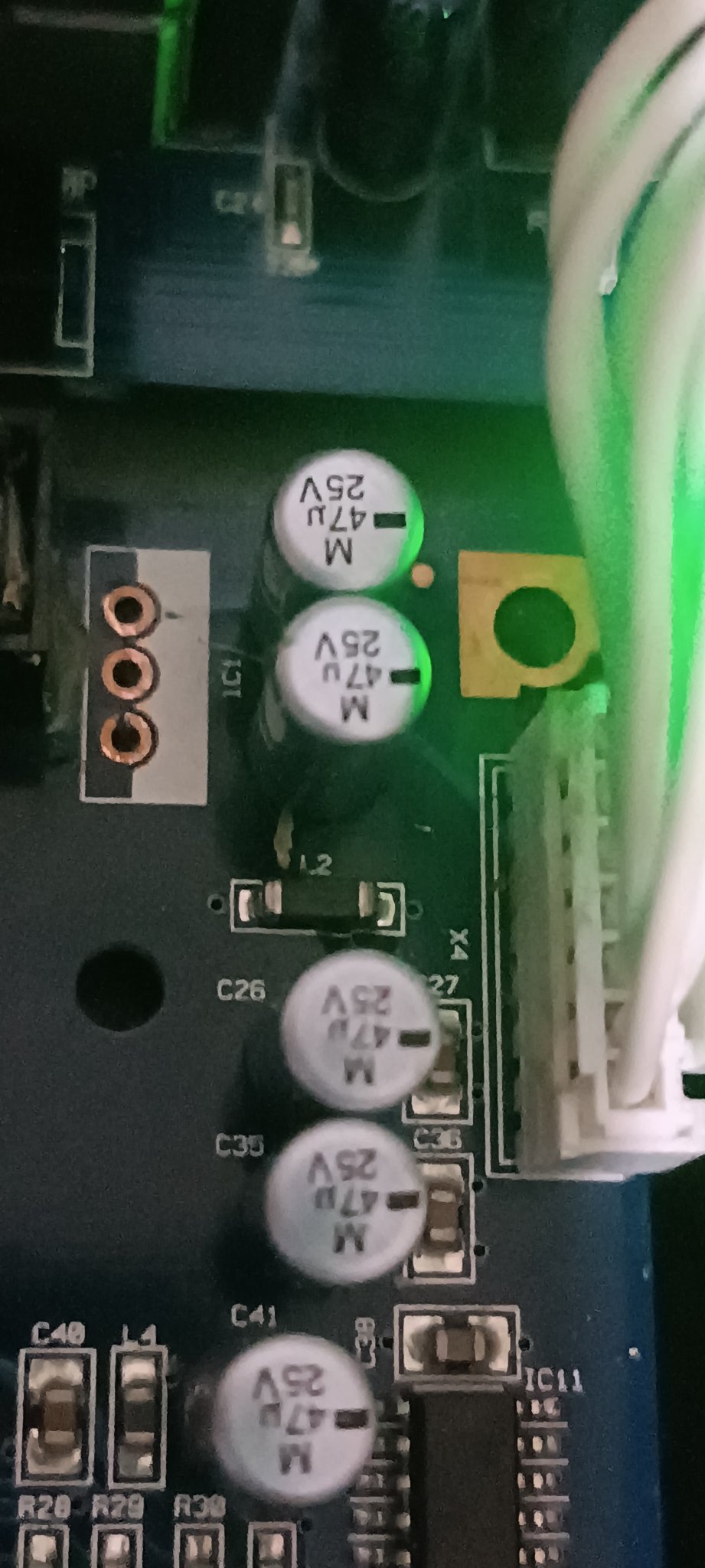

I installed a TT Electronics/BI Trimpot

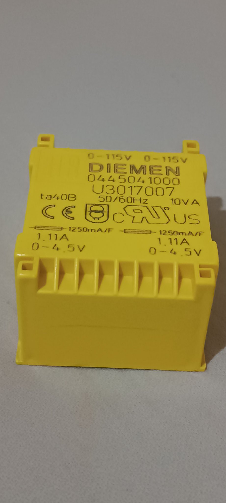

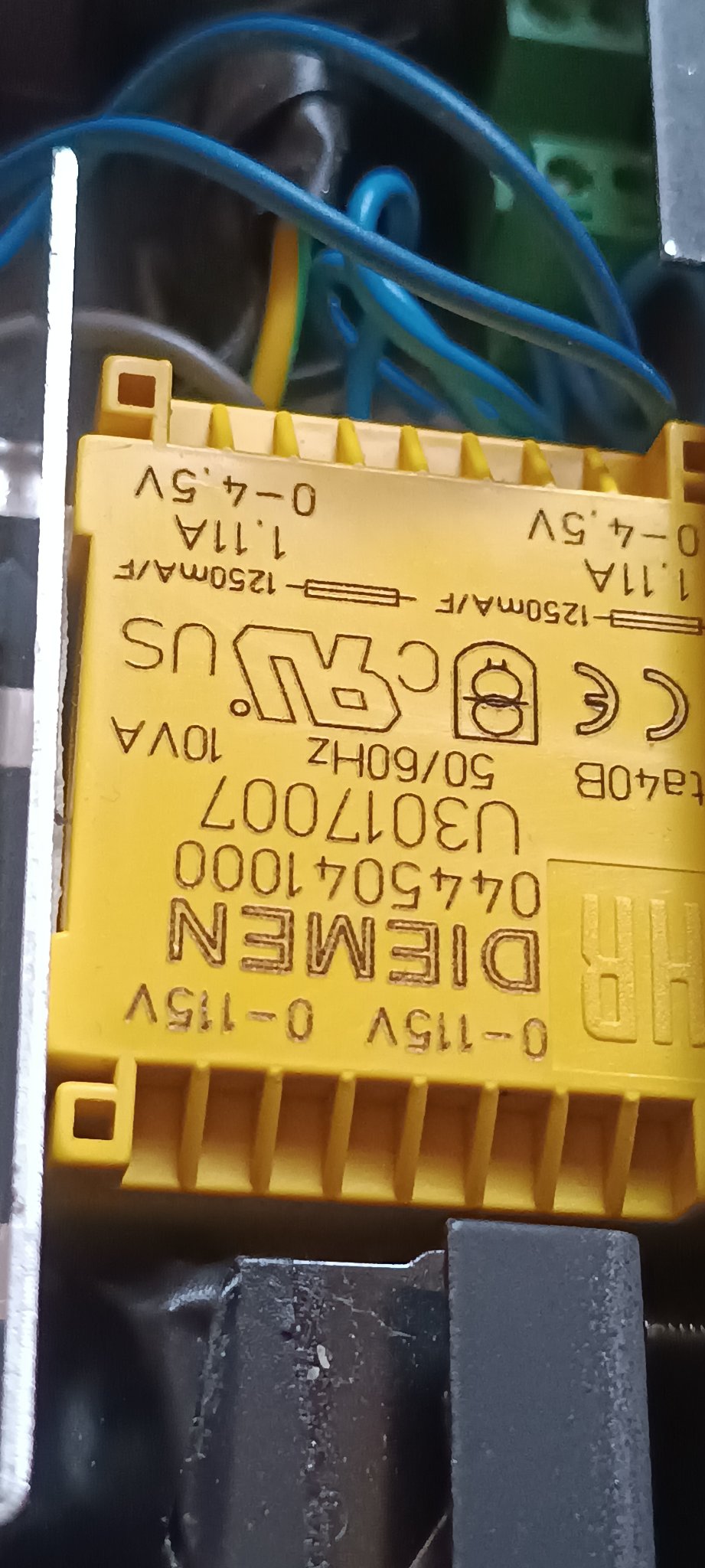

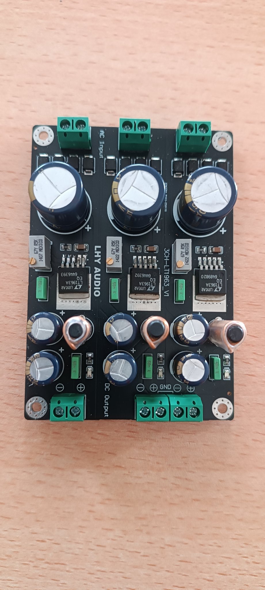

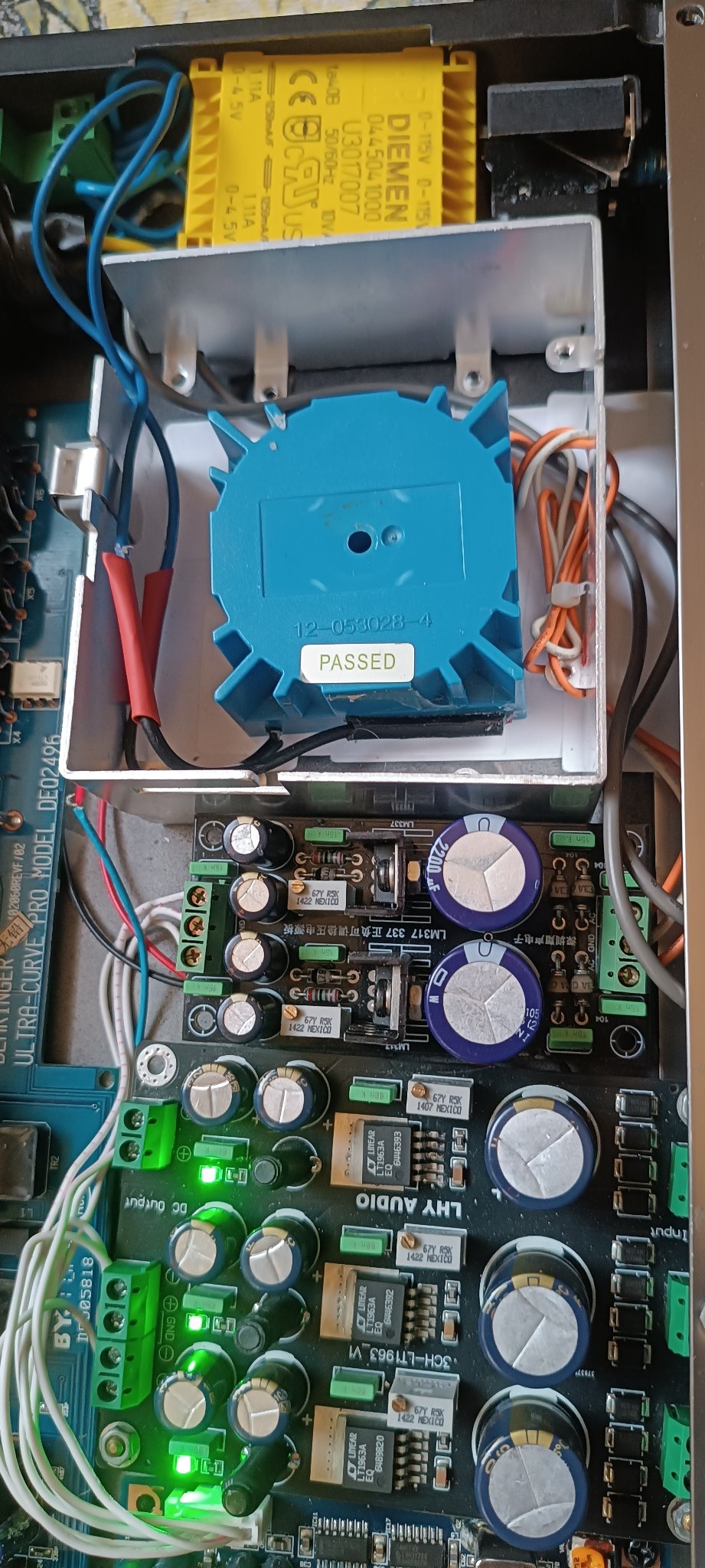

If you can find it, use a 4.5v ac transformer 10va because 9v is no longer needed. We cancel the 7805 on the digital card and give 5volts.
4.5v ac transformer runs cooler regulators than 6v ac transformer

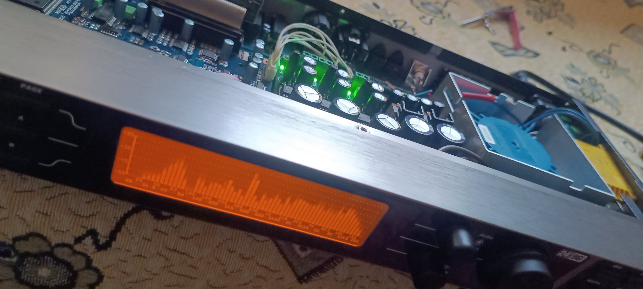

deq2496 3.3v and 5v yellow 2x4.5v ac transformer used regulators are now ice cold. 9v cancelled. 7805 regulator removed from digital card takes 5v directly from regulator
