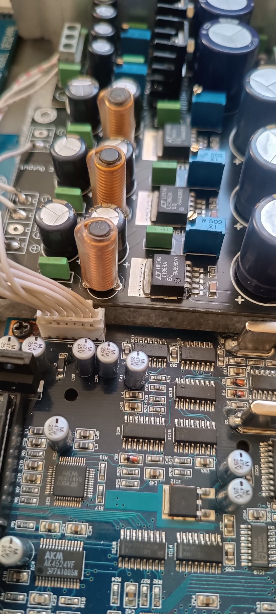

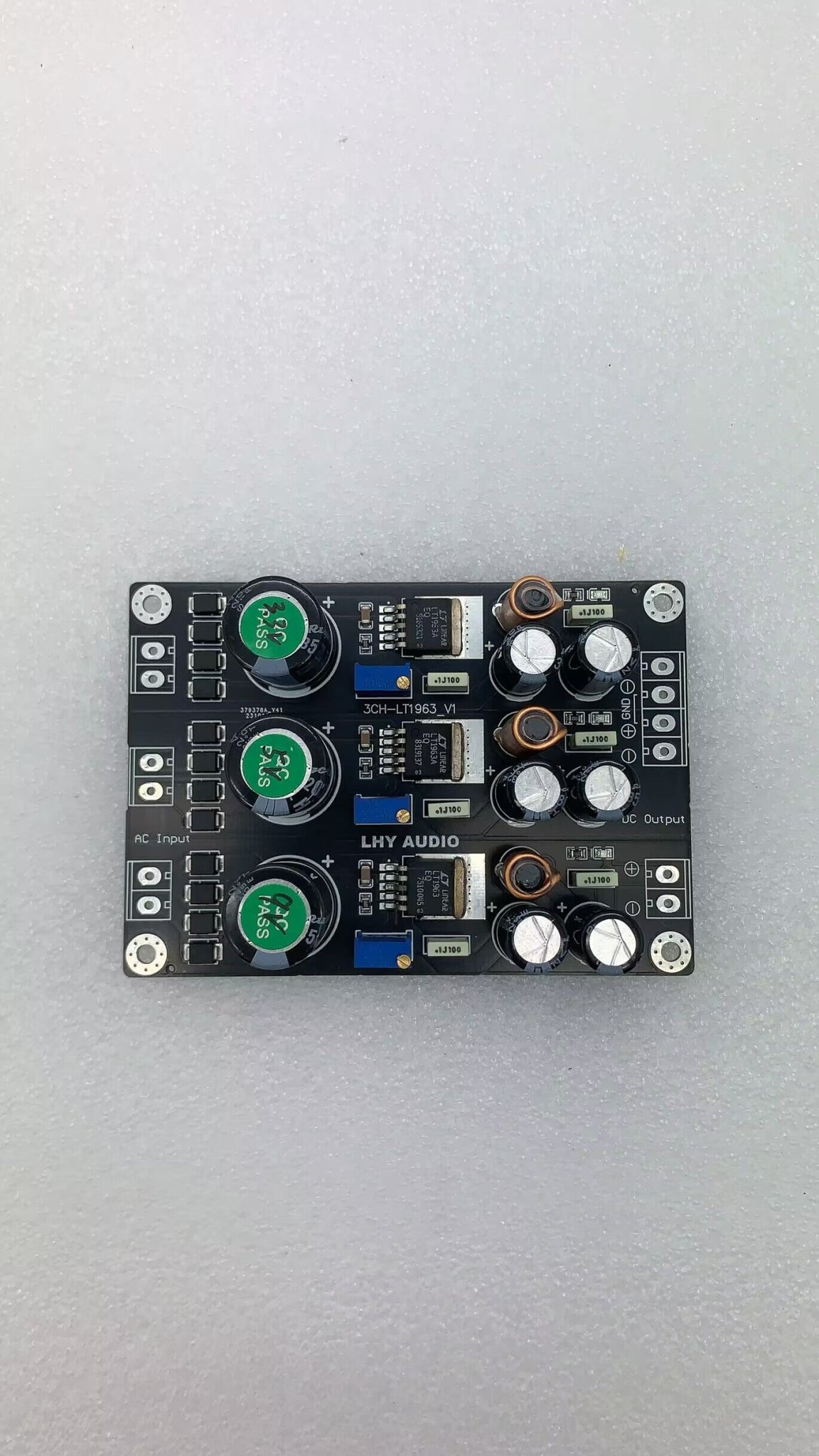

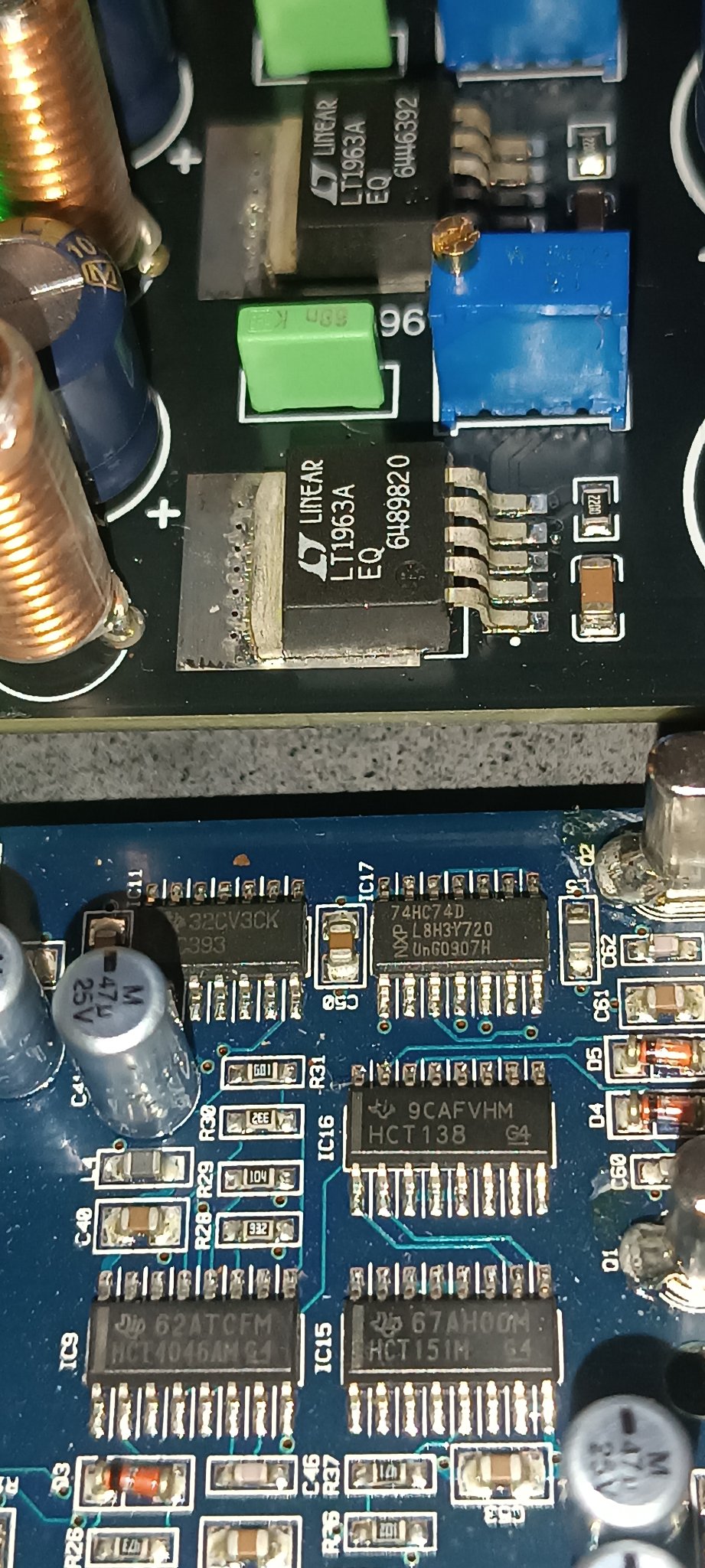

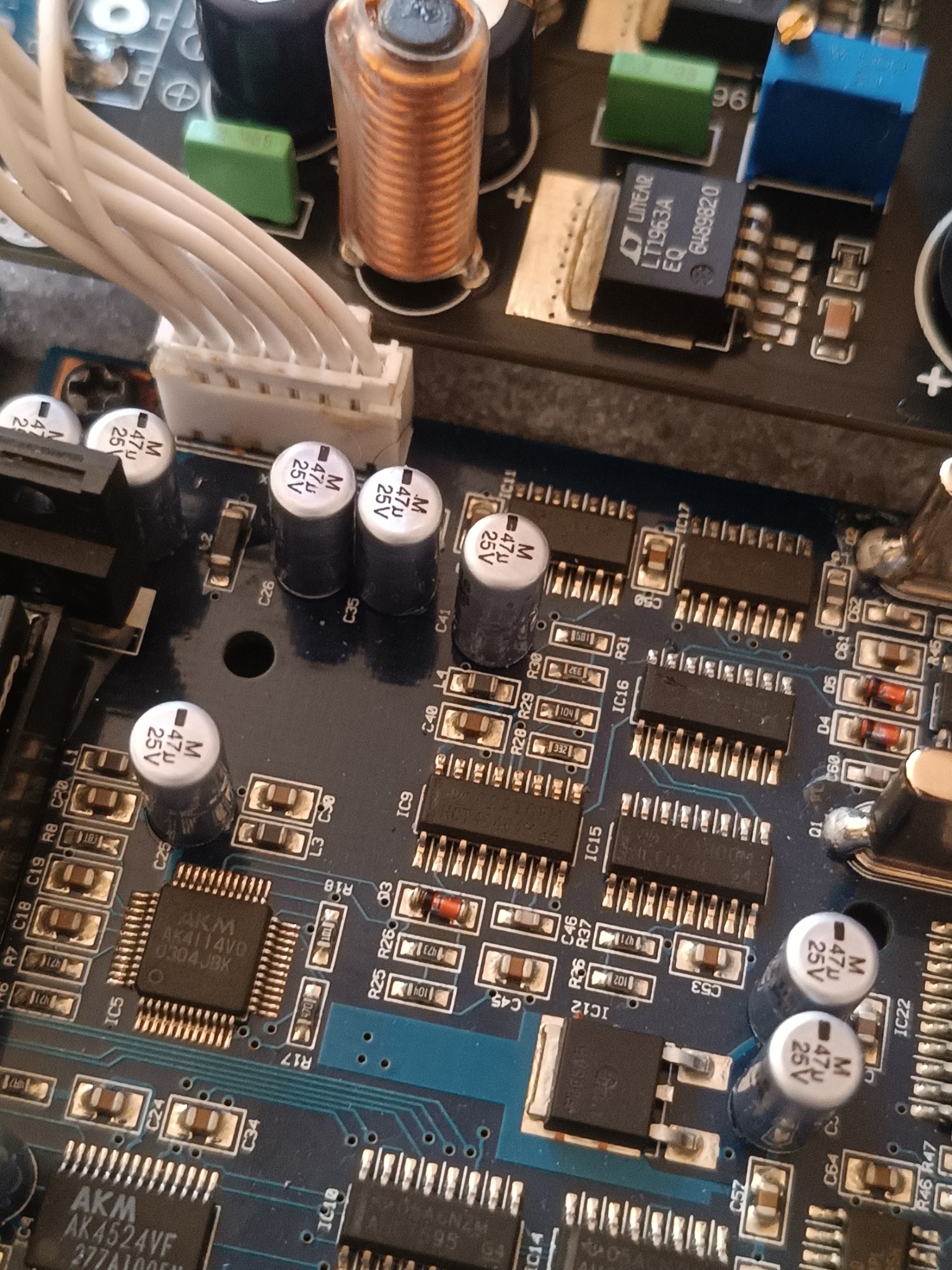

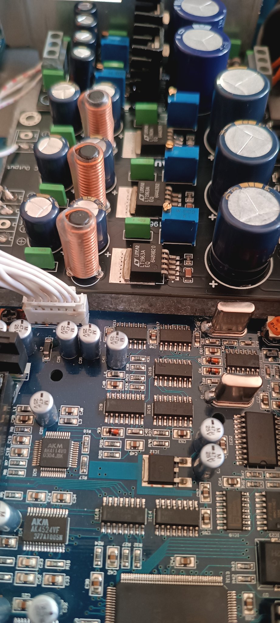

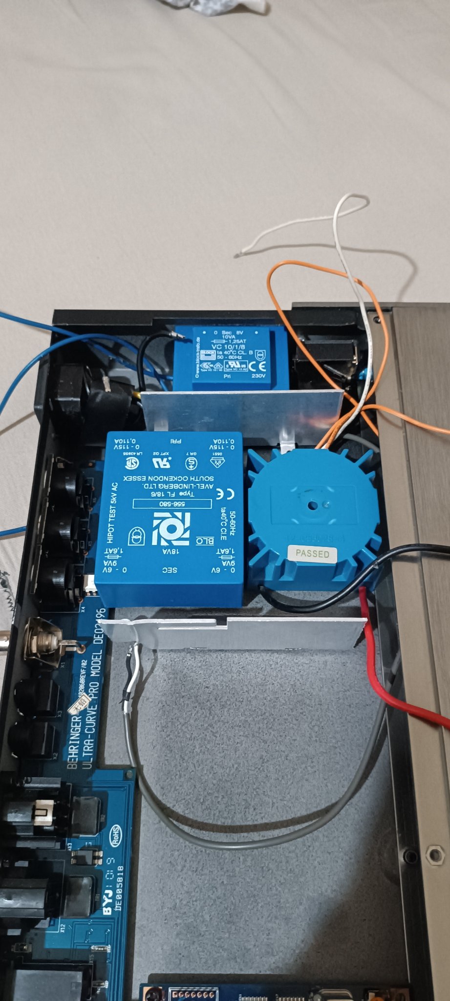

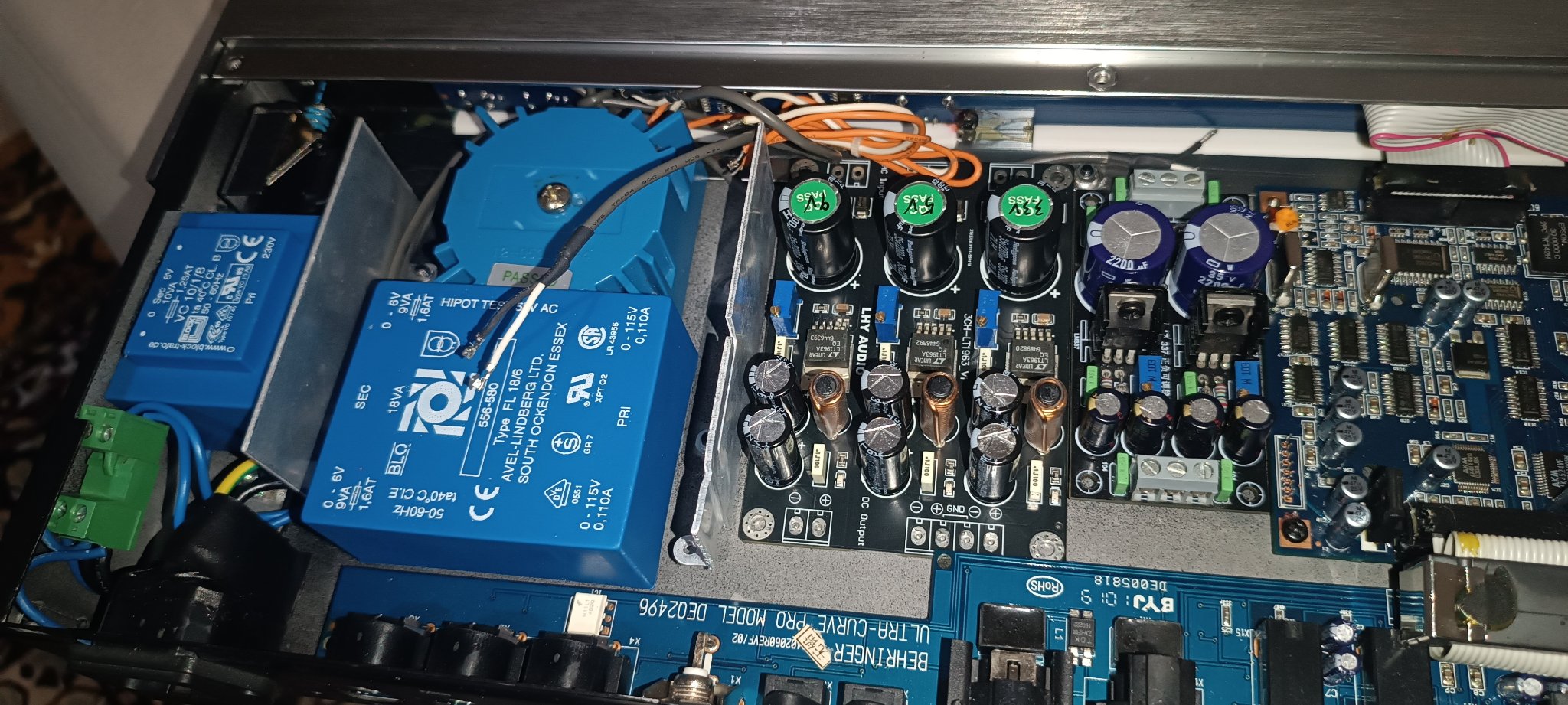

For digital section I will use LT1963A low noise circuit. I am attaching the picture.
+3.3v +5v +9v
+3.3v +5v +9v

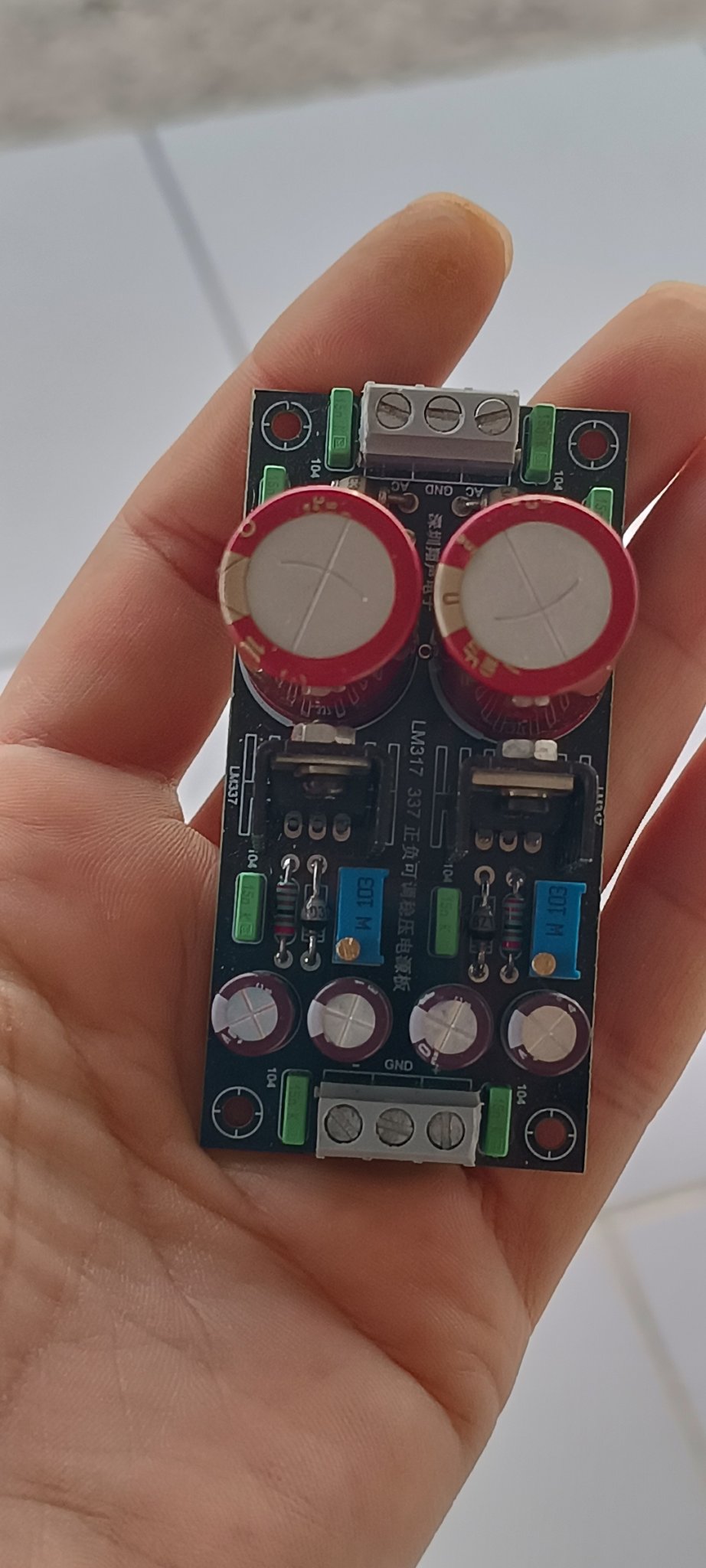

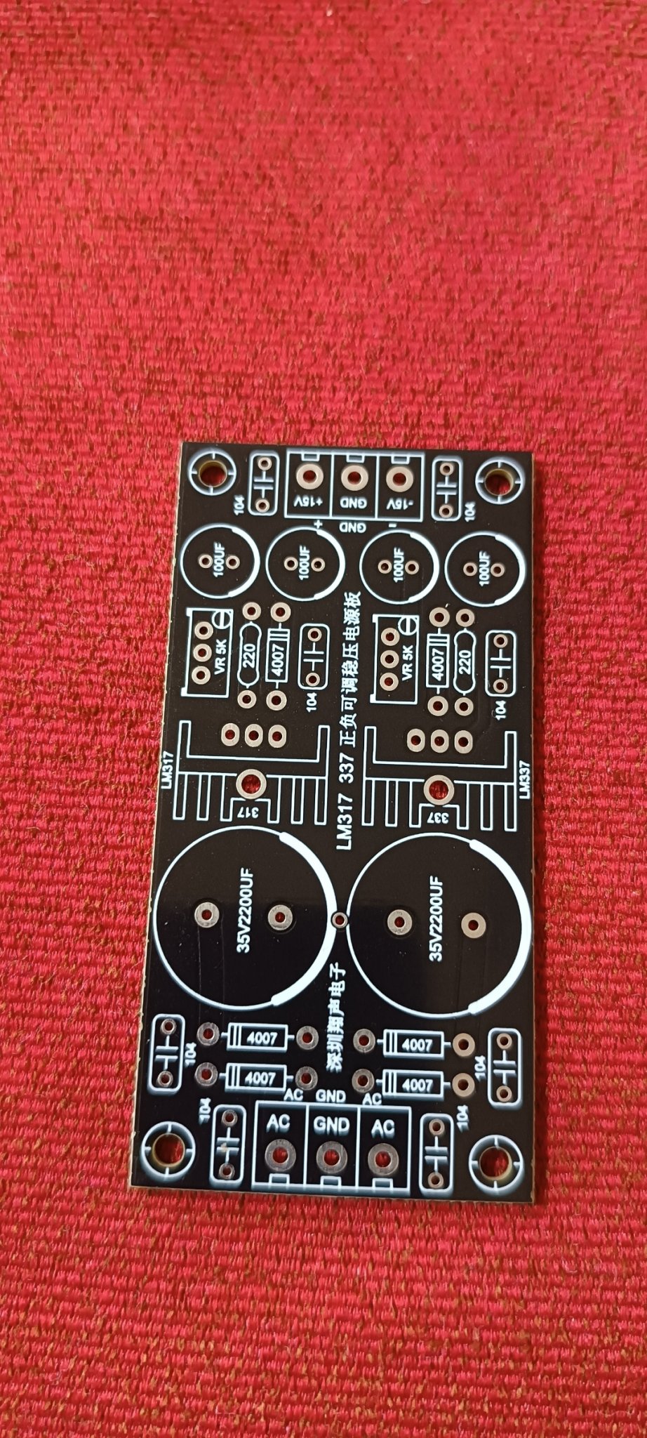

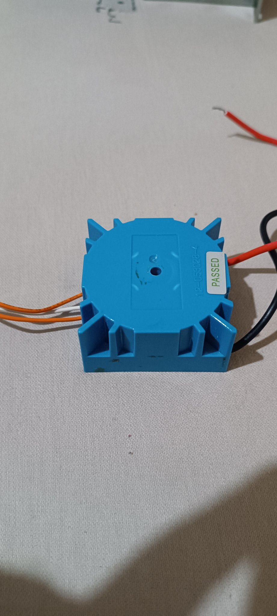

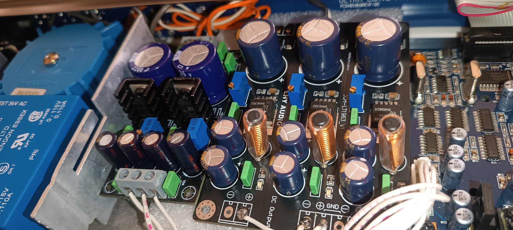

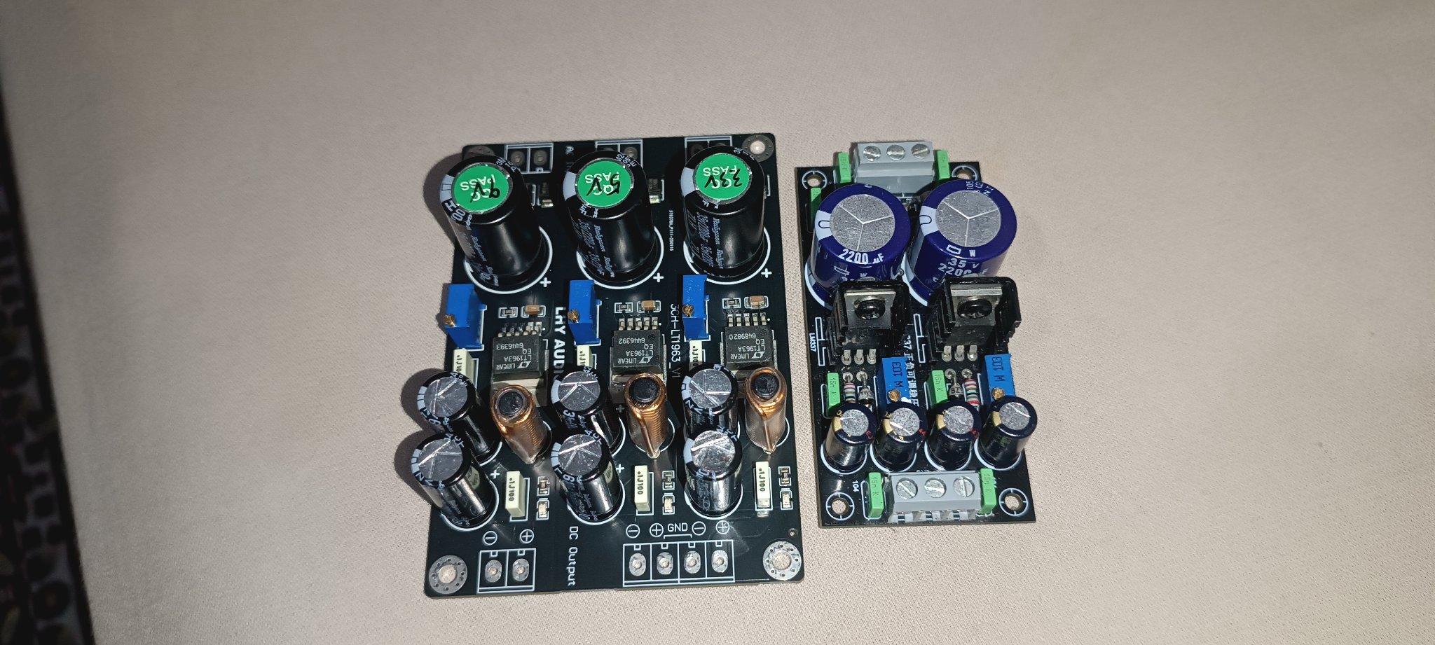

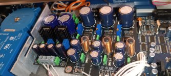

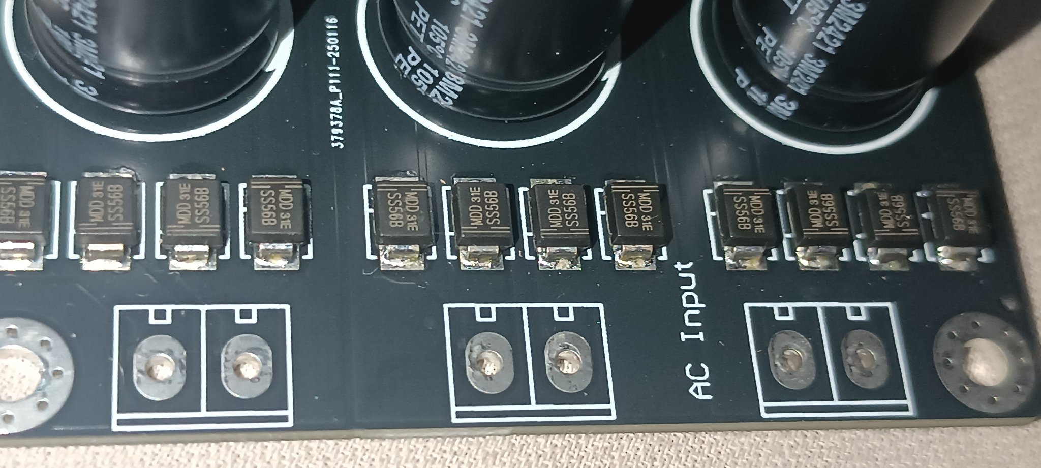

I will use the card in the image for 2x15v for the deq2496 analog section.View attachment 1432636

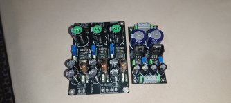

2x15v +- finished version for analog card lm317 lm337

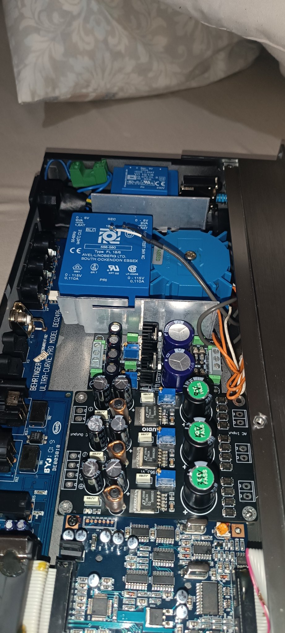

Good work and nice that it work as you wish. What was your intention, what are you mastering and what was the benefit? How much do you spend?
Lot of questions 😄
Greetings
Lot of questions 😄
Greetings

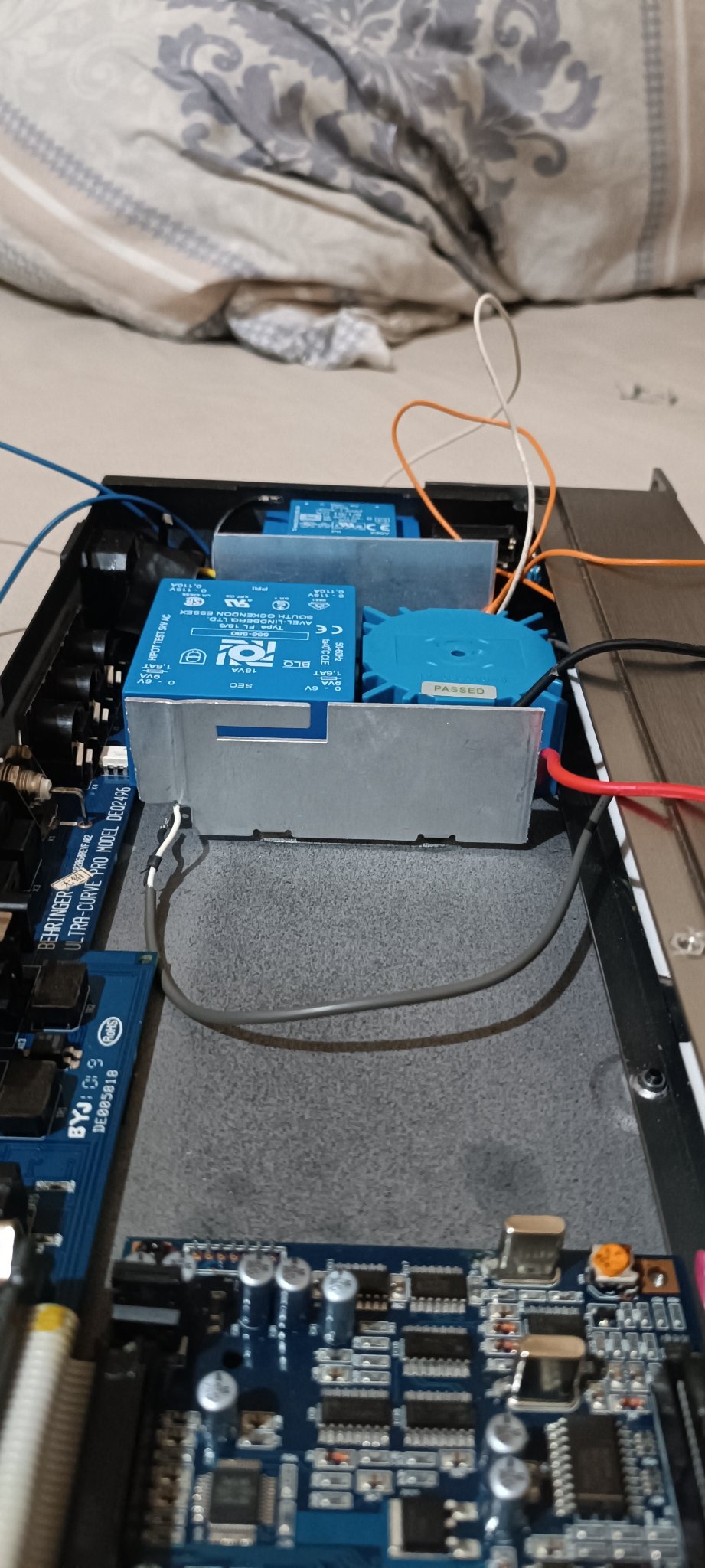

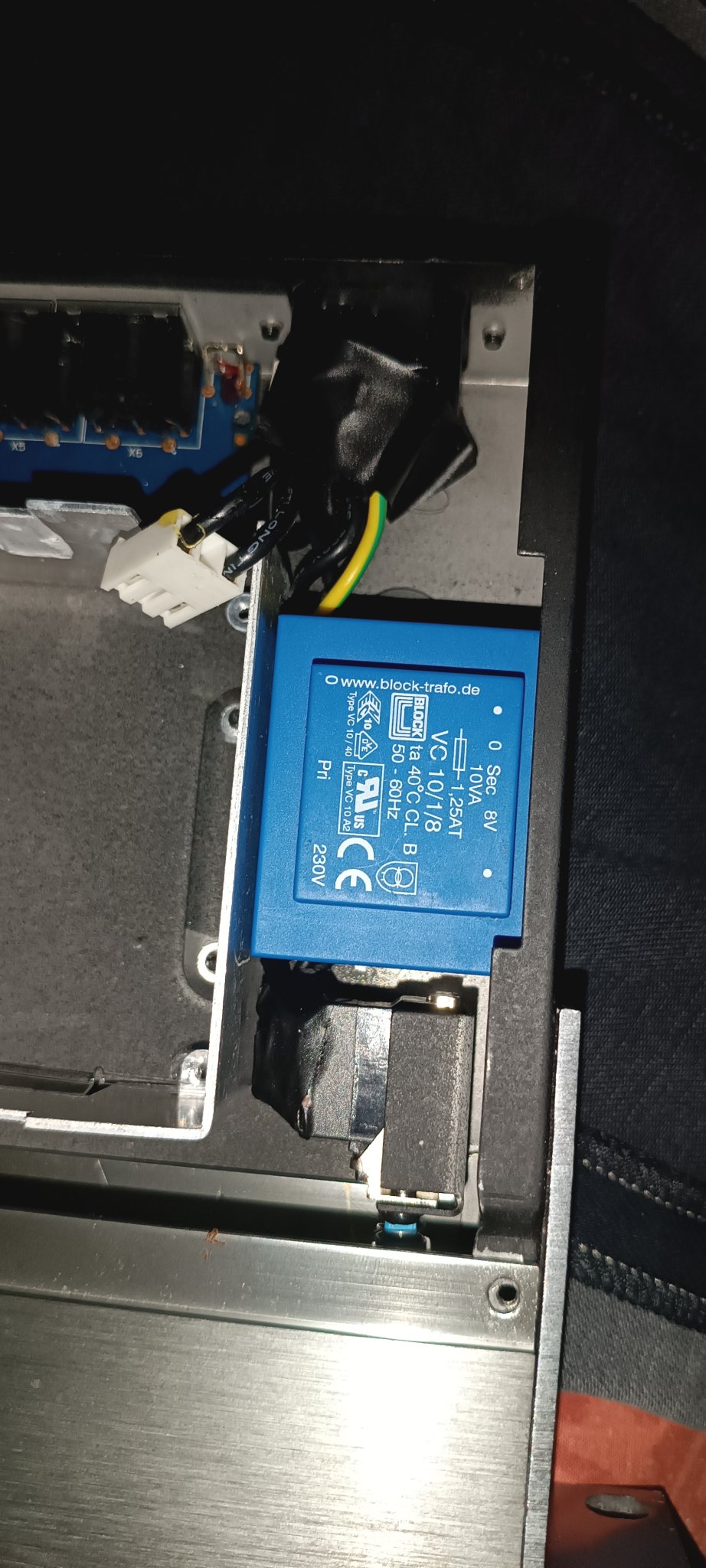

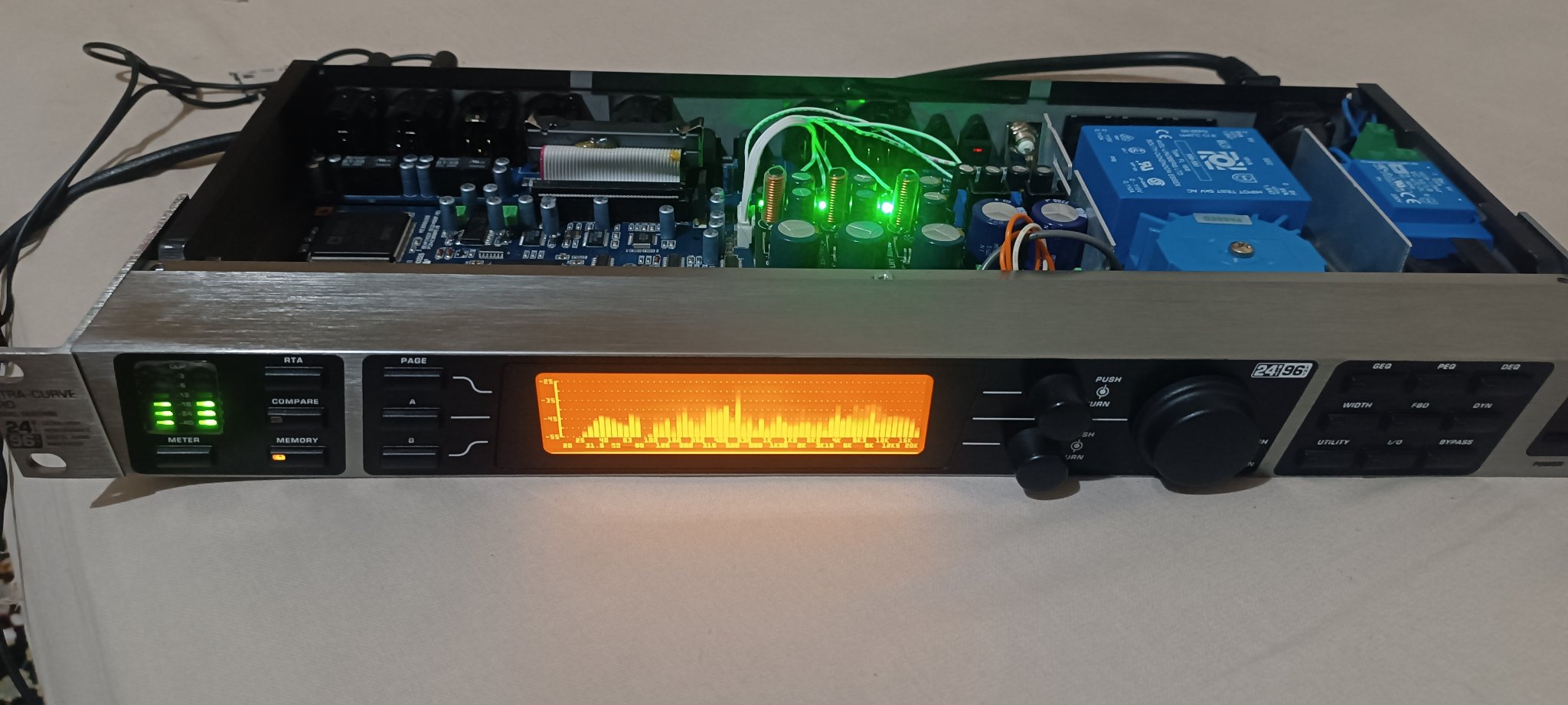

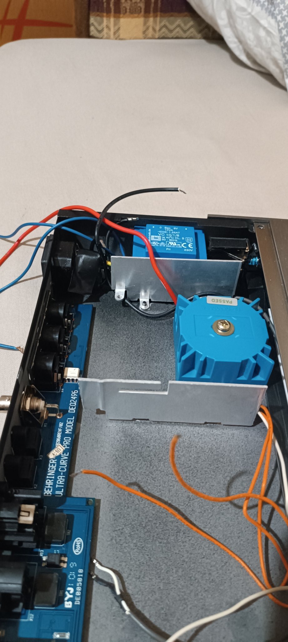

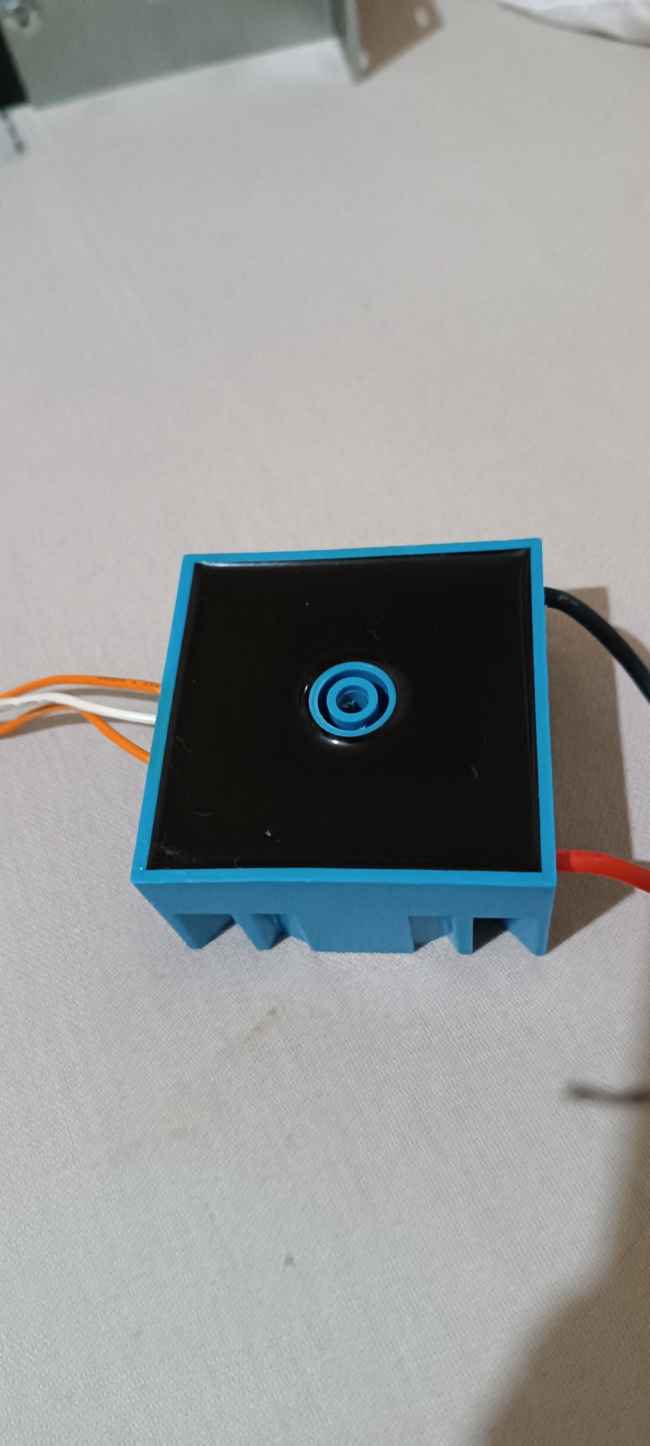

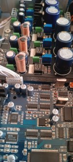

I have made a few different supply circuits before, I always had heating problems for deq2496, now there is no heating problem in 3.3v and 5v regulators, it is very good. Average cost with transformers is 120 dollars. I used Panasonic FC series capacitors. I used Philips capacitors in the digital card.
