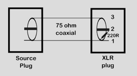

I made an RCA to XLR cable with a 220 ohm resistor between pin 1 and pin 3 of the XLR.
I was following the instructions in the article Using the Behringer DEQ2496 in a hi-fi system..
With this adapter, when I play an audio test CD with numerous test tones and sweeps that are supposedly at - 10 dBFS, the meter on the DEQ shows ~ -27 dBFS. This repeats consistently as does the levels from loudest parts of "Dark side of the moon".
My question, is the 220 ohm resistor the best choice, or can I increase the gain with a different value.

I made the cable shown in the attachment.
But, I simply used a good quality RCA to RCA cable, cut in half with the XLR and resistor soldered on the cut end.
The instructions in the article I referenced in the first post say it is important to use 75 ohm cable.
I wonder if RCA to RCA cables are made with 75 ohm cable?

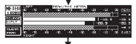

The meter I am referencing on the DEQ is the one in the second attachment.
Set for source = input and hold peak reading.
This reads around -7 dBFS maximum when left on through a movie.(using Toslink)
But it reads - 27 dBFS with a -10 dB test tone from my CD (using homemade RCA to XLR cable).

How can I measure the digital output level of my DVD/CD player?
Am I using the correct cable to hook the RCA digital output to the AES/EBU balanced input on the DEQ2496?
Should I expect the level to be -17dBFS?

FWIW, I have not found the 220R resistor necessary. And RCA connector isn't all that close to 75 ohms, anyway.

Pano is correct. I don't think the 220 ohm resistor is necessary.
I think you (and the author of your link) is confused on the interfacing requirements for the DEQ. The 220 ohm resistor only "modifies" the loading resistance on the line from 120 ohm to 75 ohm.......but it doesn't change digital (encoded) signal level.
The actual signal level (the level you'd see on an oscilloscope if monitoring) can vary quite a bit and still be recognized as valid by the DEQ2496. But it won't change the displayed signal levels you're seeing on the DEQ meters, since those are representative of encoded signal levels.

So, if I understand this correctly, the digital signal level is a matter of digital information and the actual voltage of that signal only has to be high enough for the DSP and DAC to receive and decode.
I have an "Audio test CD & reference tones, sweep disc" with 50 or so frequencies recorded (supposedly) at either -10 dBFS or 0 dBFS.
If I see 17 dB less signal at the DEQ's meters, then the disc represents as it's true level, then either the test disc or more likely the CD player has some digital headroom built in.
I think I can give the DEQ up to 15 dB of gain on a specific input, if so then all I need to do is add some gain there if I decide it is even an issue.
It does not sound bad at all, so maybe -17 dB does not represent that many bits.
