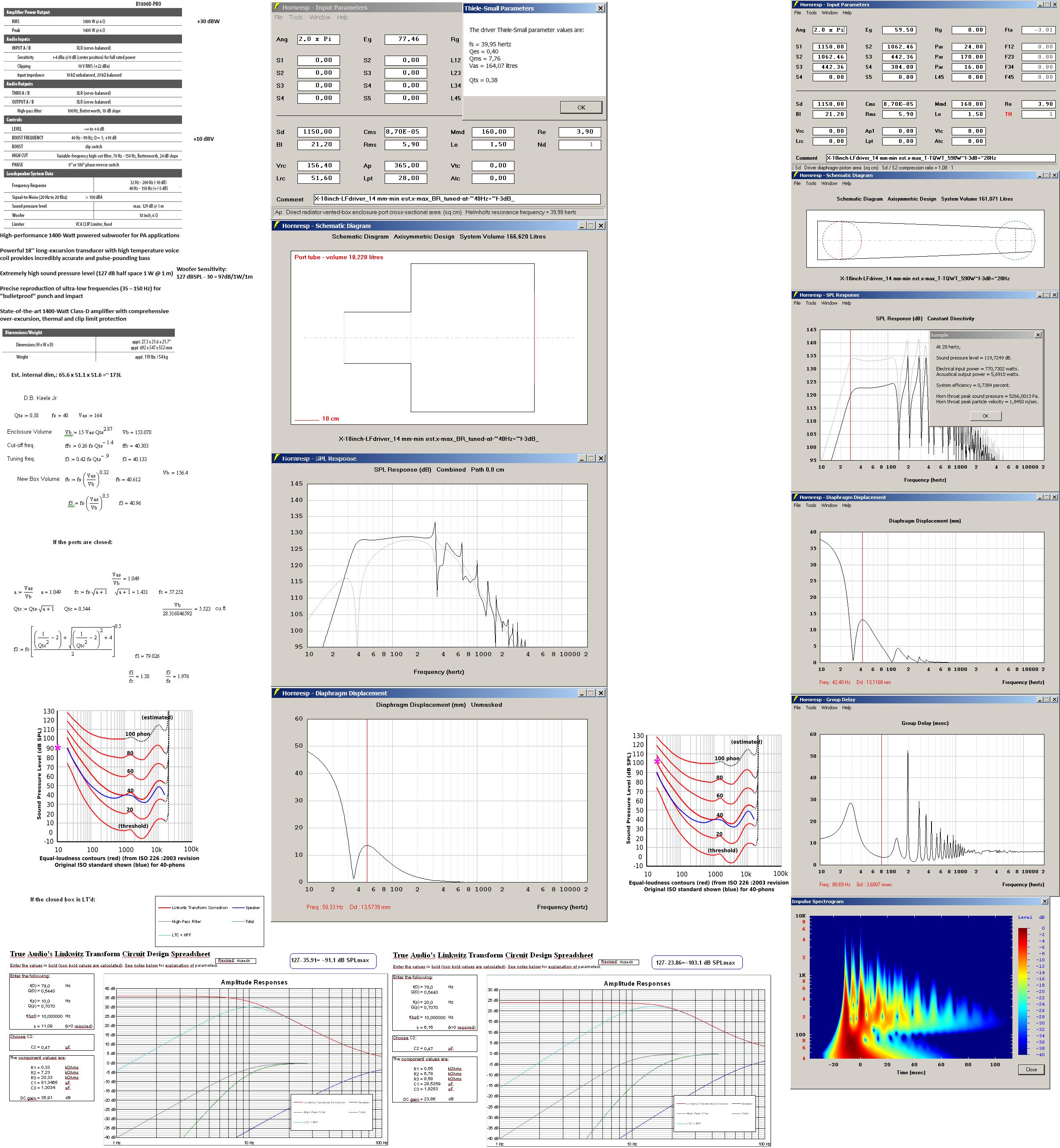

Invented by reverse engineering a 18" fictive PA driver (calculated for similar performance) that IMO would be comparable with the driver in the Behringer box.
Result: Targeting 10 Hz is not a good idea but 20 Hz is possible if a loss of 24 dB is tolerable from the 127....I would choose the T-TQWT. 😀

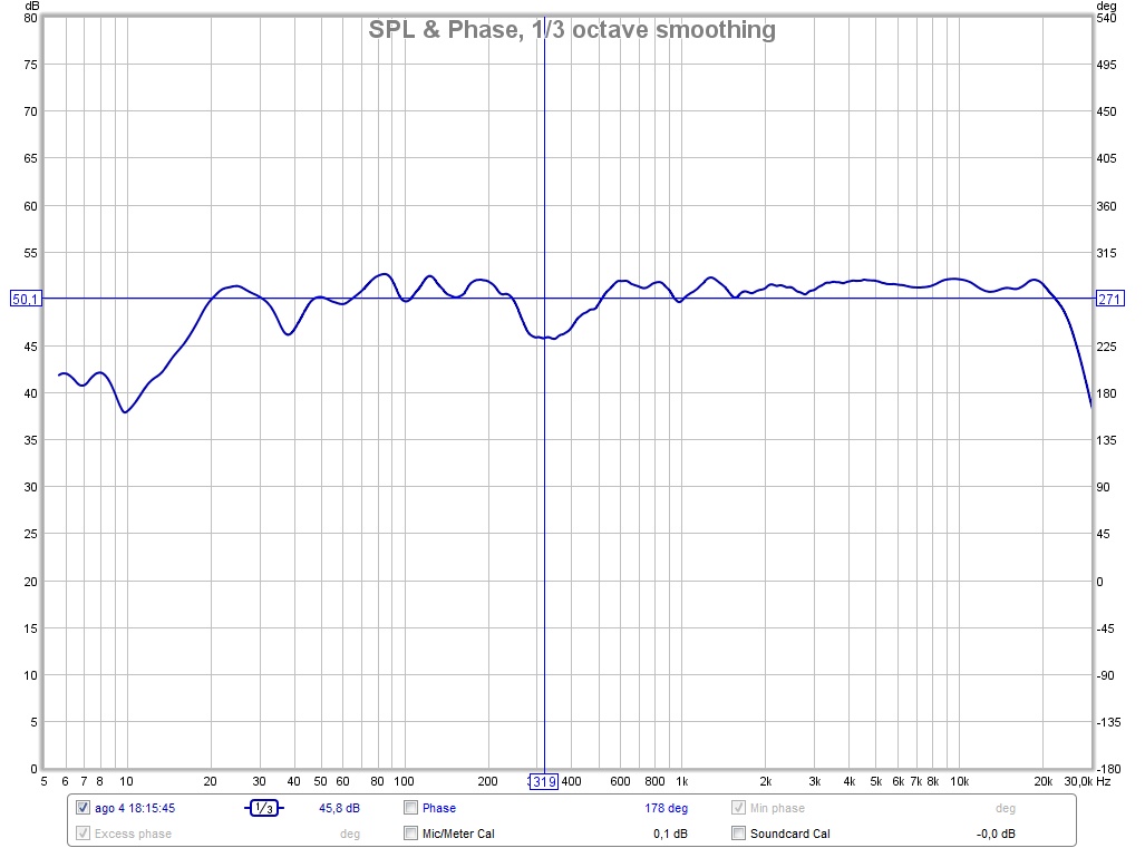

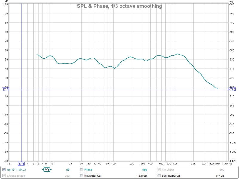

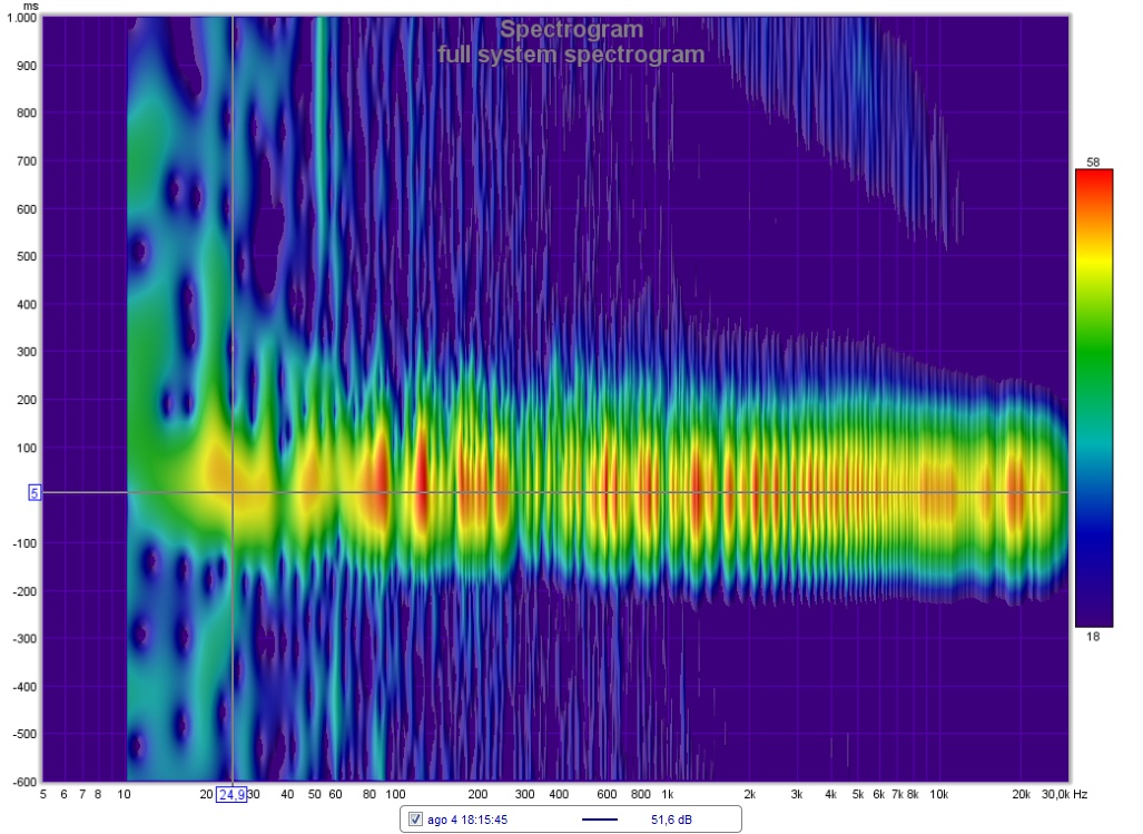

Hello,
as I state in one of my early post, I already got the 10Hz flatness, while actully I am just looking on how to optimize the result.
Here below the frequency response of the Sub + Woofer response of my system at the listening point (sorry to not be able to provide you a complete response up to 25 kHz... I am on vacation and in my notebook I have only this)
Actually, my focus is on optimize the linearity of this response and on the optimization of the Sub equalization that, due to the Behringer's limitations I explained in my post, is very heavy and surely is not the best from the acoustic quality point of "view".

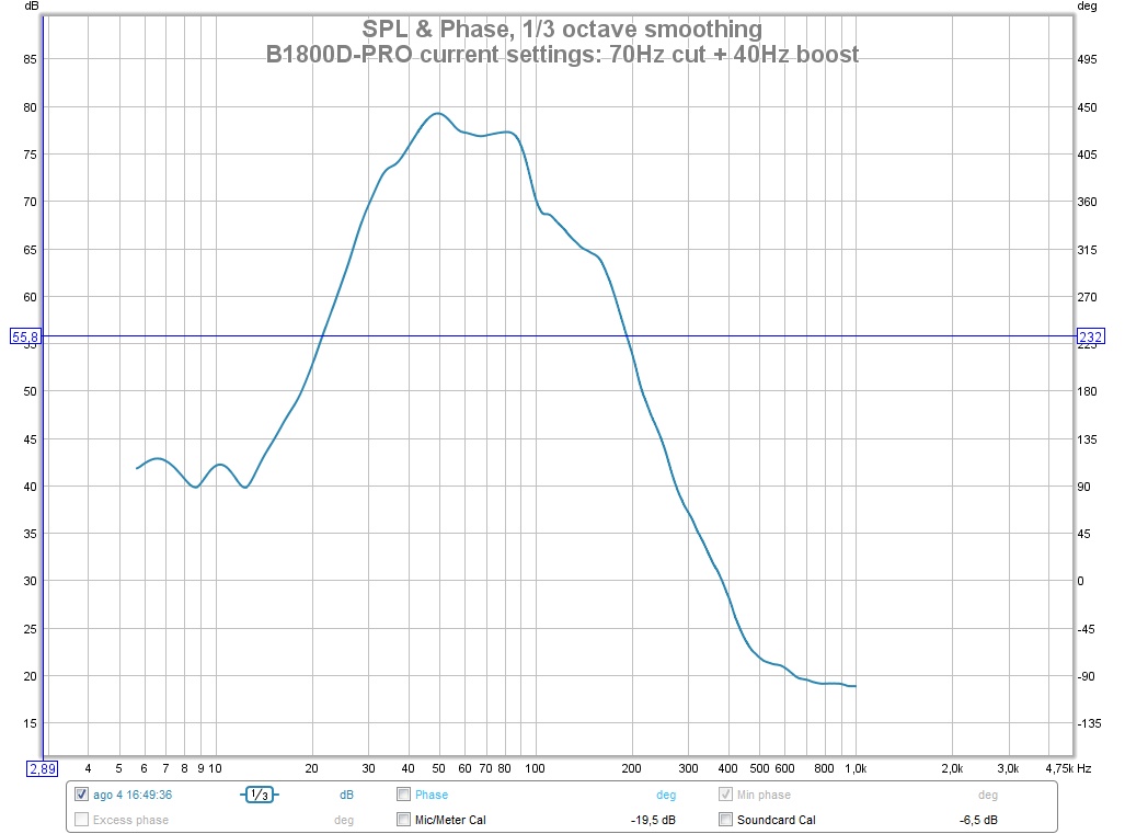

Behringer B1800D-PRO current setting performance
Hello Friends,
to let you better understand my current audio system "problems", and so better help me fix those, herein are some graphs you may "enjoy".
My sub frequency response at my LP (about 3m away).
Behringer B1800D-PRO setting as follows:
LPH cut: 70Hz
Boost: Enabled at 40 Hz
Volume: default 0 dB level
(No further DSP correction applied)
My audio system overall performace.
Thuneau 3way XOver with filters optimization
Strong (hard) 20Hz EQ correction applied (about +40dB) to the sub response in order to flattern its response.
As you can see, the overall system performance is quite good, except below 30Hz that I don't like at all.
For the small issue around 340Hz I am working on the XOver filters.
For the "big" problems below 80Hz I need your help.
Many thanks in advance for anyone suggestions and help!

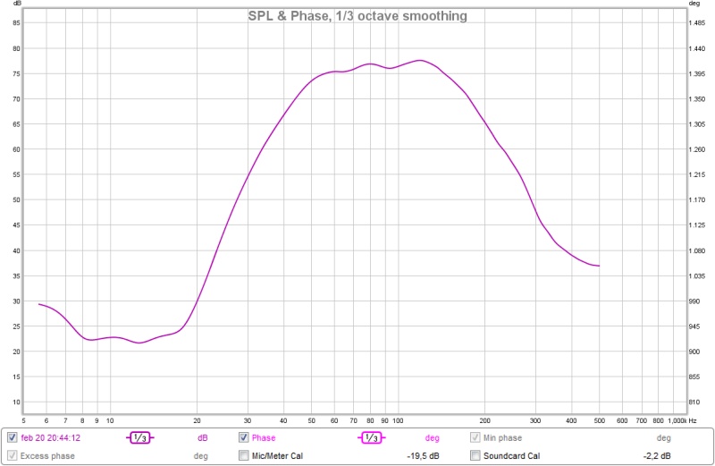

Hi Randomlf, the own response of my B1800D-PRO (no romm eq) is shown in the first graph of my post #27).
That graph refers to the specified settings (70Hz cut + 40Hz Boost), anyway, even the 120Hz cut + NO Boost is very similar, just shift right 50Hz the slope and reduce 5..7dB the 20Hz level.
This unit has an embedded class-D ampli that you cannot bypass, so some own eq is anyway present.
I also evaluated the VP1800, it is quite similar, except that is passive and that is an older design.
Then I selected the B1800D-PRO because of the active design (otherwise I had to buy another ampli too) and of its recent design.
Regards, Andrea
