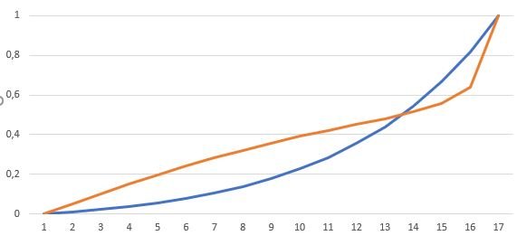

I read of some distortion issues for different position of the input attenuators
Looking at the part of the circuit
i see a strange R71 and surprisingly a pot value bigger than the input impedance at the opamp
I always thought that the pot value should be lower of the following stage input impedance
Can i eliminate R71 at least ? i dont like it at all

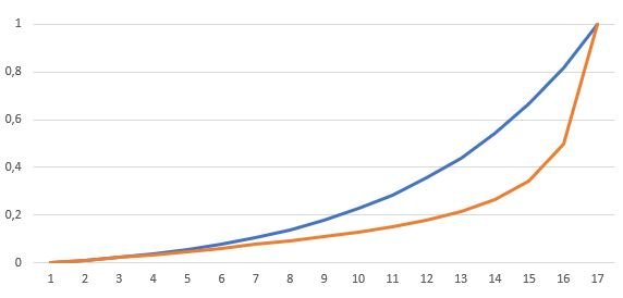

Oh yes you can do it, and R66 in other channel. Then you'll have the volume regulation curve (orange) like this:I will cut that R71 resistor for sure
Very gentle in the beginning, very steep at last 25%. If you are using volume pots in two positions (0% - 100%) then it's fine.
Technically you can, but this will cost you DC offset on the output (and some noise).Moreover I wonder if I can increase the opamp input impedance increasing R72 value
I see the DC offset could be compensated by adjusting VR6/VR4 (and VR5) but... this is for those who know how to repair power amp.
Hi thanks again Exactly ! the pots are really cheapOh yes you can do it, and R66 in other channel. Then you'll have the volume regulation curve (orange) like this:
