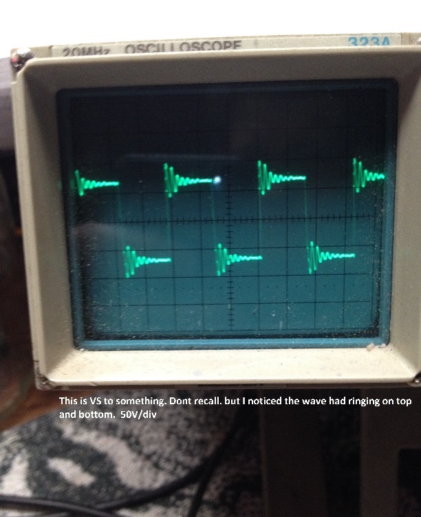

Do you know about the VS voltage ?? I find it somewhat strange that it runs at +10V... So my -B to VS is like 85 V and +B to VS is 65 V..
This is with or without a load.. I could see a volt maybe but I don't get why its so high.. maybe it doesn't matter.

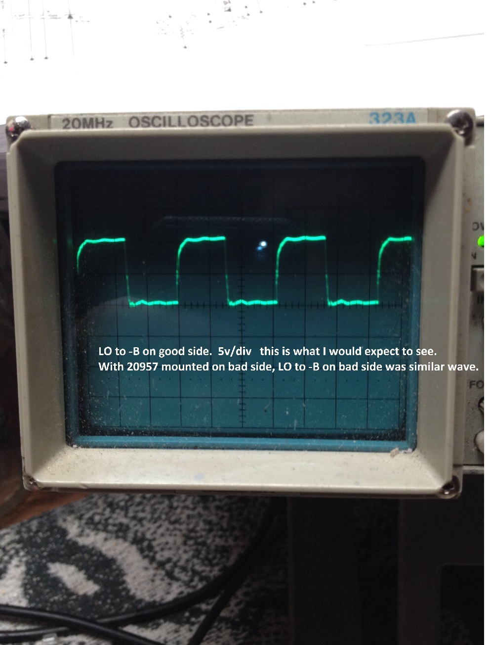

if the low side (outstage) dont work or is not present as in this case, high wont work, have you checked the low side output ? PIN 10 (L-drive) there should be signal on that pin, but not on H-PIN

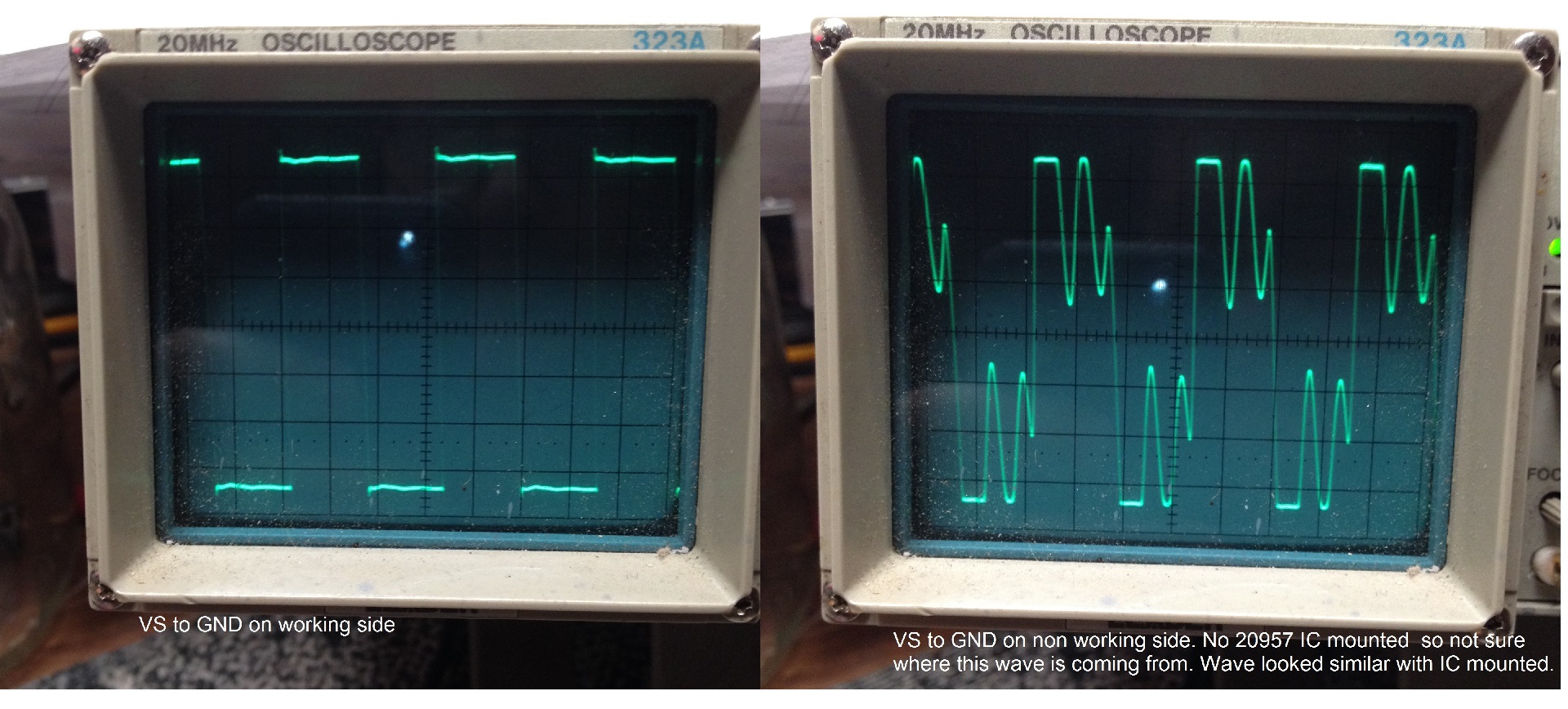

5) power up unit. ( no load) Power light comes on.. and I can see Protect light come on that off.. then on. .then off.. I can see Voltage at Pin 2 cycle between 2.5 and 7.5 as expected. At that time I was looking at VS and seemed like I could see it going positive to +B.. on one side , and only about half of +B on the other.. so possibly thingking back that side may be the problem.. anyway..
6) did some poking around and testing and voltage checking and at some point took out the FETS on the other side.
7) replaced all 4 FETS and both 20957's Power up.. No OC cycle.. but no oscillation.. either.. Poking around found that the H04 IC ( last before inputs to 20957) seemed bad. Weird voltages and resistances.. more checking.. and at some point the FETS shorted again.
8) Replaced the H04 IC now with a Sine wave in.. I get a square wave out of the H04..To Both 20957's ( My thinking was that possibly this ic went bad in the first place and started all this as it has to feed the square wave into both 20957's One obviously the invert of the other.) Replaced the 20957s and Fets again.. No clip led.. but I still see the OC cycle going on.. This time when I look at VS i don't really see it switching and can maybe see some pulse at LO on the one side ( my scope just triggers for a brief moment in sync with the OC cycle) nothing on the HO .. on the other side.. i don't seem to see anything at LO or HO.. more poking around. FETS burn out again.. That's were im at... LOL...
seems like The 20957s are fine if I don't have any Fets in.. They will sit there and the OC protect cycle. I assume that with out FETS the OC will cycle because VS is just sitting at 9V and it should be going to -B or + B.. so to the IC that would look like Vds is +B or -B.. So I think I have to have FETS in.. I think I have multiple issues.. idk.. I don't think this should be so damn hard to figure out.. LOL..
anyway.. I think when I poke around with power on .. it is maybe causing the FETS to go.. idk.. they don't go right away.. it just OC cycles. I'm just missing something basic I think.. over thinking it...

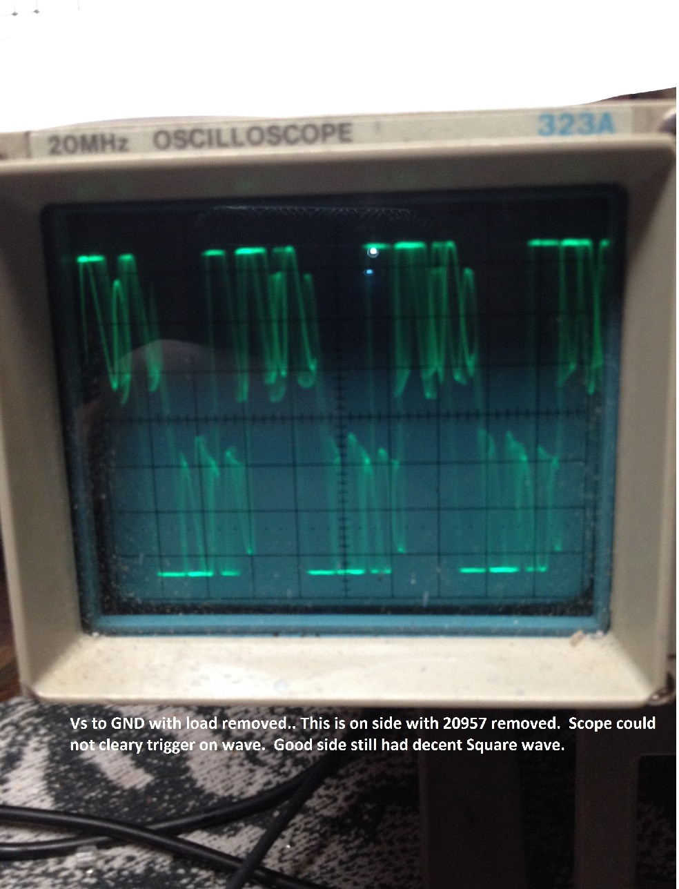

The 20957 will go into protect with no mosfets in. The IC will look for a over voltage across the lower mosfet and will find one.
What I did see once that threw me was a none shorted mosfet DS that was shorted GS.
I also learned not to replace mosfets without replacing irs2092 or more often than not everything would fry again.

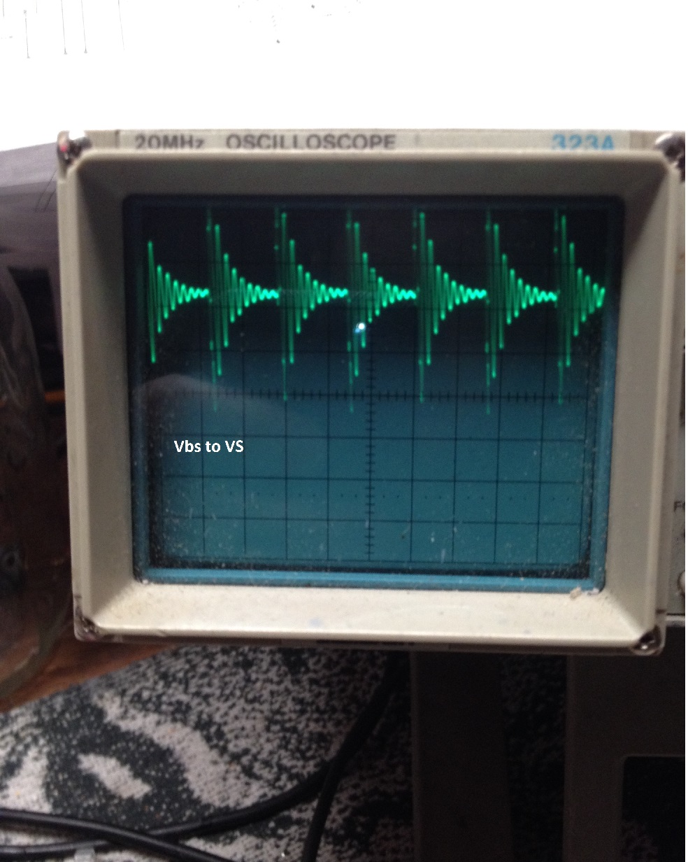

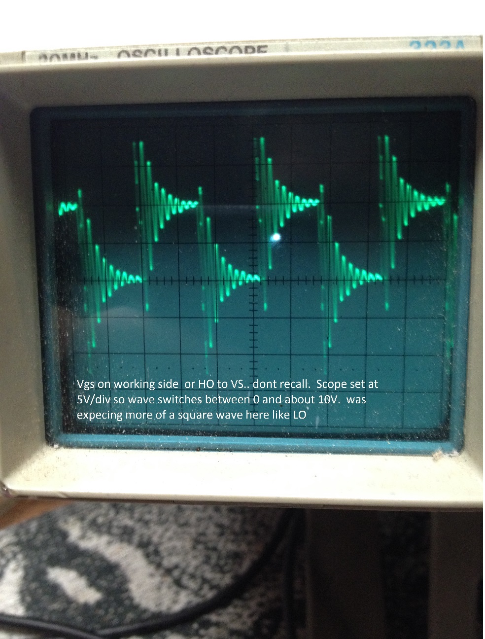

One more thing.. the High side will have Boot strap even if the Lo side doesn't work because there is a precharge resistor .. R 14 and R 15.. What I don't get is why do you even need the Boot strap Diode and resistor if you have R14 and R15 to charge it before the LO side turns on.. idk..
maybe I should pull them out for trouble shooting.. LOL.. then Vbs cant charge for sure until the LO side turns on.. ??? just a thought.. might help figure out what it going on.. what you think??
I am very familiar with a IR2010 I can simulate bootstrapping by supplying -VCC charging up the cap and get both output L-OUT AND H-OUT to signal (with load resistors on both to simulate RC gate charge) this works fine for me. You can probably do this for the 20957 as well (trick it as well) you just need to read the datasheet until you understand it , the app notes I linked would have given you this trick for free, you didn't read it enough times, I spend a full day reading those datasheets and a week doing mock demos. 😀

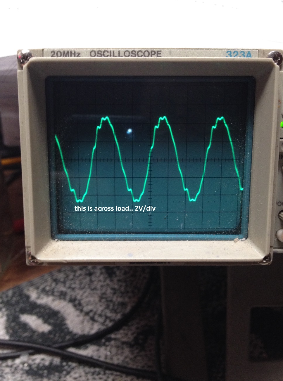

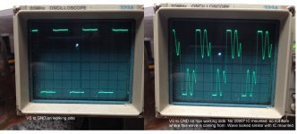

Hi Guys.. Well. some update... I added the Light bulbs for current limit. Haven't seen them flicker yet..LOL.. I replaced the FETS again and the 20957 ic's I also basically went thru the whole layout of the amp vs this schematic I found and it is basically identical except for a few variations in resistor values and such.. and mine doesn't have some of the additional circuits on the output. It only has the limit circuit that feeds back to the Optical Resistor.. Anyway. After firing it up.. IT still goes into OC cycle.. Boo. But I can see some wave forms now and I can see One side looks like square wave at VS and other looks like crap. I pulled the 20957 ic off from the side that looks like crap.. and found that the other side now stays on and oscillates.. So.. One side seems ok.. the other is not. Since I was able to now keep it on .. I took some pics of some of the wave forms I'm getting.. My LO seem to look like I would expect.. But my HO is not what I was expecting.. yet. I seem to get a good square wave at the VS.. anyway.. I will post.. If someone that has more experience with this can take a look and tell me if what Im getting is expected I would appreciate it.. I will try to label them so it is clear what were looking at.. Thank again for your help.. I think I'm close.. just missing something..
Here are some wave forms.. While the amp was OC cycling, I could see these waves for a moment before it cycled. I noted the Bad side had a strange looking wave. When I removed the 20957 on the bad side. Then the good side was stable and I could capture these.. I noticed the Bad side still as the same weird looking wave. I assume the good side is feeding back thru something causeing this?? But if so.. then I wonder why same wave was there when it was OC cycling.. anyway.. Not sure 100% what I should be seeing at H0 to VS or Vgs.. seem like I should get square wave but you can see what I was getting. Thanks.. again.
Sorry here are the waves I also included the Schematic again for reference.. Page 2 is the amp section
