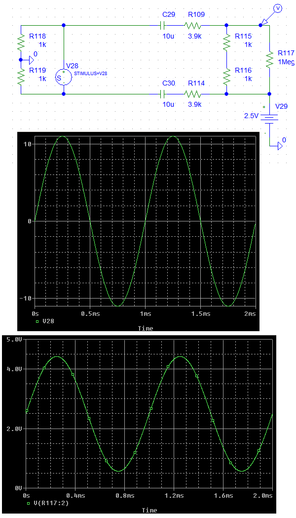

Behriger umc204hd maximum input voltage
7.74Vrms. So 11V peak, so probably using standard +/-15V opamp circuitry.
Not that we should care, but.....
It is USB powered (the bigger 404 has wart option). While they could jack that to +/-15V, the ADC is probably low-volt, so why? Put an 11/2.4 pad in front to keep big inputs in range of a 5V ADC. Padding-down is the easiest thing in audio.
Behriger umc204hd https://media63.music-group.com/media/sys_master/he1/hdc/8849614274590.pdf
Sample audio ADC: http://www.ti.com/lit/ds/symlink/pcm1802.pdf
It "must" accept input from standard +/-15V studio gear. It doesn't have to use that level internally.
Another clue: the output is rated +3dBu! 1.55V peak! 3.1V p-p! Which strongly implies a 5V opamp.
(Yes, there is a "48V phantom", but deriving this from 5V USB is easier than deriving the whole shebang from USB.)
Here's a too-simple (no CMRR) pad to turn +/-11V inputs into 0.6V to 4.4V output for a 5V ADC.
EDIT-- the ADC chip I linked actually likes 3Vpp input not 3.8V. So pad a little more.
