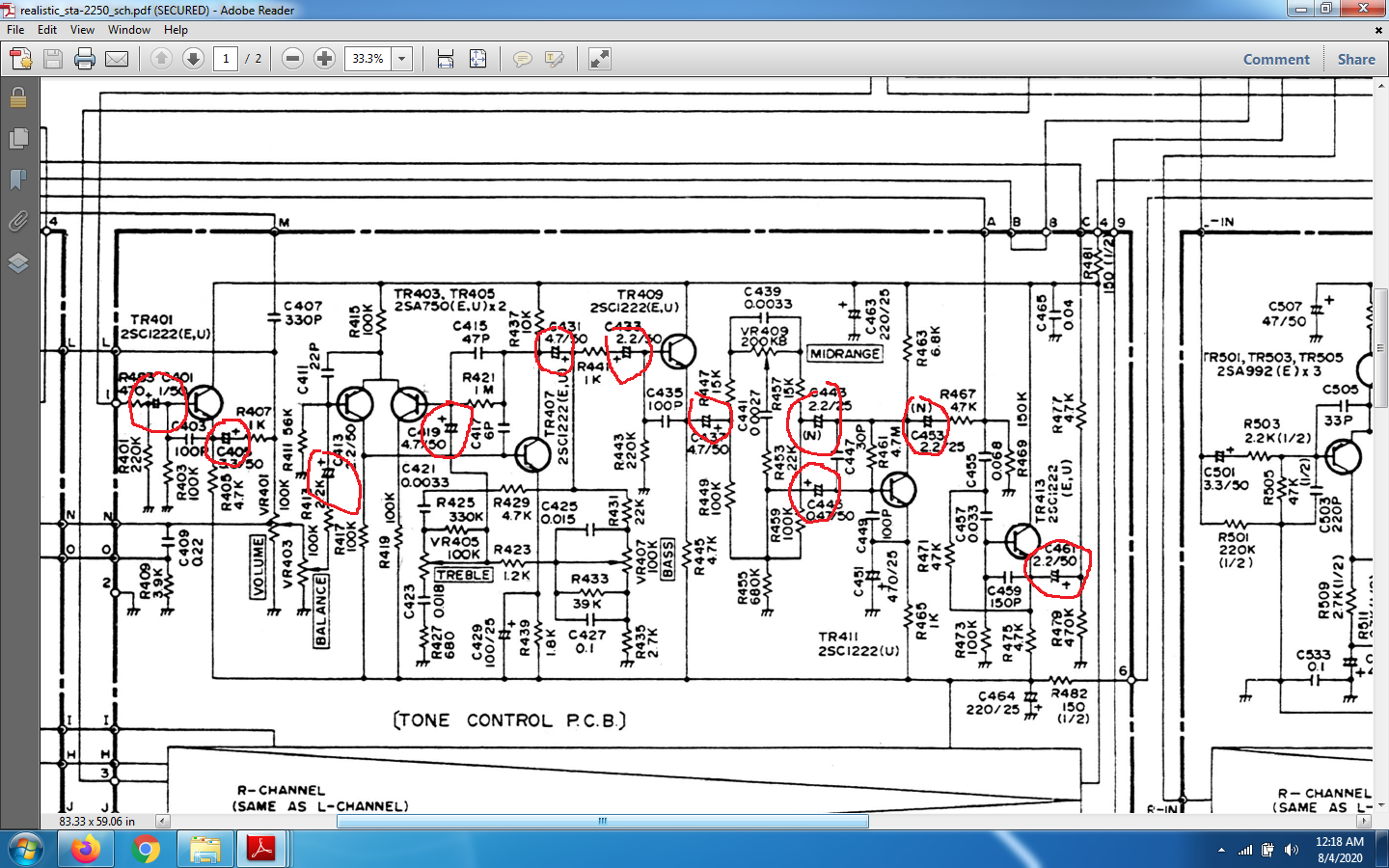

Behold the circuit that destroyed my preconception on capacitor induced distortions
Account Closed
Joined 2010
It happened 10 years ago when i made a mod to my newly refurbished Realistic STA 2250 .Although the power amp was completely up to date-nichicon muse, ultra low noise and high ft transistors, the eq had way too many electrolitic capacitors in the signal path, actually 11(eleven) 40 years old capacitor , so before changing them i thought of rewiring the tape- monitor switches to be able to bypass the entire tone stack.After doing so and leveling the input output signals, my complete and utter surprise was that i wasn't able to hear anything wrong with the tone eq in.There was somewhat of a different sound, but the differences weren't in favour of removing the tone stack...they were completely irrelevant, like 0.5... 1db out of tune circuit, but nothing to criticise .From that point on to these days i simply disregarded any claim of a better sound due to dc coupling.

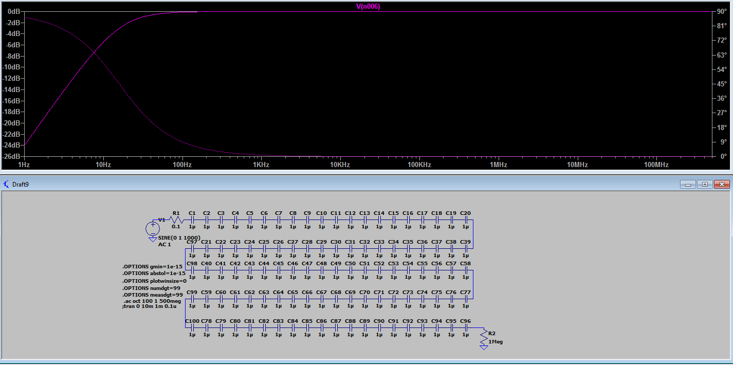

True, but I mean for example, take a low impedance output preamplifier, and a high impedance input power amplifier, choose an electrolytic (or other) capacitor value so that they have no effect on bandwidth, and then how many would you need.
Could I replace a 2 meter length of cable between the two with a string of 50 capacitors and not hear a difference...
if you have 0.1 ohm output Z preamp to 10 megohms amp input impedance you can probably place 2 meters of series 1uf capacitors and barely be able to hear differences... but i'd look to have very low dc voltage specifications on very low tan losses capacitors too like fkp1 63v caps if possible cause the thicker the dielectric the higher the losses.The other problem is the noise you pick with 2 meter of capacitors...

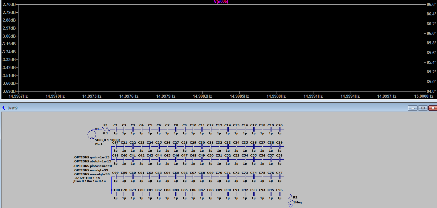

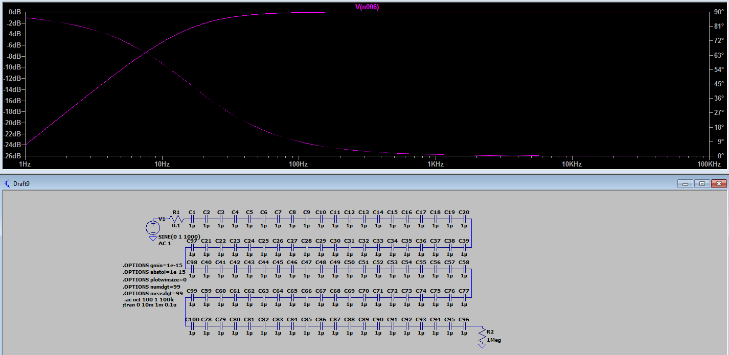

Actually there's be some low frequency drop off, lets say 100 caps in series, so 10nF
into 1M load, -3dB at 15Hz. 50 capacitors and this would be less, and the voltages across
each capacitor are in the milli- to micro-volt region so typical non-linearities would be too low to measure.
Some snakeoil seller is designing a capacitor-string interconnect as we speak !!
"Some snakeoil seller is designing a capacitor-string interconnect as we speak !!"
They even made the simulation for it . It looks like 100 caps in series are the best subsonic filter for the most exquisite phono preamp already 🙂

There was somewhat of a different sound, but the differences weren't in favour of removing the tone stack...they were completely irrelevant, like 0.5... 1db out of tune circuit...
The above statement appears self-contradictory. That fact that you actually heard a difference seems potentially quite relevant.
