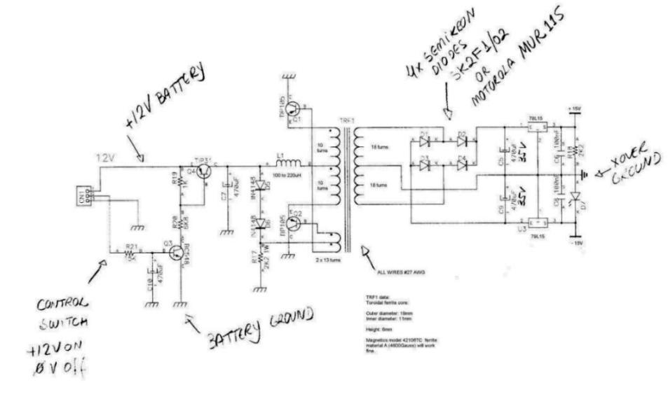

davesaudio said:any chance we could see EVA's schematic?
Do you mean the schematic for that small unregulated SMPS?
Sorry, I have no schematic, I laid out that board from memory and then I tuned up component values. Anyway, the layout is rather self explaining and you also have component values so you can easily draw your own schematic.
