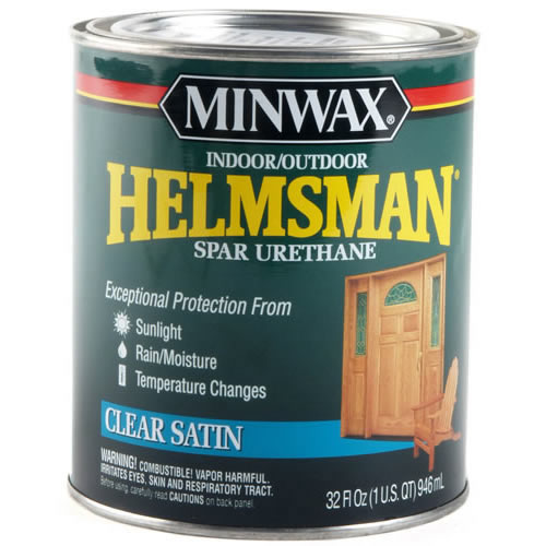

Coating?...
Hello cyberspyder, It would appear your standards are high, nice work! I wanted to suggest a coating that you may want to experiment with(buy a small can). I have enjoyed the appearence of Spar Urethane. It adds a slight amber color, so keep that in mind. It offers a very durable, UV resistant finish. I like to apply 3-4 light coats(sanding between coats even better) using thinned material for the first. The finish is very deep and with a well defined grain(even without between coat sanding). I prefer the Spar over the standard Urethane, as the UV inhibitors will help prevent washing of the finish should either of your speakers get exposed to much sunlight. Something to think about.
-discreteouts
PS Home Depot sells this.
-discreteouts
