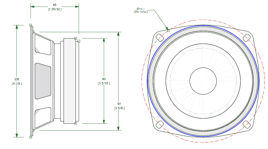

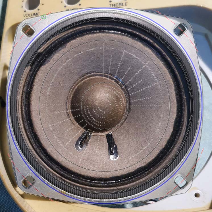

Hole size is 104mm (~4.1''). Diagonal distance between the screws is 115mm (~4.5'')
The classic FE103 basket has tha hole circle, but the large hole size (the blue circle in the picture) would make it hard to seal.
Are you sure 104mm is the cut-out size? The pre-2K FE103 looks to be very close to your driver — manipulating your picture to line up as best i can.
Here are the dimensions (magnet varies alot across iterations).
dave
My calipers put the circular hole at 103.7mm, not to put too fine a point on it 😉
That's the hole in the box. There's actually a bit of wiggle room for the speaker, which is really asking for a 101mm hole.
That 3/10mm might be enuff to get a good seal with the right gasket tape.
