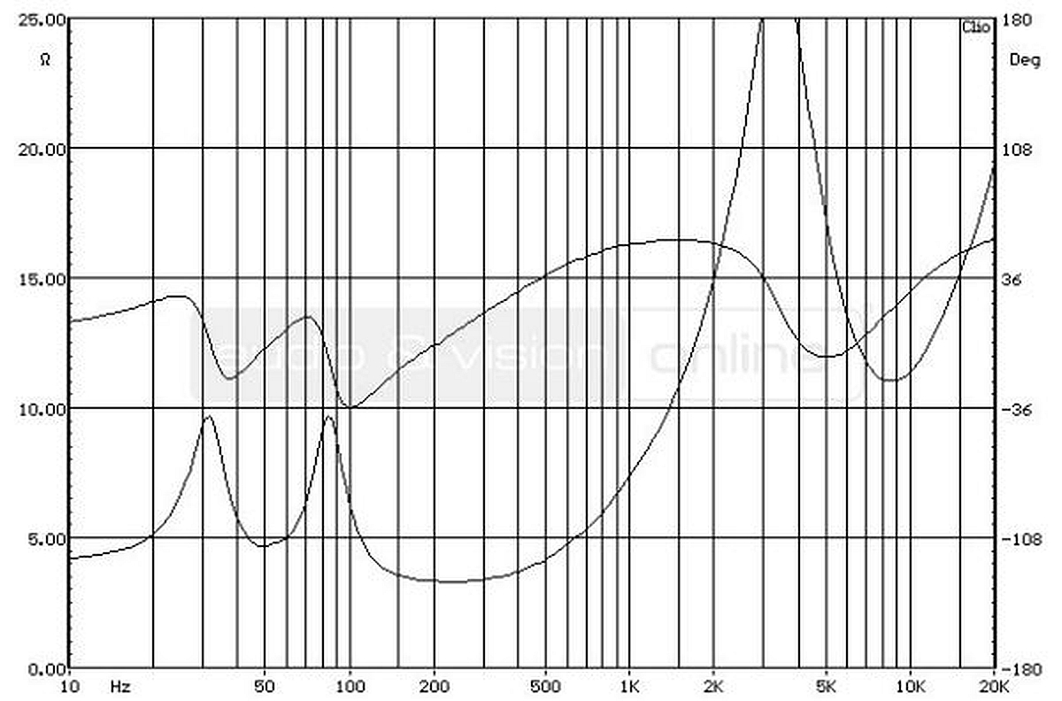

Thanks to DöG forum Audiodiyers forum, I got the impedance curve of my speaker. And It's right, 8Ω nominal impedance in the reality 4Ω with 3.2Ω minimum.I checked the spec's for the speakers and found them to be incomplete. 🙁 Nothing was provided about the impedance curve. If those speakers have dips in the curve, especially in the power hungry bass region, the sensitivity has to be derated. Dips down to 4 Ω require derating to 86 dB.
