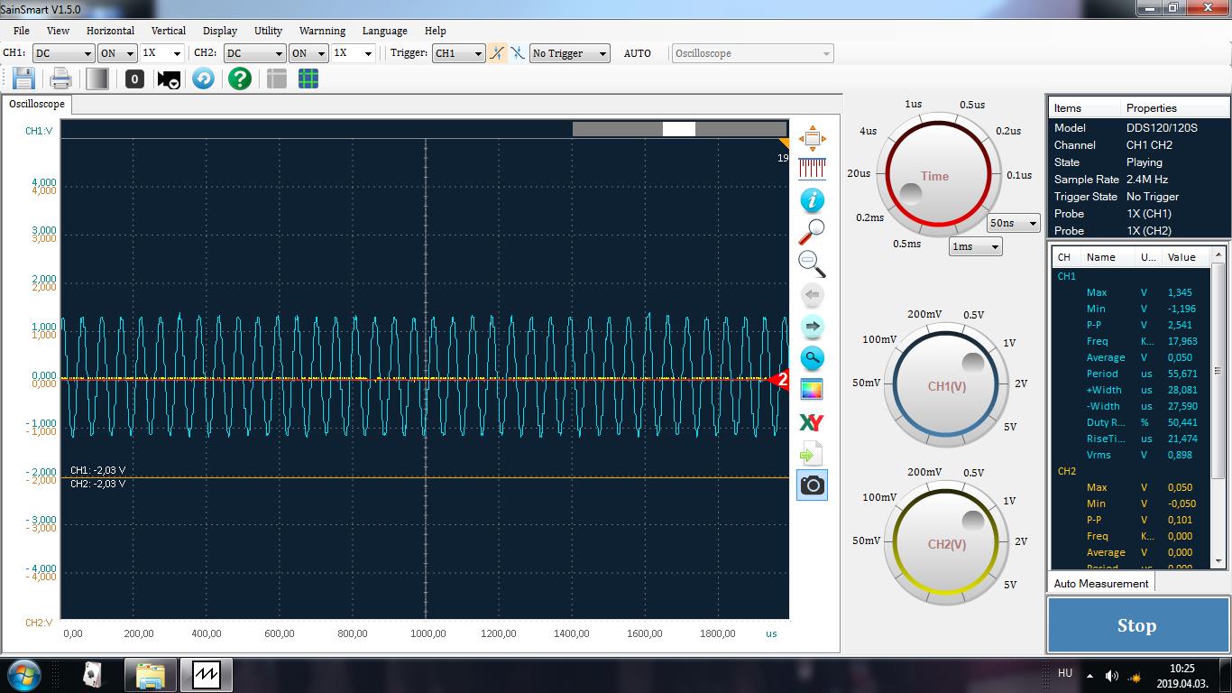

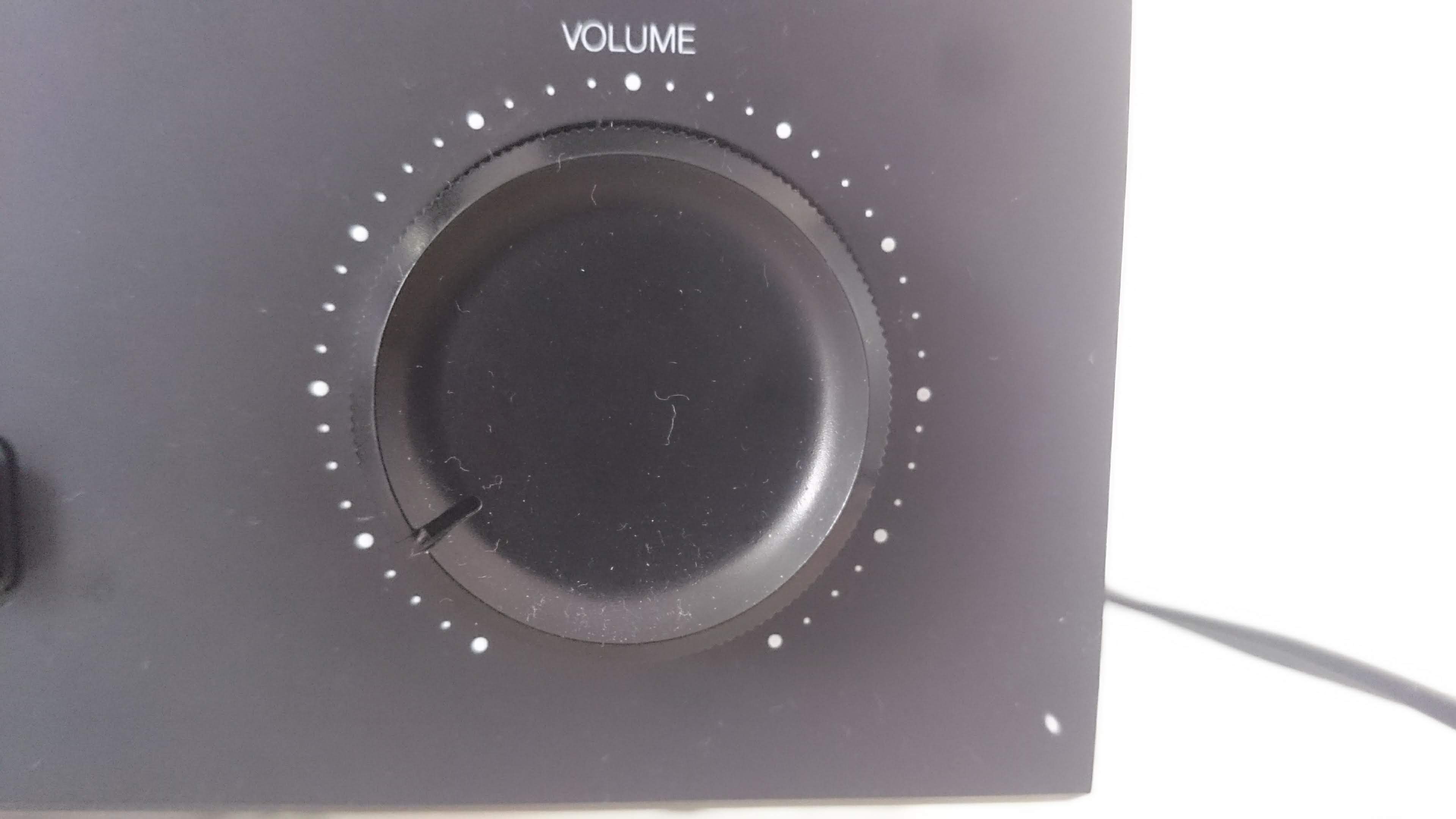

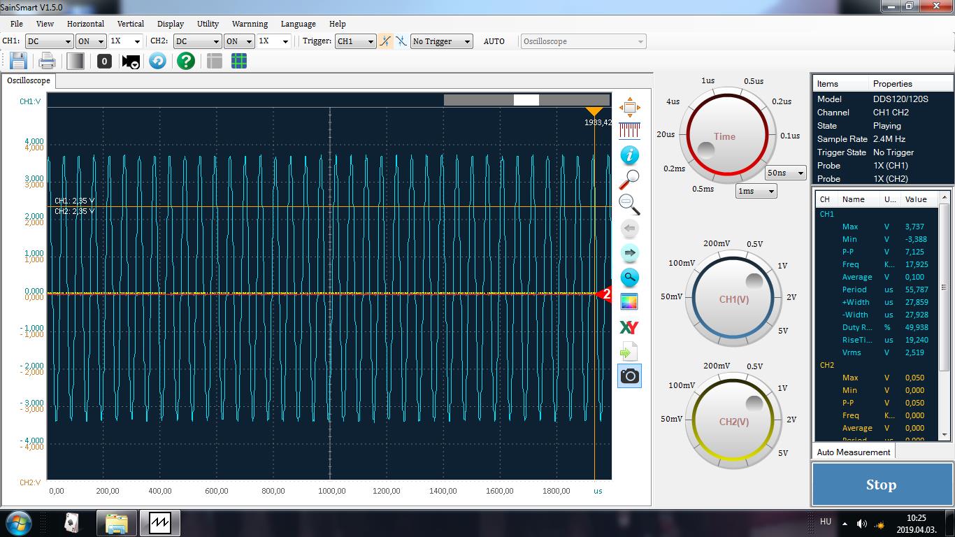

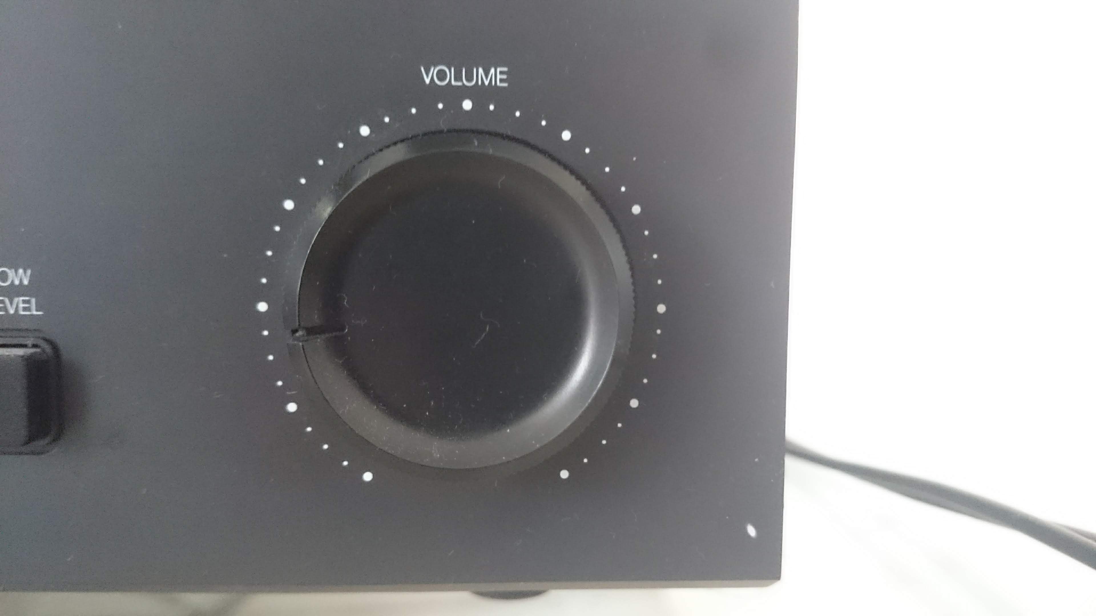

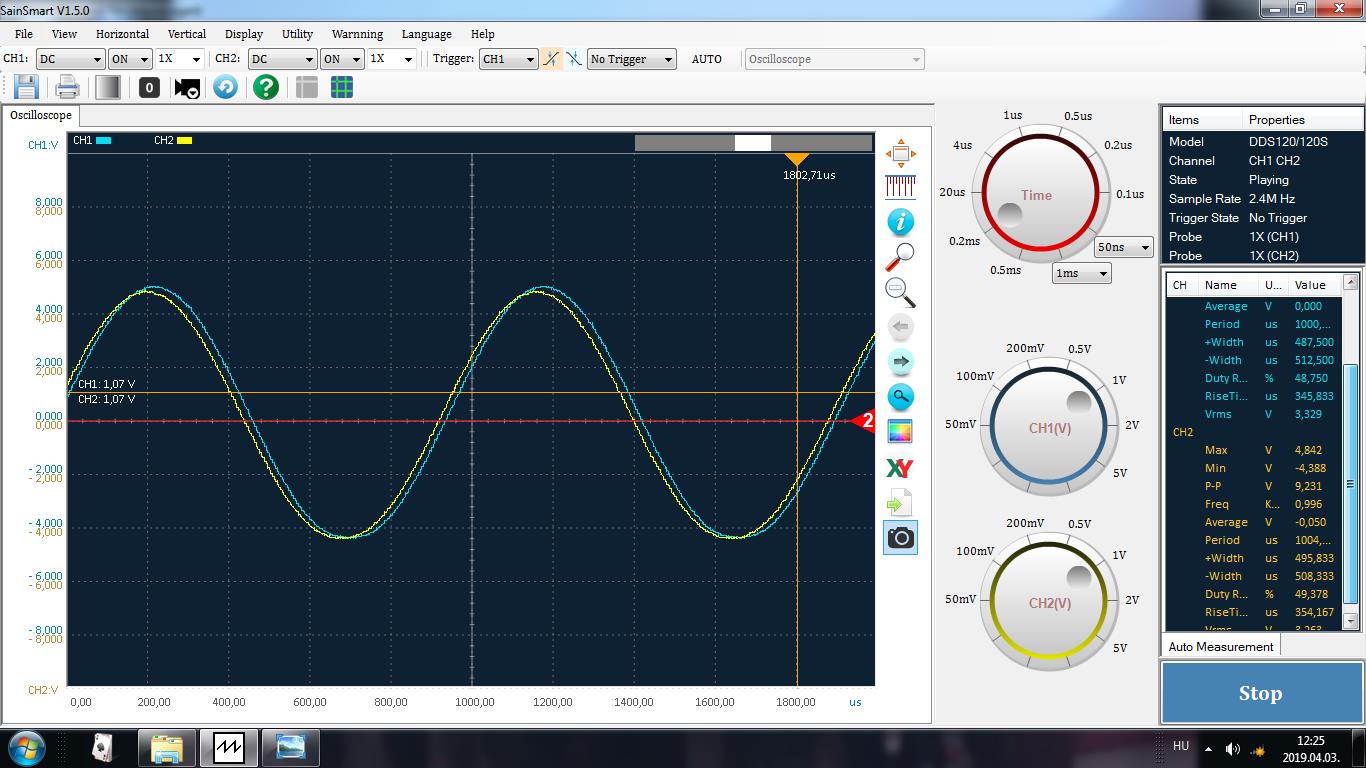

I did the measurement with 7.5Ohm power resistor. I've attached the measurements. The test signal was 1kHz, and I did two measurement: Max, meaning the volume level, usually It is too load for me and maybe for the Negihbours too🙂 The normal is the normal listening level.
- The RMS voltage at the Max 3.3V at the normal level it is 1.2V RMS. If I calculate the Power (VRms*VRms/R) At the max level it's 1.45W At the normal level its 0.18W??
I also measured the speaker with a multimeter and I've measure 4Ohm. The nominal impedance is 8Ohm.
- I also did the measurement with this setup, (the scope was connected parallel with the speaker) the Normal level RMS is 0.9V and the calculated power (0.9*0.9/4) is 0.2W, with the Max level the RMS is 2.5V the calculated power (2.5*2.5/4) is 1.56W.
Based on the measurements, I think 3WPC will be enough for me. What do you think?
