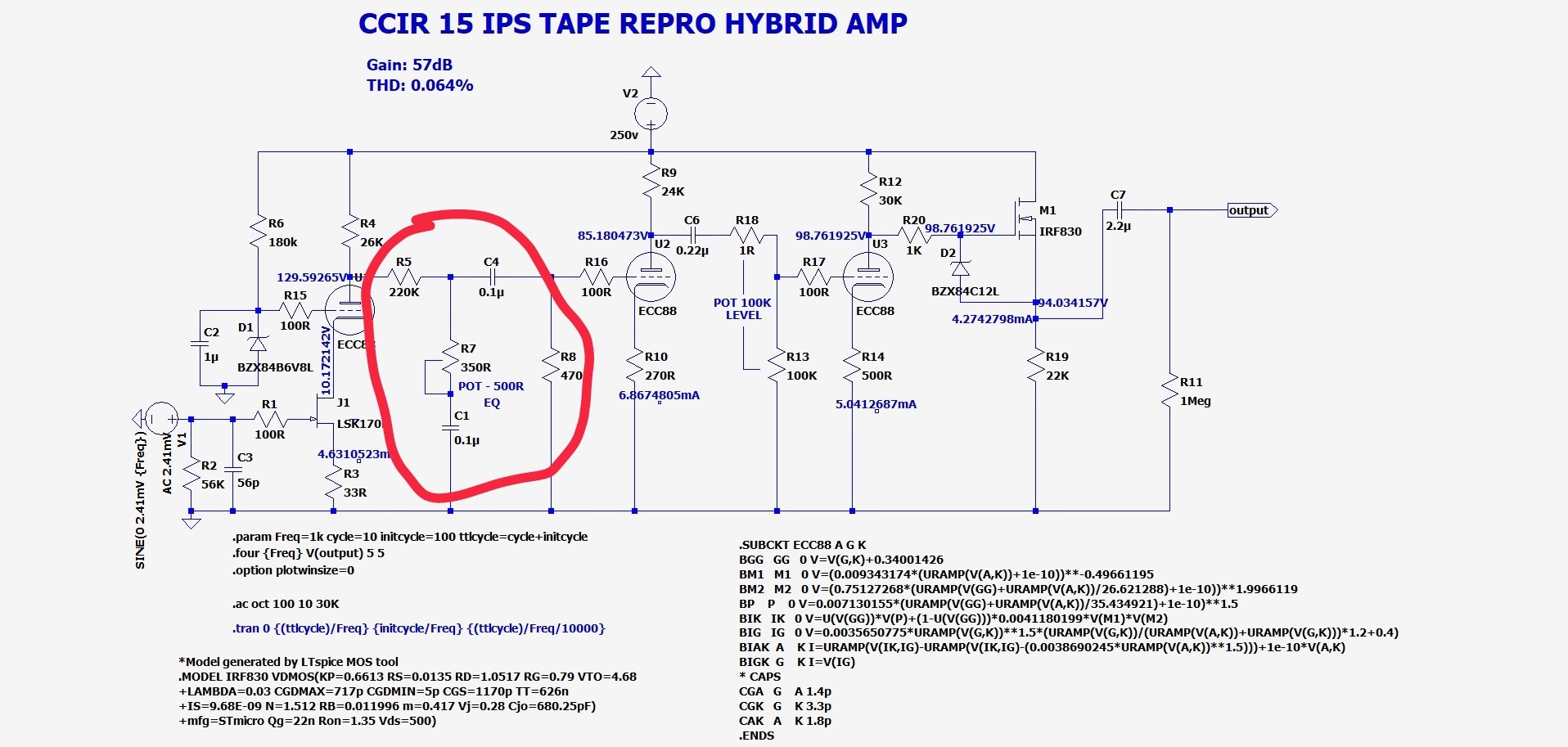

To everyone who is planning to test the repro amplifier. After performing more simulations, I found that values marked in below pictures are critical and cannot be changed. Please proceed with caution, as the design is not 100% verified.

One more thing to mention, picked up by another member, is that cathode resistor bypass capacitors (100uF/16V) on PCB are not to be installed, unless you have low gain from tape head and you have measuring equipment. If you install them you might get clipping. The repro amp was designed with input of 2.5mV or so.
