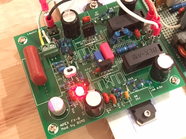

I design simple discrete amplifier with +-25VDC PSU. According to who built it, it better than ordinary non-inverting LM1875 amplifier.
Even relative simple discrete amplifier that design properly can have lower THD, higher slew rate, better S/N ratio than chip amp and it can have harmonic profile that you want.
+1 - Bimo can really design a nice simple amp. My FX8 Bimo mod is fantastic.
The choice of transistors really made a difference in brining up the SQ another level.
I hear an AX11 Bimo edition is forthcoming...
