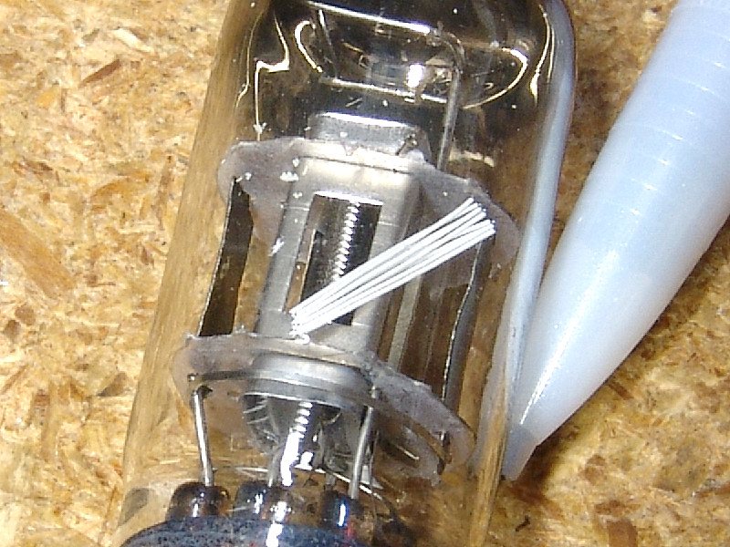

In my 50+ years of making things with tubes I have seen two small signal tubes where the grid shorted to the plate.
One was a loose tube that had been banged around in a box for an untold number of years. It was toast when I plugged it into a DIY guitar amp resulting in a fried plate load resistor. The grid had cone completely loose inside the tube and had shorted to both the plate and cathode. This lesson taught me to use 1 or 2 watt plate load resistors. It just makes the amp more reliable when something unusual happens. More common than a shorted tube......An expert "amp modder" sticking the wrong tube in the socket! Yes, I have found an EL84 stuck in a 12AX7 socket.
The second was also in a guitar amp head that did sit on top of the speaker cabinet. It would emit a loud pop every once in a while after being on for some time. I had tried to fix it several times, but could not duplicate the problem on the bench. One day the owner brought me the amp saying that it had finally died. One of the 12AX7's was dead and replacing it restored operation with no further pops. Autopsy on the dead 12AX7 revealed several malformed grid wires and a few that were broken loose from the support rod. It was made that way. I have seen some poorly made tubes in my days, but what are the odds of finding TWO like this! Yes, a spare heater was included in each tube in case one burned out.......no word on just how to change it.
It would seem that an input tube shorted from grid to plate could fry the volume pot in the guitar, or make it become noisy from DC running through it.
"Could", but not for-sure.
Take 300V, 100K plate, 100K pot. We get 1.5mA so 150V so 0.225 Watts. Such pots are usually rated 0.25W. So hot, but not sudden death.
Similar path-tracing for part-volume and 5K pickup shunt lead to smaller heat. Worst case could be 0.050W in less than 20% of the total pot element, which gets us to rating.
Yes, it would crackle real bad.
If YOU have seen this twice, I don't think I will live long enough to run into it.

And I'll probably never see it again since I don't fix amps any more, but I do collect cheap tubes in cardboard boxes at hamfests if they are cheap enough. Still the odds are slim.
Correction: it would not crackle. P-G1 short makes tube gain slim to none, probably dead-zero. So it crackles but you can't hear it.
The effects of DC current through a pot wiper, especially the old carbon on phenolic versions are often permanent. There will be tiny pits of "deadness" that cause noisy or erratic operation even once the DC is gone. Sometimes this can be fixed with a pencil, but it won't last long.
I found this out many years ago when I really didn't know what I wad doing. I have no experience on modern conductive plastic versions, but I imagine that they could be fried with enough current.
