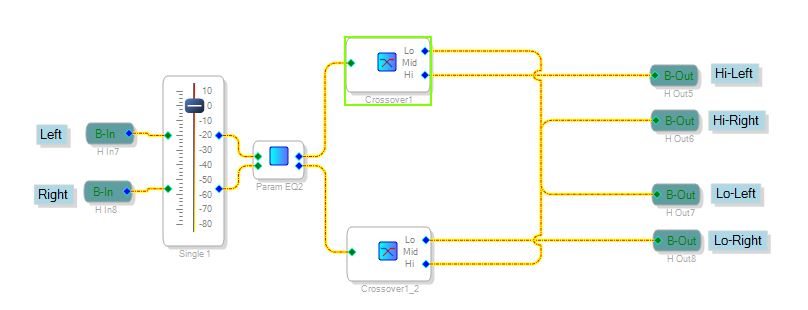

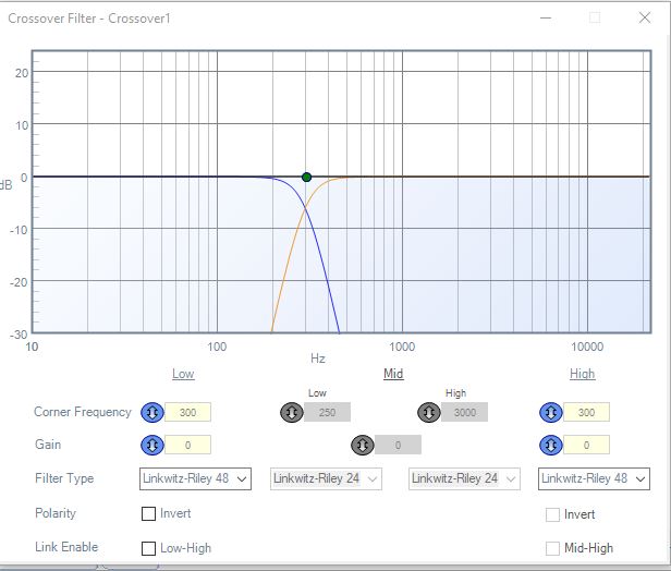

Do you know that for a three way speaker you’ll need to create and program a new SigmaStudio project? The 3e Audio DSP comes programmed with a 2.2 (two channel, two way) SigmaStudio project. 3e Audio provides the SigmaStudio source code on their website. I’ve attached their crossover schematic and crossover settings. Note that it uses only two way crossovers and that each crossover is set up the same: 4th order Linkwiz Riley at 300 Hz. There is no existing band passed output that would be needed for a mid in a three way. Perhaps you know all of this, but it wasn’t evident from your post.
I do believe I've read somewhere that it comes in a 2 way or 2.2 configuration.
I need to sit down with Sigma studio and learn a bit about it, lots of 'strange' symbols...
I have also just started to learn Vituixcad 2, and it seems to be able to produce files for DSP (if I didn't completely mistake what I read...
Anyhow, I need to do a lot of simultaneous reading and learning, but I tend to like that.
But as I'm facing this mountain, any guidance is always helpful, I don't expect anyone to carry me, just show me the path if you got the time.
