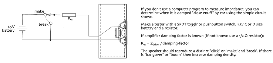

Regarding your Linton 2 renovation: Wharfedale used a minimal amount of damping material in my Denton 2 and Dovedale 3 speakers of the same era.
The optimum amount of damping material can be determined by the 'click test' described below:
