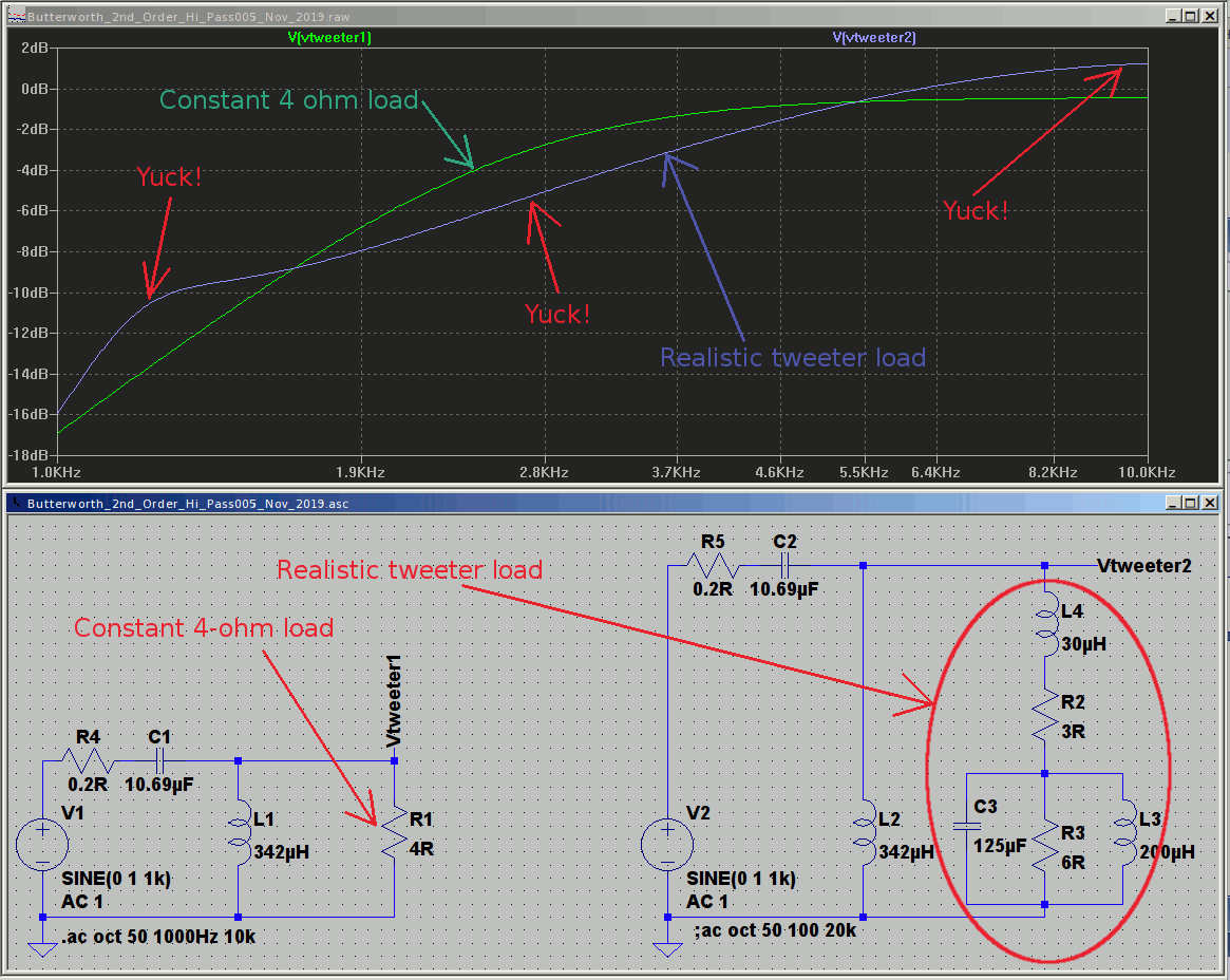

From memory, probably the worst problems occur because of the huge peak in the tweeters impedance at its fundamental resonance.Out of curiosity, just how bad is the sound quality of a speaker system with basic crossover design? How many dB, for instance, will the dips and peaks be in size?
By interacting with the high-pass filter in the crossover network, this impedance peak can really mess up the tweeter's actual frequency response curve. So this the first thing to correct.
Unfortunately, it's not the easiest thing to correct! You need a way to measure the impedance curve, for starters, then you have to calculate values of the L-C-R components in the impedance compensation network, then buy them, build the circuit, and re-measure to see if it worked. It doesn't always work exactly as predicted, so you may need to tweak the values of L or C or R. More money, more parts-buying, more time spent, more building and measurements. (It helps when you have a few parts bins full of an array of inductors, capacitors, and resistors right there at your fingertips!)

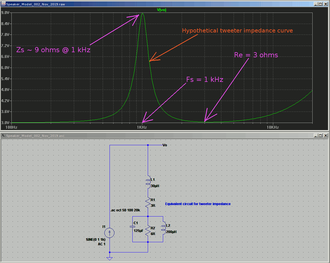

I wanted to give you a better answer than just hand-waving as I've done above, so I did a little simulation work in LTSpice. Imagine we have a 4 ohm tweeter with its fundamental mechanical resonance (Fs) at 1 kHz. We decide for various reasons to use a textbook second-order high-pass Butterworth filter with a nominal crossover frequency of 2 kHz (which is one octave above Fs.)
I looked up some sample tweeter impedance curves online, then used LTSpice to design and simulate an electrical circuit that more or less duplicates a typical tweeter impedance curve (image attached.)
Because I'm driving the network with a 1-amp constant current source, one ohm of impedance translates to 1 volt across the network. Therefore the Y-axis values can be read as impedance in ohms (though labelled as volts by LTSpice.)
This particular (hypothetical) tweeter has Rs = 3 ohms, voice coil inductance is 30uH, and the impedance peaks up to about 9 ohms at 1kHz, the mechanical resonance frequency of the speaker suspension. These are reasonably typical values.
In my next post, we'll look at what happens if we hook up this sort of an impedance to a textbook 2nd order Butterworth LC high pass filter.
-Gnobuddy
Next, I used LTSpice to simulate the frequency response of a 2nd-order LC high-pass network with a 2 kHz crossover frequency, operating into a perfectly constant textbook 4-ohm load. L & C values were calculated using an online crossover network calculator. I added 0.2 ohms to represent the resistance of the inductor itself as well as the loudspeaker cables running from the amplifier to the loudspeaker.
The result is shown as the green curve (Vtweeter1). There are no surprises - it has the characteristic smooth shape we expect from a textbook Butterworth high-pass response.
However, as you can see, I also simulated the frequency response of the same LC Butterworth filter, but loaded with our realistic tweeter impedance, which varies with frequency, unlike the constant 4-ohm load resistor.
The result is the purple curve (Vtweeter2). And just one glance is enough to show that it is UGLY! There are departures of up to +/-3 dB from the "textbook" green curve. The curve isn't smooth through the critical crossover region, with an ugly kink at the tweeter resonance frequency (1 kHz).
I don't have the time to do a similar simulation for the woofer and/or combined woofer/tweeter response. But it's easy to see that if the tweeter curve is bumpy and distorted by up to +/- 3dB, the composite woofer/tweeter curve certainly isn't going to be any better. (It will be worse, because the woofer response won't be perfect, either.)
Keep in mind, this is only half the story: we've only looked at the electrical signals at the driver terminals. What we really care about is the acoustic response of the driver, and we know that will be even worse than the bumpy purple line - because the tweeter has its own acoustical imperfections, as does the woofer.
