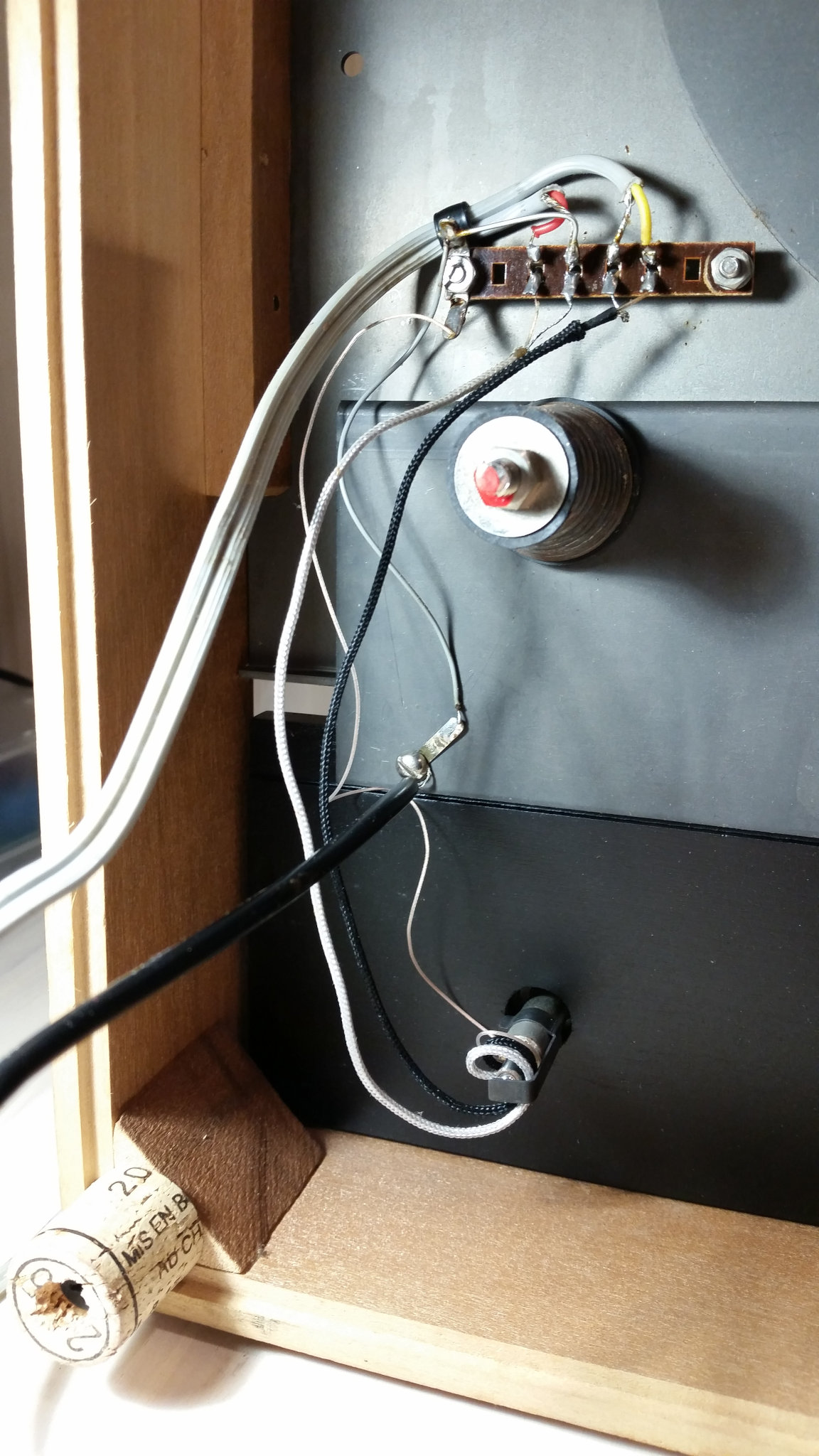

My cart ground runs from the arm to the chassis (stock Thorens TD1-150). I will try rerouting it to the Bugle's ground post and see what happens.
I haven't looked up what that wiring looks like, but you definitely want entirely separate left channel, right channel and ground connections here. Tonearm ground to chassis basically isn't bad but then chassis ground also needs to make its way to the phonopre.
I misstated, I am actually running a wire from the chassis connection to the Bugle's ground.

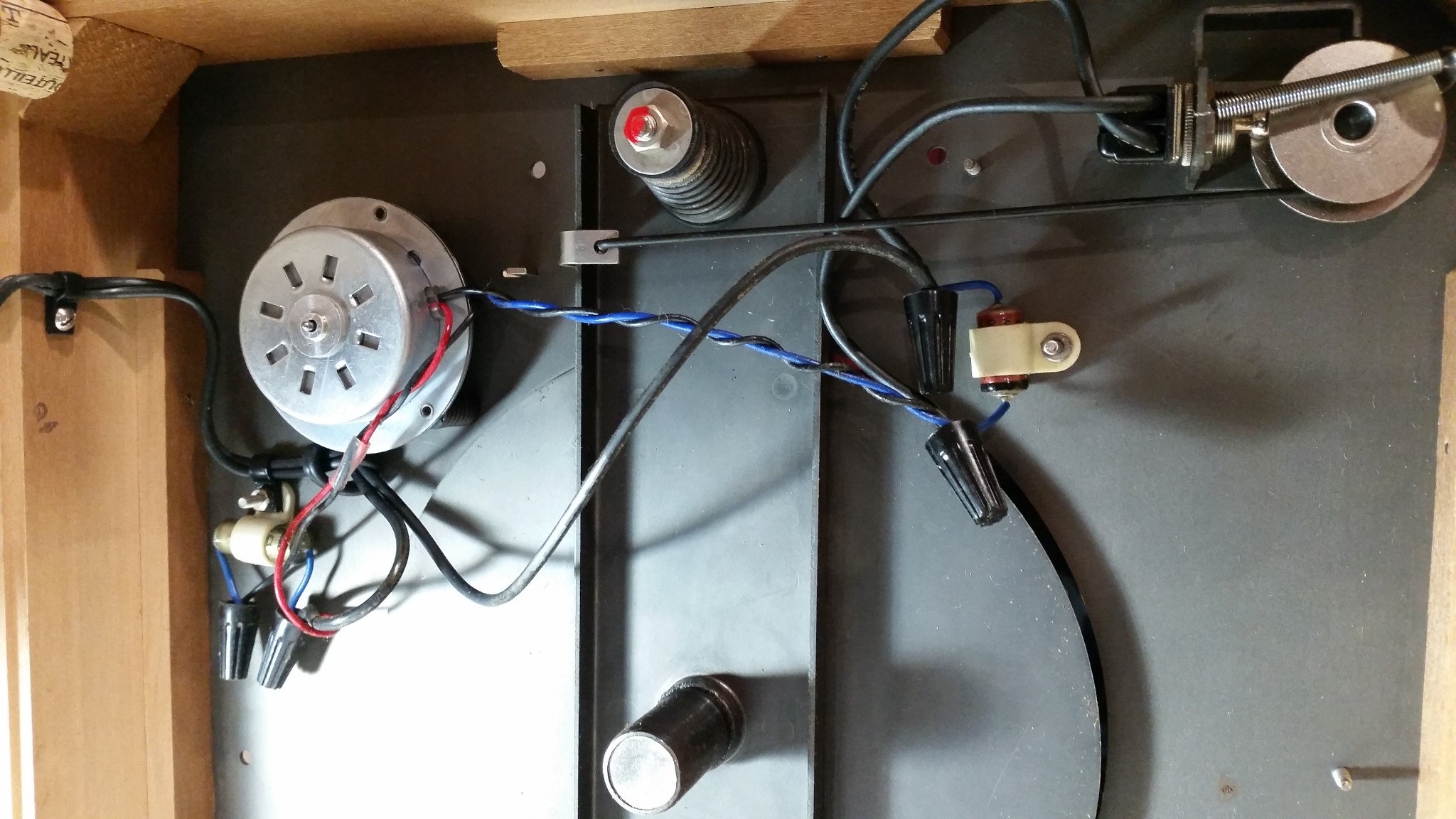

That clearly shouldn't be happening in a subchassis player, at least with the transport screws loose. The dampers and motor run capacitor may have seen better days.

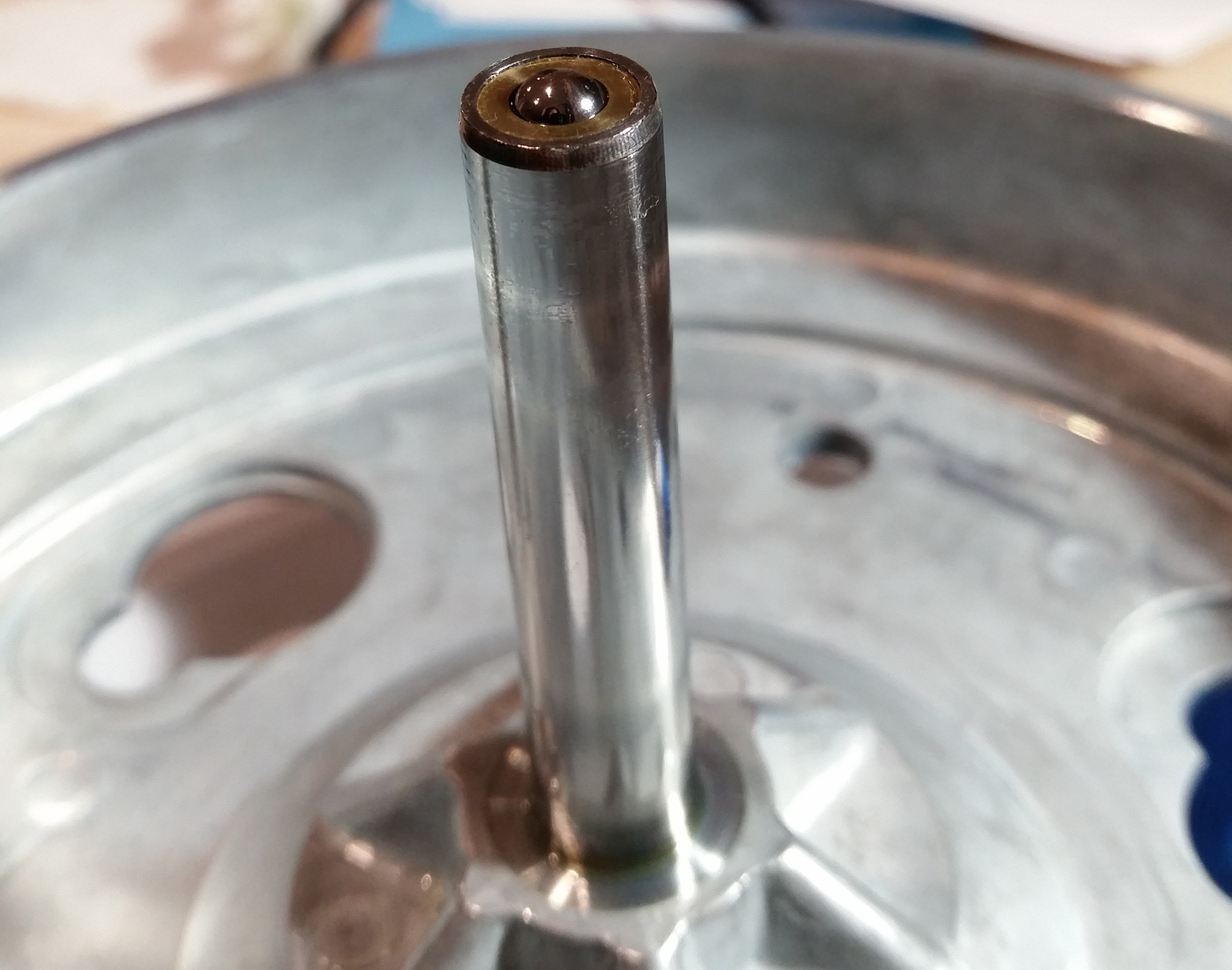

The TD-150 has no transport screws that I can see (the platter bounces freely). I could replace the dampers but I'll try not to be too invasive for the time being. However I took the opportunity to add some TT capacitor replacements in my order for the Bugle replacements.
I will also replace the ~50 year old signal cables and blackened contacts with RCA plugs and Belden 8402 cables. Same with the power cord. I want to do this in a new plinth, so I don't bore holes in the Thorens' pristine original chassis.
I polished and oiled the shaft, it may not be in pristine conditions, but not too bad either. It's the first one I see so I cannot judge.
