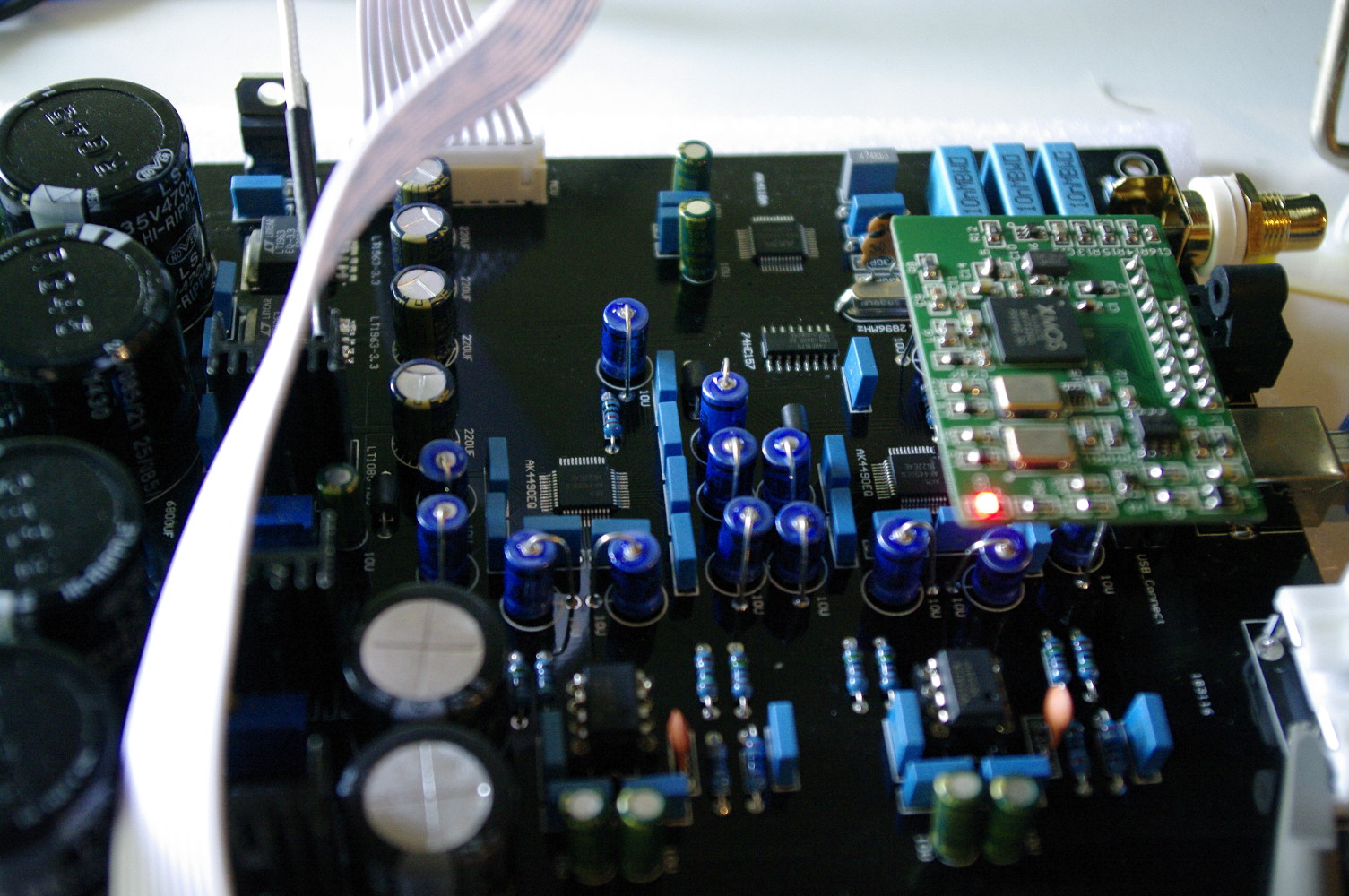

The board arrived today, seems nice. Sound via USB/XMOS is great, but I didn't get around to comparing it to my cheap DAC. So this might be a bit biased.
I am not entirely happy with the temperatures after an hour of listening (Environment temperature is 30C/86F):
2x LT1963-3.3 with 12Vin: 80C/176F
1x LT1085CT (12Vin/5.5Vout): 80C/176F (I suppose analogue voltage for the 4490s)
The three regulators heat two of the caps quite a bit, 40C/104F on the hulls.
Other regulators seem okay (L7805@60degC, LM317/LM137@45degC).
The two 4490 run at 60 degC/140F each.
I suppose my 9V transformer (blue block trafo) is a bit oversized (36VA) and the voltmeter reports 10.25V (between rectifier and CRC-snubber), maybe a smaller one will settle closer to 9V. I will check the power draw after the weekend and see if I replace it.

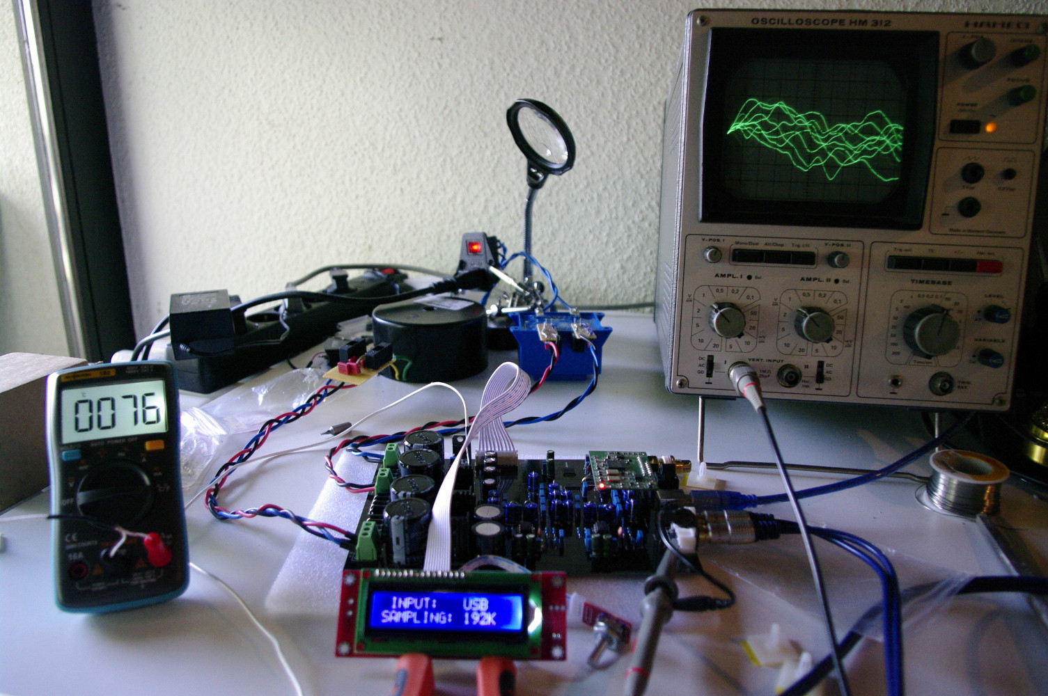

Some minor thread resurrection, because maybe someone finds this useful:
I created a faceplate/cover (what's the word?) and printed it. Fits well
See Cover plate for Chinese dual AK4490 DAC board by archimedesmp - Thingiverse for pictures and STL.
Next step (besides printing the power supply case) is to adapt dimdims akduino for that board and put the DAC into an old tuner (of course controlling the VFD and reading the buttons).
Also, I settled with 2x12V ring transformer for the output stage and a 2x7V Talema for the other two supply voltages and swapped the output op amps for TI1611.
If someone plans to buy this: Prepare to do something about USB noise. The XMOS only turns on if the 5V is there, so cutting the USB power lines doesn't help. A simple RC low pass filter (forgot the values) did reduce it to minimal levels, though.
