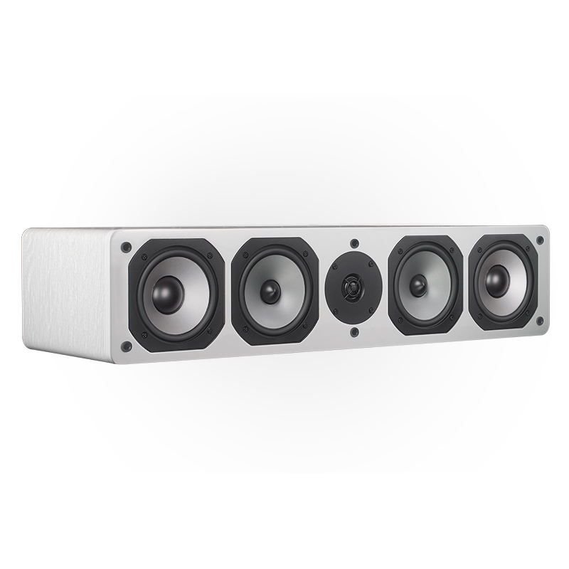

You see, I have Dolby Atmos upfiring speakers too, and these use a bigger tweeter than the one I have been looking at, and the one that's currently in my F/R channel speakers, it's 30mm instead of 25mm, also uses a waveguide, which I think could further improve the off-axis response from my towers and center channel.
I opened my center channel up and unfortunately there's not enough room to place the midrange/woofers more closely to the outer edges of the cabinet (with a new baffle) to accomodate for the larger tweeter that is 115mm instead of the original 100mm.
So the idea of creating my own baffles sort of died on me, I see no point when I can't fit the drivers that I want to, instead I'll just have to refer to the 100mm limitation of the tweeter and focus on finding the best possible (SB Acoustics SB26STAC-C000-4) and narrow down my area of improvement to the midrange and center channel woofers.

We're both talking about the same stuff, actually the TW030WA11 is the one fitted in my Dolby Atmos speakers, and that's the one I had hopes of fitting inside the current CC baffle.
Everything can be modified, of course, but the baffles of my speakers are clearcoated, I simply don't dare to router in clearcoat, I'm afraid it'll chip and the whole front is ruined.
Sure, it's a cheap speaker, but it still looks good as a whole, wouldn't really be of any positive outcome to have the cabinet ruined by the end the project.
I've routered plenty before, I always 3D sketch and send plate guides for waterjet-cutting, simply clamp them down and just router the heck out of it, there's no way the final design is any different than from the 3D sketch in the computer, high tolerance/precision work!
Routering is not the issue here, the clearcoat is.
New baffles is just too much work for the rather simple improvement I'm trying to achieve here, although it'd be the best option, I'm still limited by the CC cabinet/enclosure, so there you go.
Replacing MTM's is what will get me there, I think.
