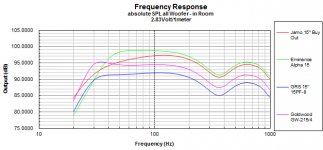

We can argue all day over which woofer is better on an OB just as we can any other woofer in another project. But we can agree that there are a handful of useable 15” woofers that can successfully be used on OB. The Alpha is often mentioned because it’s been used in many projects and heavily scrutinized for its magnet size, sound, build quality, etc. Having purchased the Jamo buyout woofers from PE for $20 I can readily say price does not coincide with quality. Despite the poorer looking performance (of my basic sim) the sound quality to my ears is superb in my son’s bedroom (maybe 14’ x 16’). Subjectively, I might even say the cheaper Jamo’s sound more musical than the Alphas. But they both certainly work great and produce full, rich bass. I would like to hear the Beta 15 (even with its lower Qts spec) and bet based on listener feedback they sound very good (tho they require boost of some kind which complicates the simplicity of this design). But I have no doubt many will prefer its sound once setup and dialed in properly. One can argue that any higher quality, lower Qts, greater Xmas 15” driver once properly ‘dialed in’ and optimized to work on an OB might outperform the more modest Alpha, GRS, Goldwood (and those superb sounding Jamo buyouts I wish I bought more of for $20).
To my ears, once above 200Hz, the Alphas suck in H-frames and probably on a simple OB baffle too. Whenever people criticize them I feel they’ve heard them working above 200Hz and understand their frustration as to why so many enjoy them. To my ears, the Alphas in H-frames are a standard of sorts (not necessarily the best or the worst, rather a benchmark others can be judged against). They trump any and all of the powered subs I’ve heard and built (my 12” powered sub uses the venerable and highly regarded ACI 12 woofer from several years ago). The Alpha’s provide great bass in my house. If there are better drivers for more or less money I’d love to hear them but for the price I really think they provide a lot of performance in the right design. It may not be the best but it’s certainly good enough and satisfying to me. I doubt I will look to spend more.
Here’s another quick sim of these drivers on a different sized baffle comparing their performance that I think illustrates how they may perform differently. As expected, lower efficiency trades for more extension. The higher Qts drivers roll of less rapidly than the lower (the Jamo has a Qts of .85). I’d try the GRS and Goldwood for a home project based on what I see on the charts and would expect them to perform good enough while providing satisfying bass.

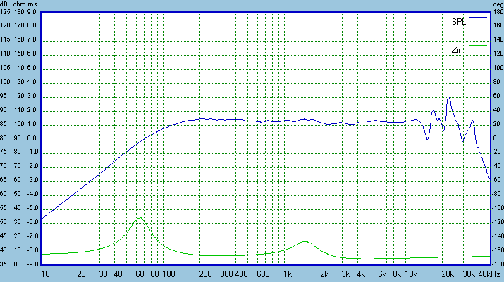

To get back on topic the distortion performance (@ 96dB @ 1/2m)
of zaphs mid and treble drivers is nothing short of excellent :
Red line is 1%, and 0.1% is -60dB.
Tweeter :
Should be a sweet sounding and clean tweeter.
Mid unit :
You can see the effect of the 9KHz peak for 3rd
at 3KHz, 4th at 2.25KHz and fifth at 1.8 KHz.
Note they are c/o 4th order L/R at 1.9KHz, so the mid will be 6dB
down at 2KHz, removing any distortion issues from ~ 2K upwards.
(In fact the mid is about 8dB down at 2KHz, due to asymmetry.)
rgds, sreten.
And FWIW the frequency response we are dealing with :
baffle effects and c/o correction of baffle hump not included
