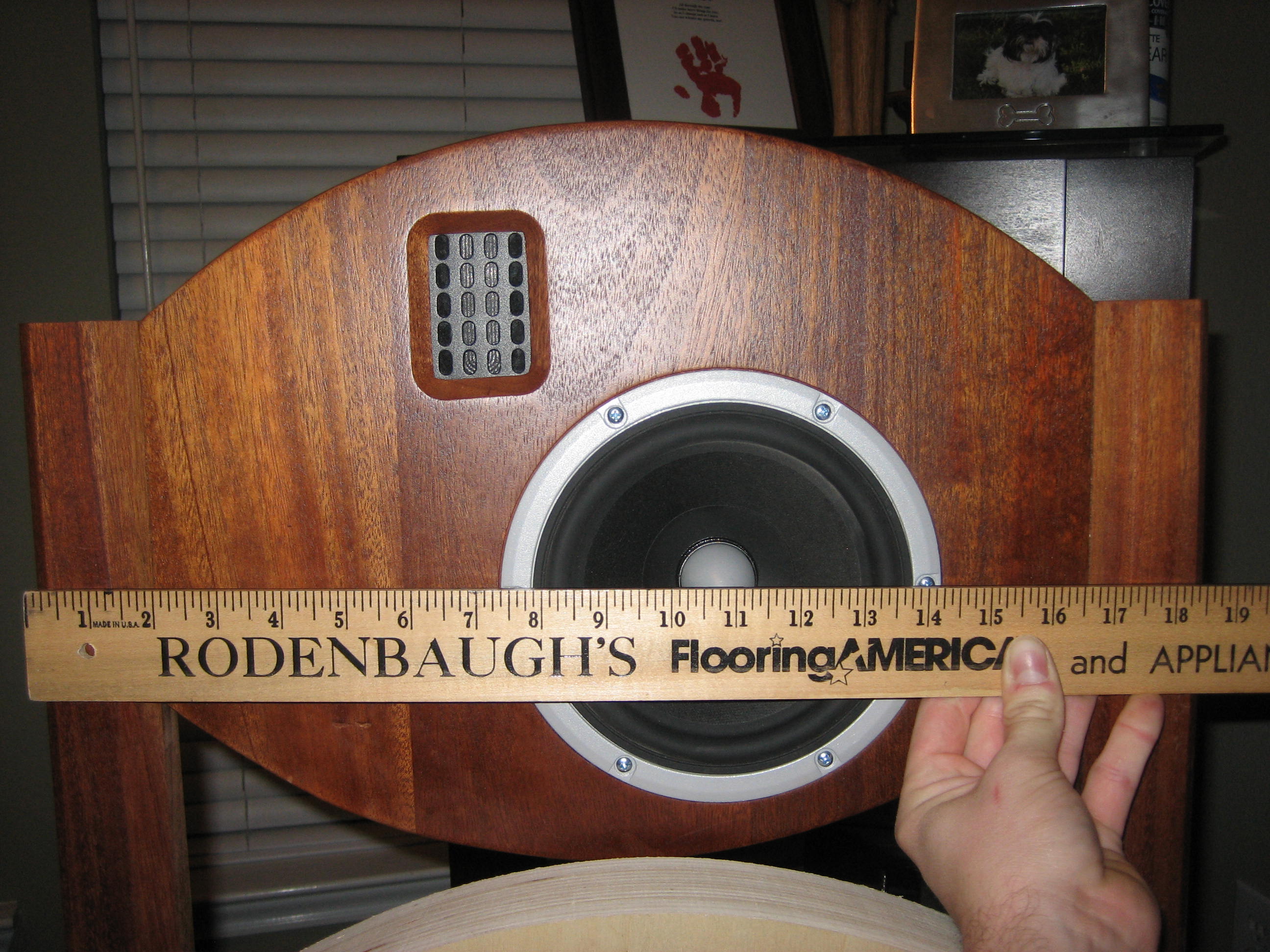

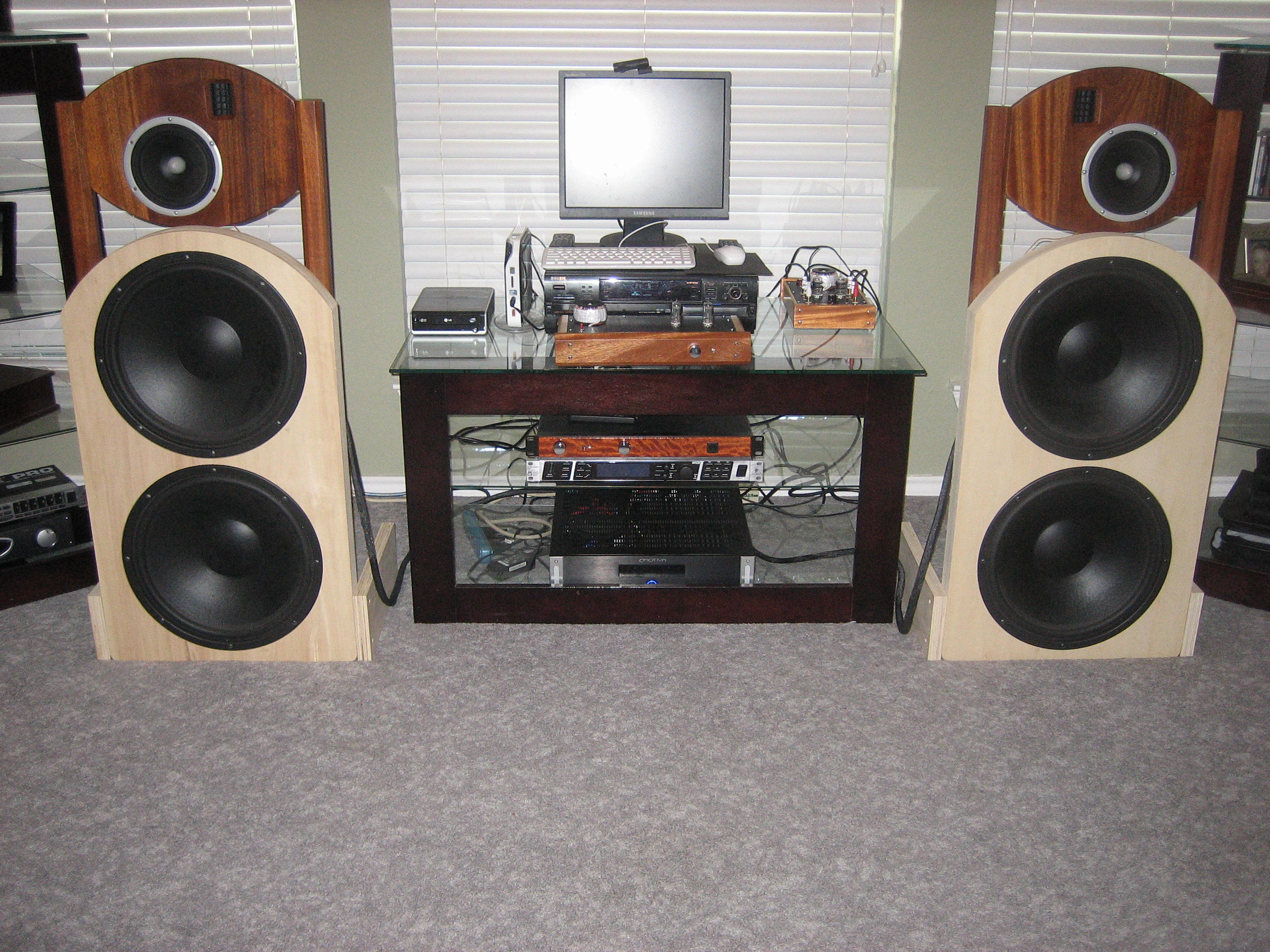

Martin, i think what you built and shared with us on that project is wonderful! I have a handful of full range drivers i'd like to experiment with and may do something similar. Great job thinking thru the removable baffle. I'd like to be able to accommodate larger drivers up to 8 inch. I'm in the process of building a sealed powered sub that will live in a corner allowing me to play with different drivers in different types of cabinets including OB. I haven't critically listened to anything except for the H-frames with Alpha 15s for a couple years and am curious how going back to a sealed sub will be. I'll report my listening impressions for sure.

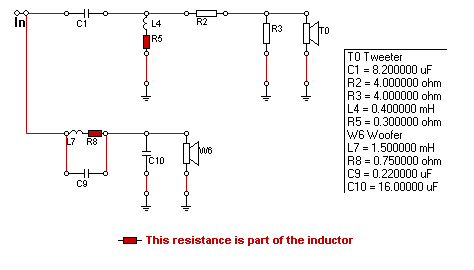

I do not intend to insist, but only to point something. With second crossover at ~1500-1800 Hz, these won't be a true dipole, but rather a no box speakers. Almost 4 octaves without rear radiation.

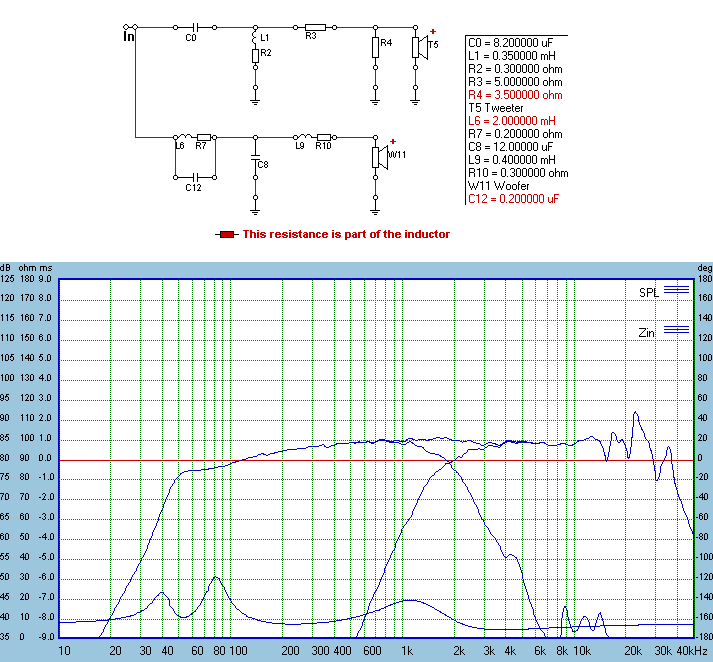

And if we consider the crossover of the Zaph in-wall:
R2 and R3 both being 4 ohm make about 8 db of attenuation (3ohm Dcr and 0.017mh). So the extra rear tweeter can come absolutely for free with no penalty in FR or phase response of the forward radiation.

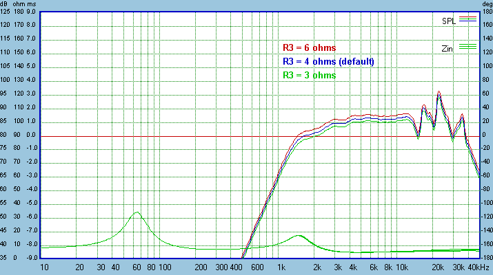

See the tweeter level options:
Impedance is steady 4 ohms 3 to 15 kHz regardless of R3.
The very small reactance of a tweeter makes a 4 ohm tweeter a much better approximation to 4 ohms than the range from 3 to 6 ohms admissible for R3.
The signal will still be divided in two with the one half being distributed to the front tweeter. You could even use up to two ohms in series with one of the tweeters for adjusting to taste and still be inline with the original parameters of the Zaph crossover. It just has provisioned signal dividing regardles how you burn the one half whether with a resistor or with another tweeter.
See tweeter parameters:
Vifa, DQ25SC16
Dcr - 3 ohms and Le - 0.017mh
It even can be said that you ought to add the rear tweeter in order to preserve the balance as it wasn't supposed to be a dipole. Further having in mind the above said that the rear tweeter comes at no penalty, it becomes obvious.
I have dipole that is a dipole up to ~10 kHz and one that is a dipole all the way and somehow the second one sound less artificial and more open.
**Sreten*don't*read*above*unless*you*decide*to*opt*for*a*rear*tweeter**
About the sensitivity, I think that the 86-87 db mean SPL of the ZAPH will blend nicely with the twin 88 db "15 Goldwoods, they would be at least 94 db@ the same voltage, this gives you nearly 8 db difference.
What is causing your concerns for the sensitivity? Maybe the different figures for the different versions?
The in wall version has the sensitivity if the baffle step compensated version. But without the BSC. Then maybe yours is the BSC version and not the in-wall one?
The crossover and FR of the conventional BSC version:
With 85 db, you will have nearly 10 db more bass SPL.
Best regards!

The above post is the sort of thing that just pointlessly complicates things.
the Jamo's are not dipolar above around 2KHz, and that is part of the original
premise, and there are lots of other OB's that are similar, without detriment.
2 ohm treble impedance is not appropriate, you can't add an extra tweeter
for free as R3 also damps the tweeters resonance, its all poor conjecture ...
Like I said if its good enough for a $10,000+ speaker, why argue ?
What is obvious very much depends on what you can actually see ....
The inwall version does not have the same sensitivity as the BSC version,
its higher, by 4dB or so, and 87dB is the target sensitivity, not 83dB,
the BSC'd version is simply wrong for a 20" baffle, it will be wrong.
As it is your showing the reduced BSC option, 85dB, but its still wrong.
The BSC versions are not appropriate. The baffle hump of a 20" wide baffle
is dealt with in MJKs c/o by moving the electrical c/o point to 500Hz to
give an acoustic 400Hz c/o point, (given a flat 2pi mid/treble response).
The in-wall version is designed to be flat into 2pi, halfspace, loading.
I don't like the look of the GW's*. The GRS's at 87dB will be 93dB a pair 4 ohm.
This is 6dB more than the ZA5.2iw which is 87dB, it might not be enough,
as MJK indicates bass levels are set 3dB higher than the sims indicate.
The idea is KISS, that doesn't mean the various issues haven't been
thought through, they have, which is why I posted the arrangement.
rgds, sreten.

You can do a lot worse for $30 ..... $23 for 4 or more .....
Two of these will be 93dB sensitive albeit 4 ohms impedance.
So MJK's bass c/o will need converting to 4 ohms to work.
That is basically it, the outline of a 20" wide plain open baffle speaker.
Ideally I'd say the modelling should be checked, ideally you'd
want to c/o to the bass as low as possible, to make the best
of the ZA14 driver, and limit the effects of the bass drivers,
but its a starting point for a cheap ambitious project.
I don't think there is much to add to the mid/treble c/o,
but modelling of the finer details of the bass to mid and
driver placement options could yield a better option.
Its not a practical design for my domestic environment,
but if nothing else its food for thought for speakers.
rgds, sreten.

Get the GRS. See the photo I posted earlier. Maybe John B will chime in here, he has four of them and likes them a lot. A much better driver than price and appearance would lead you to believe. (John owns more 12, 15, 18 & 21" drivers than any DIYer I know.)
OK, 5.2iw, got it. Looks like a good choice but I'll bet you have to do some crossover work to use it open back. Box crossovers (even IB) rarely work well on OB. The baffle, rear radiation and walls change the tonal balance enough that what works in a box doesn't work on OB. It's a good starting point, tho.

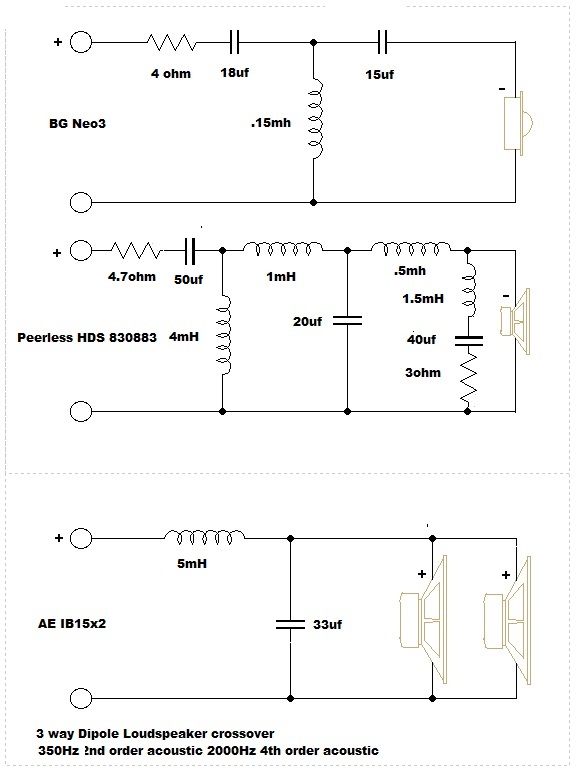

Here is one I have been working on. Should be done and measured soon. Not exactly beer budget, but I'm resourceful😉
A friend of mine designed the crossover, so I cannot answer much regarding the circuitry.
Blair
Blair
