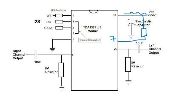

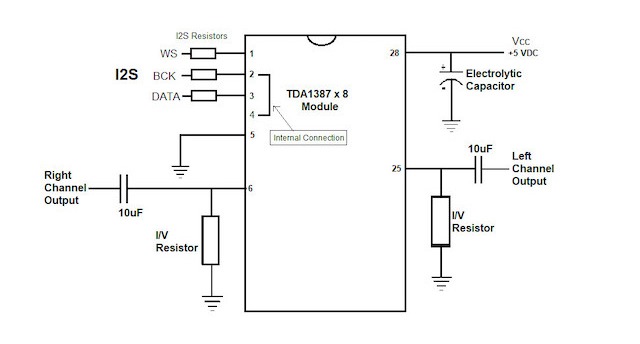

Could the passive filter be an inductor in series with the +5V on pin 28?
As for the resistor to increase current, would it go from the same pin 28 to pin 7, which is not normally used? (sorry for my stupid drawing...):
That would be a power supply filter rather than a signal filter. It certainly can reduce PSU noise but the inductor needs to have a low DC impedance and hence will be a bit bulky. The DAC module itself draws a signal dependent current which will result in modulation of the supply - this can be reduced significantly though by running the module in balanced mode. Meaning sending L & -L to it rather than L & R. Of course you'll need a second module to handle the R channel and an I2S splitter to generate the balanced digital signals.
Does the module connect all pin7s together? If it does then yes, a resistor from pin28 to pin7 would do the trick. If not, then individual resistors. I've used around 110k individually.

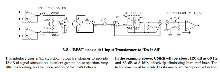

In your opinion, what would be better:
1) assemble two dacs with independent power supplies and transformers (in this case, could I use a 4:1 step-down transformer to convert the 2 outputs of each Dac into an unbalanced output, in something like the image below?), or:
2 ) mount two modules on a single board, with only one power supply, which would save two I/V resistors and 2 decoupling capacitors? (in this case, how are the L & R outputs of each module converted into L & -L, and R & -R?)

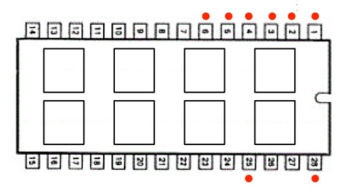

I will only realize it when I get the modules in hands... But I would bet that only used pins are paralleled...

I would definitely recommend your option 2), can't see any advantage from option 1). The L/R outputs are created by an I2S splitter, I have such a design using a small board of HC logic (shift regs, muxes). To run balanced you'd not save any I/V resistors, rather you'll need twice as many as unbalanced as you'll have four channels : L+,L-,R+,R-.
