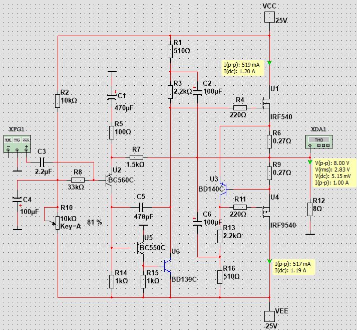

Real 25 pushpull class A watts into 8 ohms with impressive sound potential - here's a really quick thought, what do we all think?
Quick to set up and completely uncomplicated - it's supposed to be the Beelzebub.

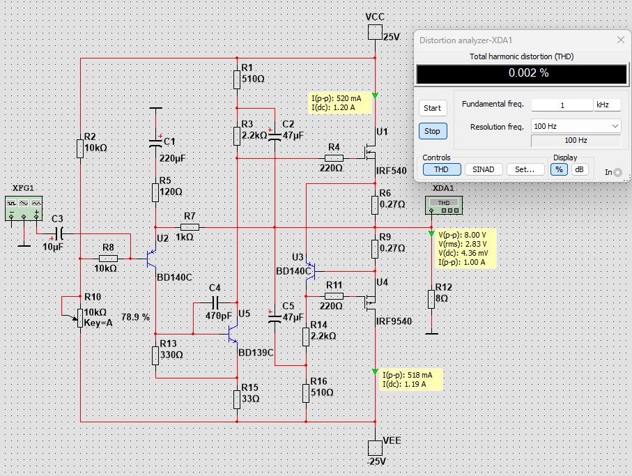

I am happy if you improve the "Beelzebub" design or simply change it according to your ideas.
I have changed a bit.
1. Increase the gain. Now is x16.
2. Using darlington VAS. With 2 transistors that is.
3. Decoupling the input. With one capacitor.
THD is now 0.0008%
Thanks to the darlington VAS, which improves distortion with 12 dB.
Considerations for the practical implementation of the project:
  • Switch-on delay, DC protection, output relay
  • Soft start of the power supply unit
  • Parallel connection of two MOS-FETs each' with Rsource=1Ohm (MOX 2W) || 1Ohm (MOX 2W)
  • Two separate, effective heat sinks for N & P - MOS
  • Protective resistor, up to 470Ohm Rbase of U3
  • min100VA toroidal transformer (or better), 2 * 18Vac
  • freewheeling diodes on the outputside
  • protection for V_GS with Z-diodes
Keeping an actual MOSFET amplifier from becoming a Power Oscillator instead of a Power Amplifier, sometimes is a different thing.
