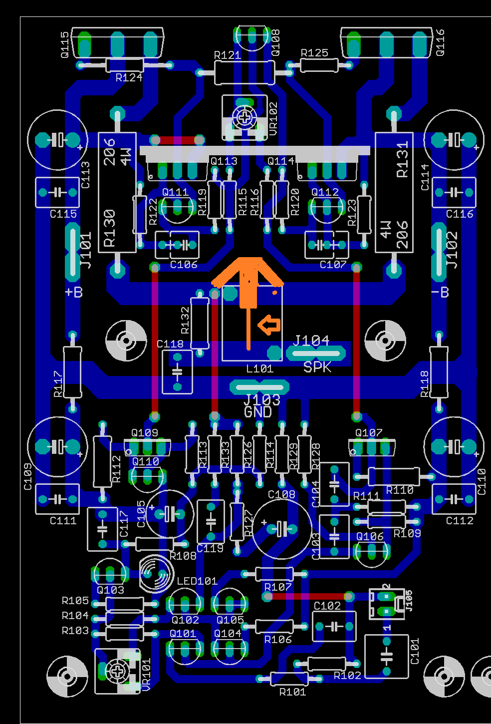

Im not sure my PCB layout is optimal, but I had to work hard to fit two channels into a 160x120mm board. Surface mount would help I guess, but my hands arent that steady 🙂 I have put the PCB layout here.

With regards to your PCB, I guess you will be applying power to the boards at C113/C114?
I am also wondering why you chose to use an output triple if you're only using a single pair of output transistors. In your original schematic, I had assumed that you'd omitted the extra pairs for clarity 😀 Of course if this is because you want to try a triple then there's nothing wrong with that either.
Are you going to be adding a protection circuit on another board, or just not bother with one?
You might have to break R129 and use a separate return to the star point from J105 instead, but that shouldn't be too much of an issue. I can see that you've placed the ground trace and components with some care, it will be interesting to see if you get any trouble from the decoupling ground bleeding into the signal ground.
I have also edited the PCB in paint a little, well added a small change that might help. Basically at the midpoint between the RE resistors, move the trace where I've highlighted in orange and then create a T off of it and attach the down bit to the output inductor and then attach the feedback point to the small trace beneath the output inductor.
Everything else looks fine.🙂
At J101/102, but yes. Fuses will be on the board with the main supply capacitors, shown here
Mainly because I wanted to try it. The particular configuration here I saw in Roender's take on the symasym, and thought it'd be interesting. Straightforward CFP has put me off in the past due to oscillation issues.
Will have a separate DC protect board, but no VI limiting. It will be a personal amp used in my office at average volume so it won't be abused 🙂
Well the beauty of it is I can, if necessary, simply not fit R129 and take a separate wire back to star ground as you mention 🙂
Yes, that is a good idea. Good to know my PCB design doesnt totally suck 🙂
Not quite, move the inductor down so it also connects a little into the T. From what I understand there are currents that flow between the output devices that don't flow into the speakers, you obviously don't want the inductor to be in that path and you don't want any of these influencing the feedback path. These currents aren't present in a class A amplifier, as there is always a constant current flowing through the power devices.
Really though from a PCB design stand point it isn't hard to design one, especially for a lower powered design, you just have to know what to and not to do.
1) Have separate ground returns for the decoupling and signal grounds. You may connect the VAS transistor to the decoupling ground without performance degradation.
2) At the point where the traces coming from the RE resistors meet, take a T off and connect the output inductor to this and take the feedback point just after the inductor if possible.
3) Make sure that no high current traces run close to or parallel to any of the input stage circuitry. If you've got the power coming in via wires, this gives you flexibility with regards to reducing induction based distortion. If everything is combined on a PCB, you don't, this is where I feel having the power traces flanking the ground return trace is probably far more beneficial.
4) Have the power come in close to the power transistors. Have the power trace feed into the power transistors then, to power the rest of the amplifier take a trace after the transistors. What you don't want to do is feed power in at the input stage and then have those traces feeding the output transistors, this makes large currents flow through the traces around the input circuitry and won't be a good idea.
5) Keep the input stage circuitry as far away from the output stage as possible 😀
That's essentially what I did when designing my PCBs, for both this amplifier and the low powered one linked to at the start of the thread. Where signal traces and power traces are close together, I tried to take them to different sides of the PCB if possible, obviously you can't do that with a single sided PCB.
When it comes to where do you feed the ground return for the current sources? I think that it's best to run these through the signal ground. They do not contain contaminants and are probably beneficial.
With class A biasing, decoupling currents and induction based distortion cannot harm the performance. This is because the current flowing in the power rails is constant. As a result, regardless of the signal being amplified the current drawn is always the same.
In class AB amplifiers, half sine wave pulses develop on the power rails because current demands are placed on the power rails that vary in proportion to the magnitude of the signal being amplified.
If there is a constant current flowing through the signal ground, it might be harder to pollute it? This might be total rubbish mind you, as you've still got half sine wave pulses on the supply rails.😕
