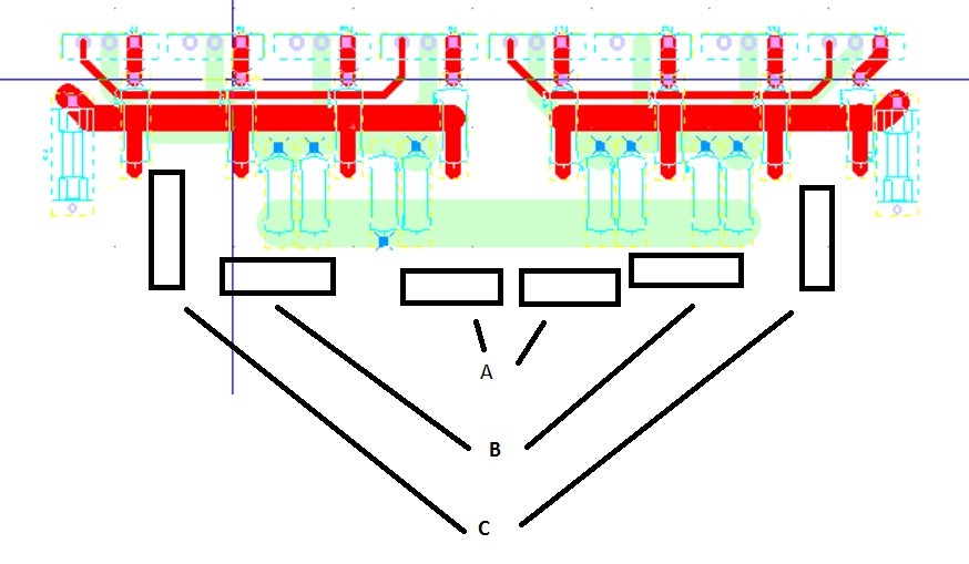

Anything relating to board layout, even if just small tips would be appreciated. The PCBs I designed for the 80-100 watt design were a success and in no small part because of Self's guide. However I'm presuming that there are certain tracks that should be kept short and possibly kept away from 'things' to ensure stability. If I can incorporate them now, that'd be rather handy.
Naturally I am trying to keep things compact and by doing so reduce trace length, but there are limits to these things. For example however.
This is the first edition of the PCB, where I simply connected the output transistors together. I can move them slightly closer in to reduce trace length a little, either way, cue my MS paint skills.
What we've got marked are ideas for the pre driver locations.
A) would keep the pre drivers close together.
B) would place them further apart, but put them slightly closer to the output stage.
C) C over position B, moves them even further apart and would perhaps minimise trace length a little bit, between the pre-drivers and the output transistors, .
From what I understand increasing the distance between the two pre-drivers shouldn't be of any concern. What is important though is keeping the trace length between the pre drivers and their relative output transistors to a minimum - as it's the pre driver + output transistors that form the functional 'part' of the amplifier.
5th, could you post your schematic, so we're all on the same page? It is not clear why you have 6 pre-drivers and no drivers. I'm almost guessing that you are making paralelled CFPs vs. CFP with paralelled output transistors...?
Just violate all RF rules for board lay out.
Most important as Self pointed out is to take the feedback point on the board right from the output where you speaker wire will connect.
If the traces are wide then the length is not such a big issue. You want to keep the trace resistance as low a possible. Grounding is a big big issue. Have everything wired to a central ground point down stream from the reservoir caps. Not necessarily on the board. Keep you input ground separate from rail bypassing caps ground returns. Place you input ground down stream from other heavy current grounds like the speaker ground. The idea is to keep the grounds as close to the same potential as possible. never loop a ground or a power rail for that matter. I've seen people do that on their boards.
