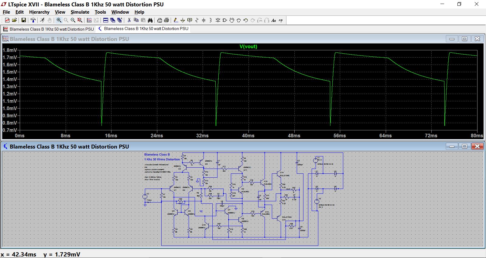

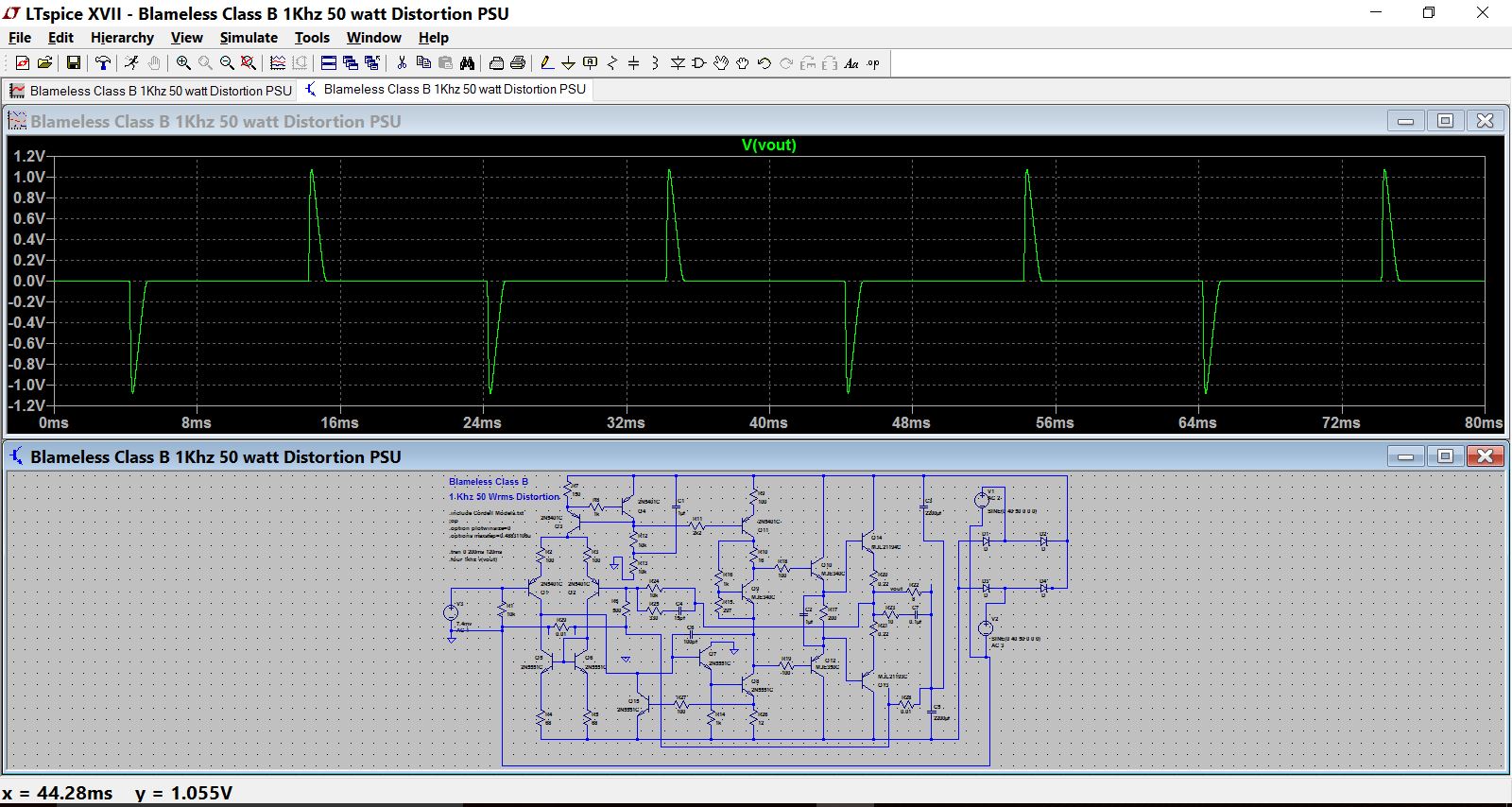

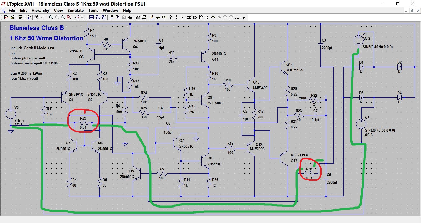

I don't know if this will help or not but its a simulation of a well known design. I have deliberately added two 0.01 ohm resistances in the ground trace to deliberately allow the power supply to generate a small volt drop across this resistance. The two graphs show the resistors initially shorted (so a true zero ohm ground) and then in place.
The two deliberately added resistances are in red. The ground path is green.
This shows how the hum level increases by the addition of this tiny resistance. Notice the scales at the left of the graph. And that is just caused by adding 0.01 ohm.

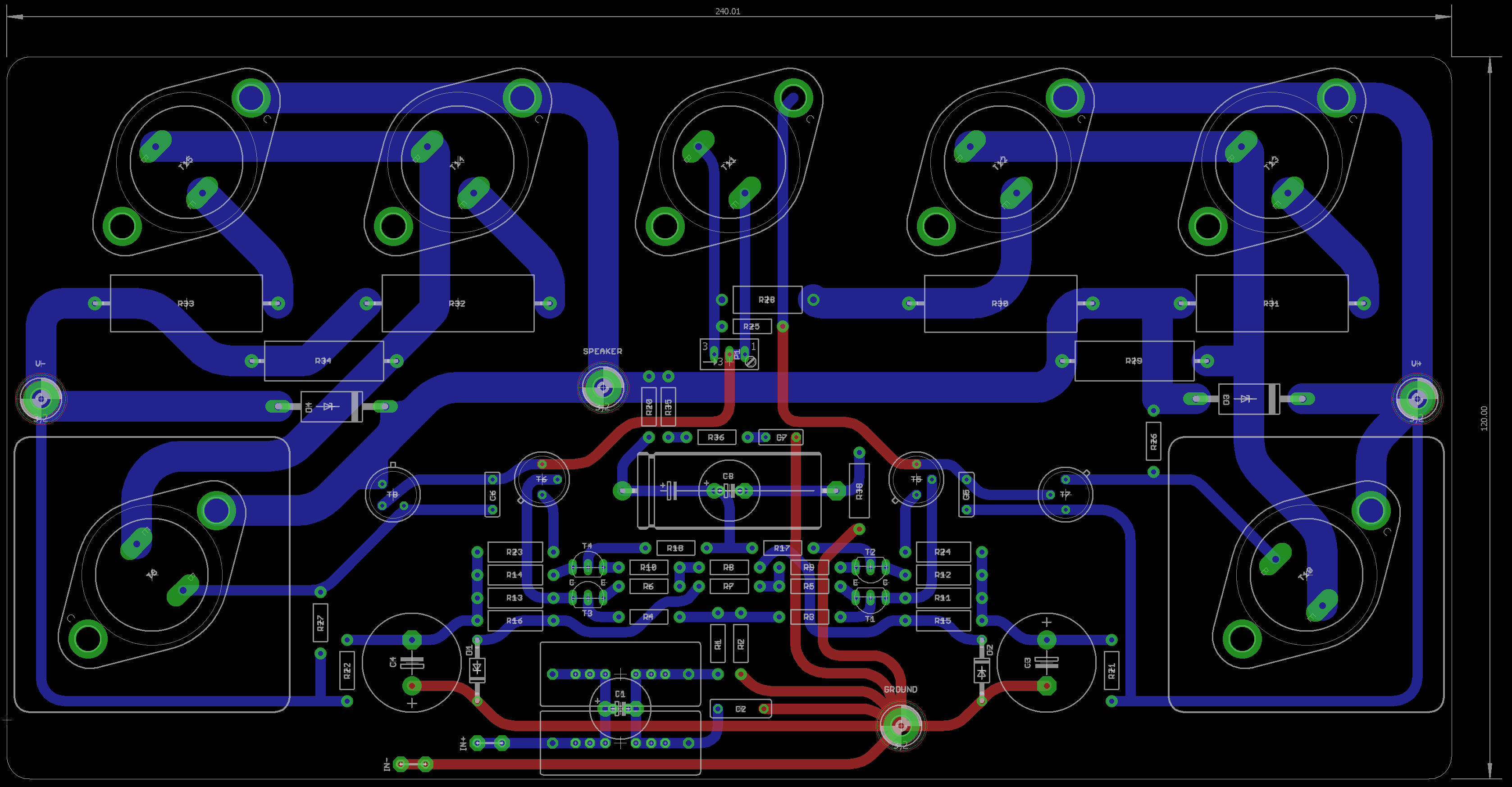

AAMOI, I chap I met here on the forum (South African stays in Johannesburg) did a new layout of the 25.25 PCB for me. My originals are shot - tracks lifting off etc. They are slightly larger than the original and double sided. I had ten made (JLC) but still need to get them finished off - drill holes on the angle aluminium so that I can get the power transistors mounted and a suitable cabinet. The heatsinks I have will be considerably larger than the originals - 6 x more radiating area.
I gave a pair to an audio friend (valve amp aficionado) and he has built them up and on the go. He said he matched the BC550/560s in the front end and has a 2.5mV on one channel and 3.2 mV on the other. He has incredibly sensitive speakers and has not reported any hum or buzz on either channel. He also used a single 500 VA toroidal, and 4 off 10 000uF caps and a 35 Ampere bridge rectifier.
Attached is the schematic and layout picture of the PCB etc.
Regards, Kevin
