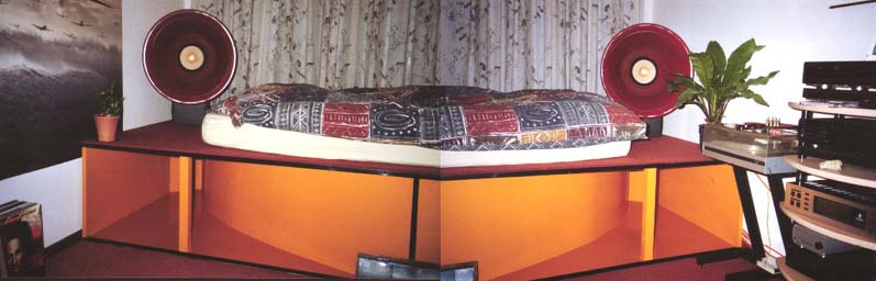

haha you guys crack me up! Yeah I didn't even think about about a sealed enclosure! With an enclosure that large it should give me a nice flat response tuned real low. Perfect! That "X" horn desing is a little bit to wicked for me I think lol. The bed could also be used as a good body massager. Think of all the possibilities!

The ones at the very bottom, the "Future ExecutionerX 15 and 18", are very exciting to read about, and I would LOVE to see some of those in a horn-loaded configuration... I'll bet you'd have room for that under your bed!
Whatever you decide, let's see some pictures as you're building it!
