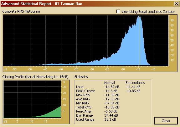

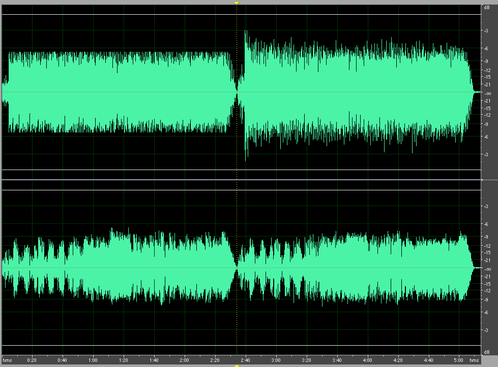

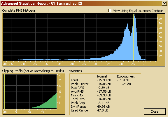

I've bought the box and I'm not impressed.
I'll let you have a look at Taxman from the Revolver album.
Left the new remastered version, right the LP version.
A listening session gives more detail for the remastered track but more musicality and less harshness for the LP version. The difference is not subtitle.
Listening from the remastered version has been done from an EAC rip.
Both tracks loaded in Audition, output via M-Audio firewire, amp, speakers.
Furthermore, I'm at a loss (again) why engineers desperately need to push that compression button.
Sad really.
