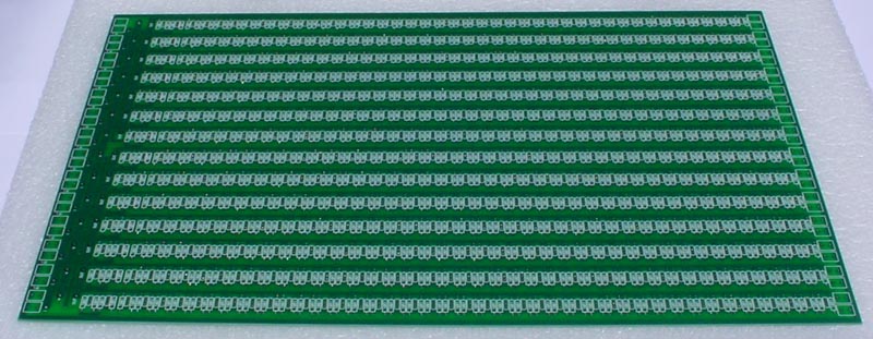

What are the actual dimensions of that pcb?
Tad

😱If ever something needed surface mounting it is that design. Esp the stuffing stage.
Mental with a capital M
PCB = heatsink?
PCB = heatsink?
