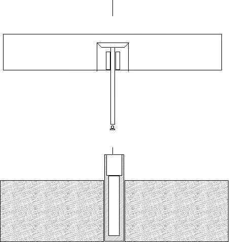

A simple plain bearing is realively simple and cheap to make. The bearing would consist of a 3/8" polished shaft, supported by a steel or ceramic ball running on a Delrin or teflon thrust pad, and a brass housing with oil bath. This should support a 5lb platter without any difficulty. You may be able to incorporate the spindle that you've already had machined, depending on it's dimensions. The tolerance between the shaft and the housing is the important part.

Consider another approach as well: cut down automotive intake valve stem and valve guide. Hard shaft, long life bearing, machine shop lapped to a very good running fit = very long life and very low friction = 😀

For a crude example, I suggestion an automotive intake valve and bronze (or brass) bearing (with a tiny hardened steel ball ~~ 5/16" dia.), closely centered within the turntable platter's center of mass:

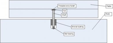

So it looks like a reasonable solution would be a 3/8" or 1/2" precision ground shaft with one threaded end (the threads used to attach it to the platter) in a bronze bushing which is a friction fit in the plinth.

... with support platform and shaft bearing holder. ... just add some light machine oil to the cavity ...:smash:

The larger your shaft diameter, the greater the friction (a linear, not exponential problem, but still a problem). The KISS principle (revised): Keep it simple and small.
(Note that almost all loads are vertical = the weight of the rotating table pressing on that tiny ball bearing & the small teflon disc. Any laterial or off center loads would be caused by errors in balance, the tension on your motor drive belt ... and possibly the off center weight of your cartrage & needle.)

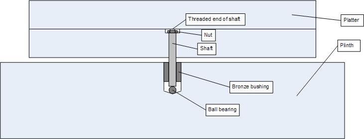

OK, so something like this? The potential drawbacks I can see are:
1. The platter weight is actually all on the upper end of the threaded portion of the shaft; all that the nut is doing is holding the shaft in when the platter is removed. I suppose one possibility would be to have the shaft machined to take a circlip at the bottom of the platter - I don't know how important that might be.
2. The ball bearing as drawn is intended to be sitting in the cone left by the drill bit, and I don't know how centred this will make it (nor how centred it needs to be).
