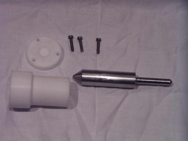

in my experiance,...very few machine shops can come close to a linn or thornes bearing:bigeyes:
there perseption of close tolerance is hard to gtee on one off bits of work,,and sometimes expensive to find out
i make my own bearings...and it takes so many goes to just get 1 of perfection....and everytime i do it i wish i had just taken the easy option of buyin a secondhand linn or thornes bearing/shaft
hope that helps
best wishes
j7
hi Vinyl-Addict
i have my own high presion lathe... and a nice mill and,... i have a new cnc mill, ...10 ton press ...and index machine for mill etc...
between them i have a limited ability ...and no time to fiddle..so im not lookin for any work on that side
as i said in last post makeing bearings ...or top class bearings for turntables is very easy to make bad and very hard to be better
when i was very young i managed to get a tour round "castel engeering (the peeps linn use to make the bearings) even at a young age i was totally shocked at the high presion used
:smash:
any questions just ask and best wishes
j7

Thanks for the reply. I was just curious as to why it took several attempts to make a successful bearing. I own and operate a machine shop, manufacturing is my business so no problem with equipment at hand. I agree that designing and making a bearing that will work is quite difficult and having the right equipment for the job is mandatory if success is what you seek. ;)
Internal view of upper housing with tungsten carbide thrust plate, 2 micron finish.
Both housings shown-This is obviously an inverted design.
