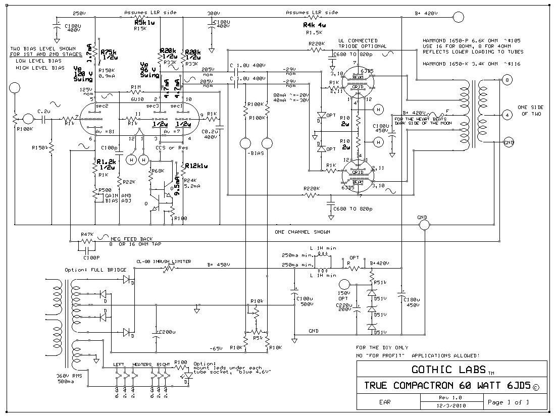

TETRODE COMPACTRON AMP 6JD5
Got a little crazy last night and thought I should try a UL connected tetrode compactron design using 6JD5 tubes. Using the same board with mods, get rid of the 150 volt bias requirement, but then need UL output transformers. I guess another option would be to triode connect it, beam to plate. Thinking that it may require a little more drive I increased the bias current in the first 2 stages.
I have a matched set of tubes on order and started to do the PCB design.
Any advice on 6JD5 tubes???
The 6JD5 is not a tetrode, it's a beam triode. The second grid is a beam forming plate, not a screen grid.
My experiments were limited to 550 volts since that was the biggest power supply I had at the time. The second grid is indeed a beam former. I did however tie it to the plate just to see what happens. Nothing blew up. The tube was able to pass about 80 mA with no bias and 550 volts on plate and supressor, however I could not control the oscillation. With the supressor grounded I only got about 20 mA of plate current. The entire test circuit was sky wired on to the tube socket, so better results could be achieved with a better layout.

I've built about a dozen amps and preamps with this family of tubes. Mostly SE. In Class A1 they need more than 1kV B+ to provide meaningful output. I never had any issues with oscillation. Careful layout will take care of that.
They are quite robust and can handle some abuse. Running them at or even slightly beyond the max plate dissipation is not a big issue. They have quite high plate resistance.
There is a SE output transformer available from Lundahl, which fits well. He developed that one on my request. It has 16k primary impedance, 30mA DC current. The transformer is the type LL2735B
