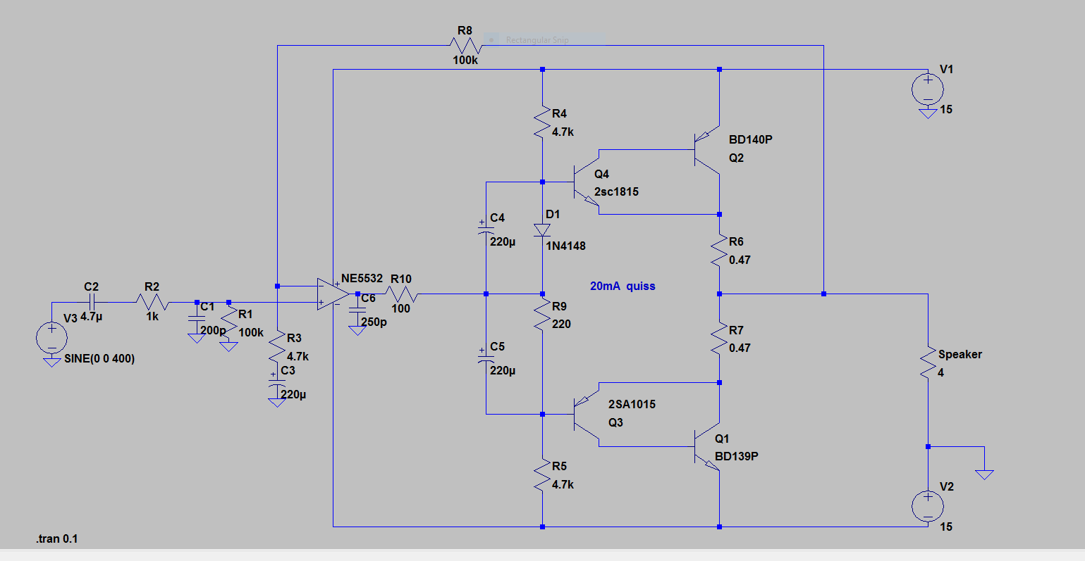

If you are using TIP darlingtons you probably don't need drivers. Regular TIPs you do. The reason you want a half amp driver is because TIPs have the nasty characteristic of having a gain of no more than 20 at rated collector current. May be as low as 10. Driving TIPs as a good job for those 1 watt tall body TO92s, which for the most part are being phased out. Get em now while u can.

Just from curiosity i have built it. Here is the schematic. 1n4148 is actually a fast diode ( dual in one package , To220 i think ) from a power supply , screwed on the heatsink with the BD's
My " tower " speakers in parallel 3ohm . +-15v rails
Results just before clip :
28hz 3ohm - 5v rms
20hz 3ohm - 4.8v rms
8hz 3ohm - 4.3v rms
100hz 3ohm - 5.4v rms
400hz 3ohm - 4.9v rms
1khz 3ohm - 5.2v rms
5khz 3ohm - 4v rms
10khz 3ohm - 3.5v rms
The power gets down at higher frequency, I would describe it sounding way better than TDA2030 .🙄
