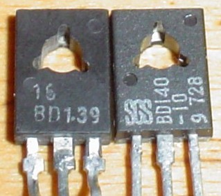

Here's a pic: the one on the left is a Philips type, the second one a Thomson device.
Technology may have evolved in 20 years time, but 20 years ago the Philips BDs were very different from the others, as are the last production runs.

the ones on the pic i bought before 1985, guess i'm an ever bigger relic than you.

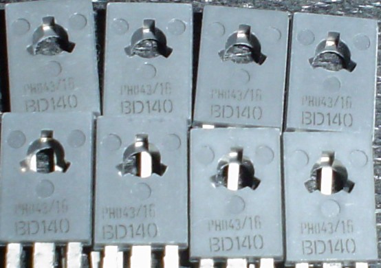

jacco vermeulen said:Finally managed to get a clear digital cam shot of last production Philips BD140 devices, tricky casing color, so here goes=>

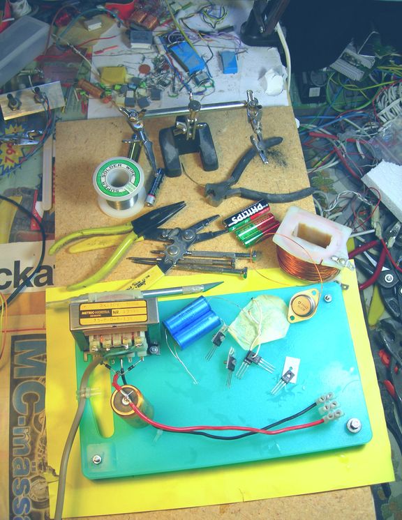

Below is result from my electronical corner of my room ( I live alone in 1 room + kitchen + bathroom)
Photo Session 15 minutes ago:
Lineup Audio Lab
Exhibition of BD139 BD140 stuff

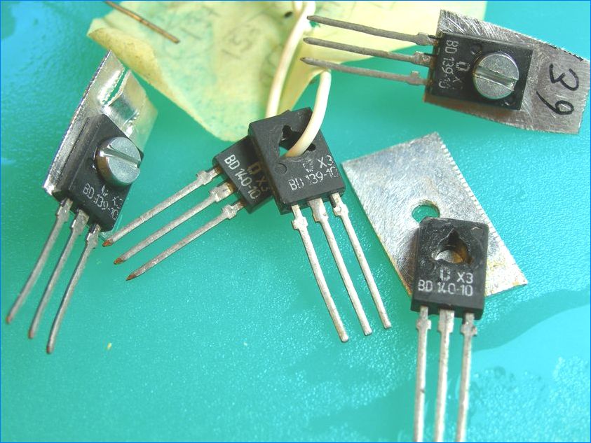

Image #1:
Overview of a part of my working place, with those TO-126
BD139 BD140 BUX39 - close up
here a close up
The pair, is a 'matched complementary' pair BD139 BD140
.. with my test figures on a paper attached with piece of wire.
Also can see some simple home made heatsinks
I use sometimes just in case.
I have bigger heatsinks for TO-126 TO-220 for 'hotter bias' applications, approaching temperture limit
Regards lineup 🙂

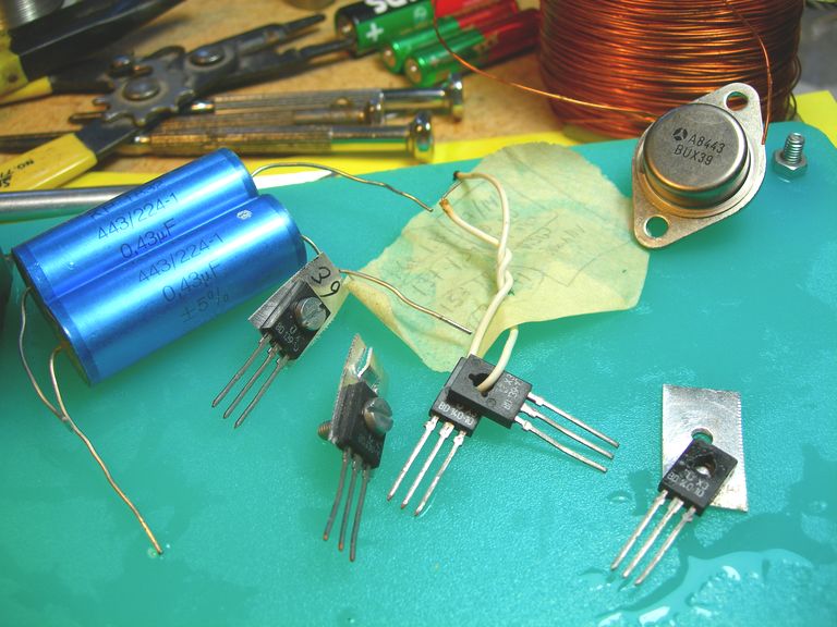

BUX39 and 200V
I still have a couple of those TO-3 big BUX39 left.
I bought 10 of them from a surplus sale, for almost nothing.
They are good for some heavier Currents non-Audio-amplifier things.
Those 2 caps are Polypropylene Axial:
marked: ERO KP1832, 200V=, 5%, 0.43uF
In upper right is a capture from A slaughter of old Transformator.
Enamelled copper wire is good for many things ....
in my little corner of my room company:
LIneup Audio Lab >>>> .. like 4 square meter. ( 2m x 2m )
But dont you go fool your selves, too much
- plenty of small goodies is too be found inside that little limited space of my life 😎

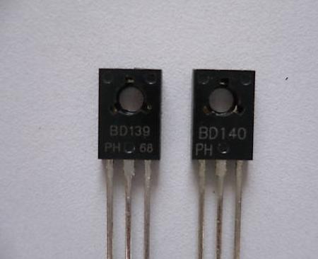

They don't look like mine ... which were manufacted by Philips about 25 - 30 years ago ...
The ones I have have the printing of the type number on the bottom row closest to the pins ... not the next row up, like these. The three moulding dots are located close to the through hole, the edge is under 1 mm away, unlike these that have the moulding dots almost in the upper corners of the body.

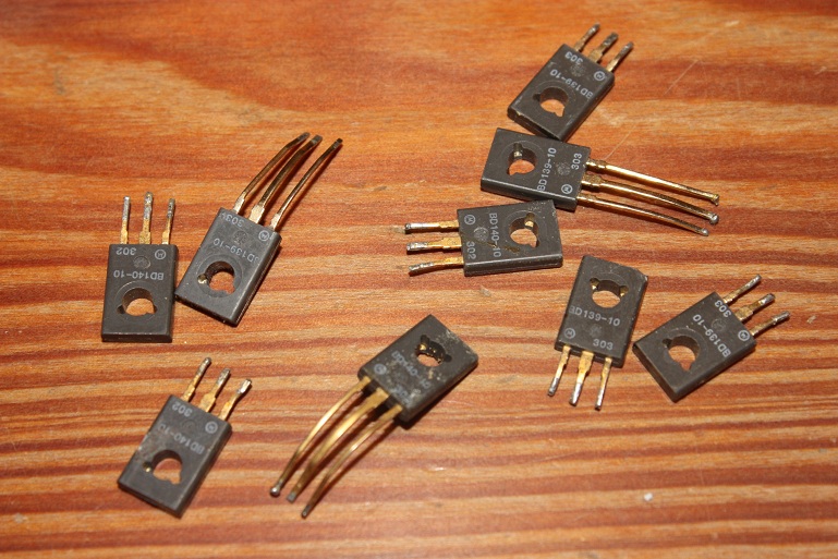

no mention of original Motorola ?
I have a few with greyish house and gold legs
but they have been pulled from burned amp many years ago, so I will need to check them
UPS!
I had not noticed this is a reopened older thread
but whatever, I measured my old Motorola BD139/140
not that I know much about how, but with diode function on my multimeter, I read 900...something
from one leg to other two, on all the shown devices
so I guess they are all ok ?

You must have a capacitance meter which able to measure in picofarads. You have to measure 2nd leg (Collector) and 3rd leg (Base) with capacitance meter for comparison.
If you want to know your transistors are working or not, just measure their HfE using a suitable multimeter. Many multimeters contain this feature rather than capacitance measurement.
