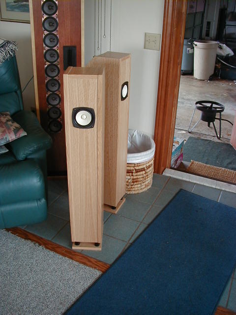

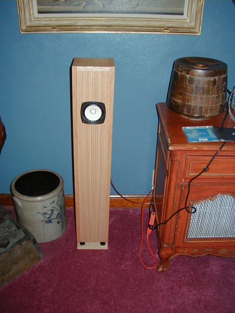

A morning away and I have the cases assembled for two pair!
Got a two pair of RS's for one and I'll buy some Fostex's for the other.
Thanks to GG for inspiring me to build these AND radius the backs BEFORE assembly.
You da' man!
You da' man!
chipco3434 said:A morning away and I have the cases assembled for two pair!
You da' man!
Chip,
If you have four 40-1197 and four FE103E you may want to consider using the 40-1197 as the rear drivers and the FE103E as the front driver. The FE103E is supposed to have a smoother mid range and more extended response, while the 40-1197 has a higher Q and can develop more bass.

Fired them up last night with a BrianGT 3875. I AM IN AWE! Incredible sound & detail. Great bass for such little animals. Did the 103's up front and the 1197's in the rear.
They are HI-FI! Sound great. I made two pairs.
chipco3434 said:Hey Planet10... I know you read all this wacky Full Range stuff. What's the verdict on the super tweeter & cap for these little bad boys? Nothing that's made of unobtainium... can be purchased on the 3rd planet.
Man they sound GREAT!
Glad you are happy. I've not had the chance to play with a real 103. The 1197 needs help above about 10k (2 uF cap + 8 ohm tweeter). With the 103 a bit smaller cap might be required. There are lots of tweeters that work well and where you will find that the tweeters cost less than the Solen caps, and shipping even more. ie A set of thimble tweeters, 1.8 uF Solens, shipped slow boat to the US would be close to $10. Air adds a couple bucks.
