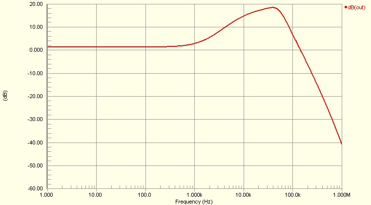

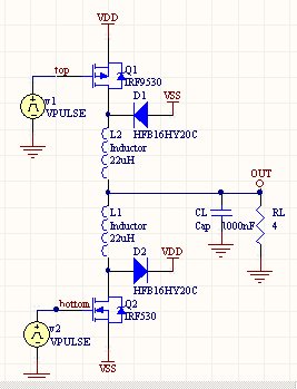

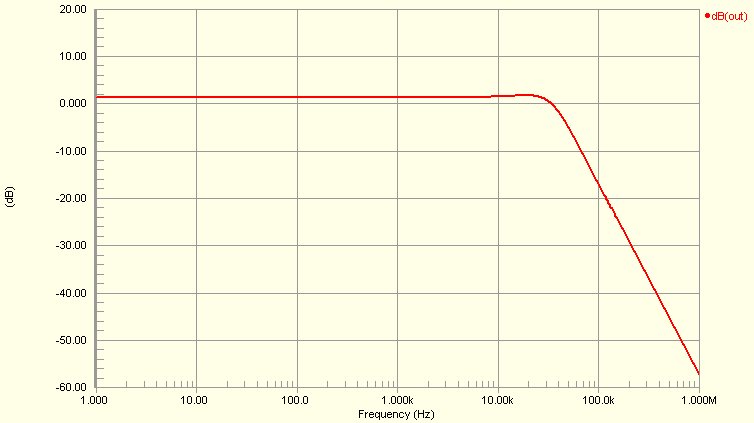

I try to simulate a simple half bridge LC filter, L=22uH, C=1uF, load=4ohm.
The Gate drive to both devices in BCA is always in phase and hence the devices conduct simuntaneously!! whereas your diagram shows simple complementary halfbridge, in which device conduction is based on appropriate polarity of signal with respect to channel polarity of device
Also the inductors used in BCA are atleast 220uH not 22uH.
