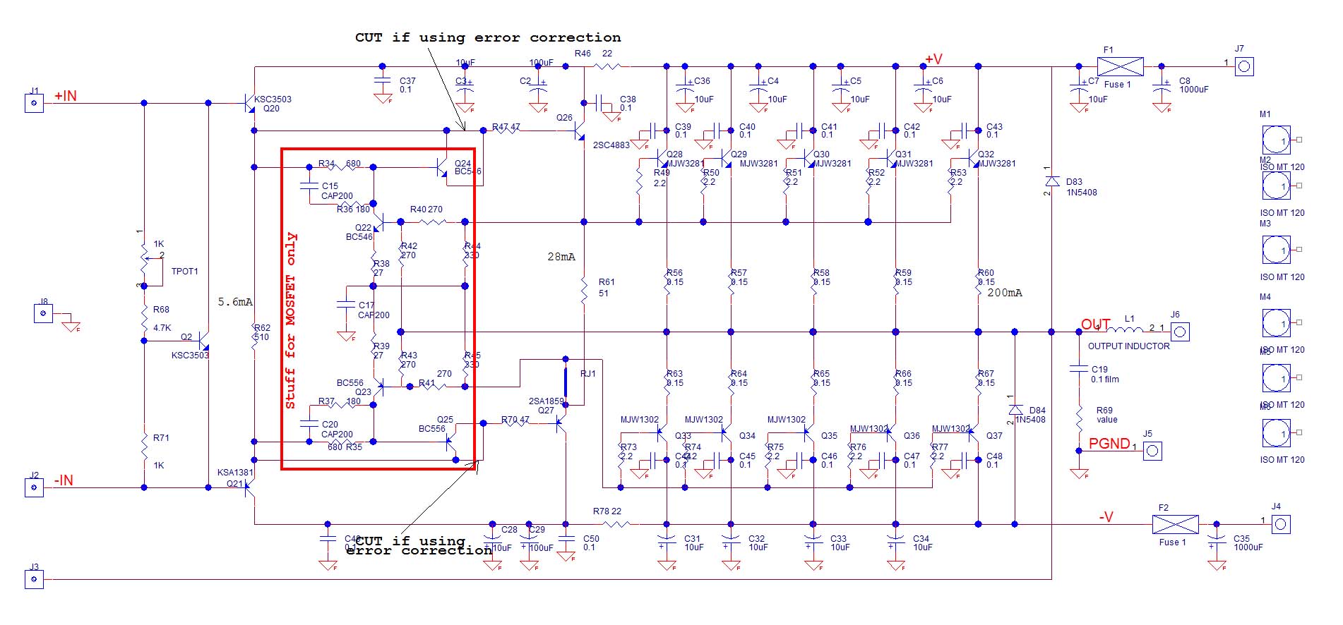

I have another important question:
I am planning to use 3EF OPS. I already finished the layout of the OPS on a 10.5" X 2" pcb with 3EF but only in 3 NPN on top and 3PNP at the bottom. Before I sent it out, I want to run by you guys whether I should look into using one PNP on the top and one NPN at the bottom. With 3NPN/3PNP, The Vbe multiplier has to do 6Vbe where as using an opposite transistor on each side only need 2Vbe.
Please advice.

Hi Alan, this is completely unclear (at least to me 🙂):
Can you please drop a sketch (hand-drawing or something)?

I can do better!!! Attached is the latest schematic that I already have the board layout and gerber generated.
If I am going to redo the board, I likely will remove all the error correction stuffs as I have no plan to try MOSFET. Also, I want to see whether I can use the space to put the SS relay for speaker protection.
Please comment, this is a lot more critical than the IPS/VAS board. the components are a lot more expensive. I want to do it one time through. IPS/VAS board is cheap and components are cheap. I am planning to fab 3 different versions. One I want to try is Apexaudio SR200 design with enhancement. I still want to read the CFA design also.
OK, I probably see now 🙂
Your question is - whether you use EF3 (as it is now) with 6Vbe bias, or you use a CFP (Sziklai) arrangement, having just 2Vbe bias in this case, right?
