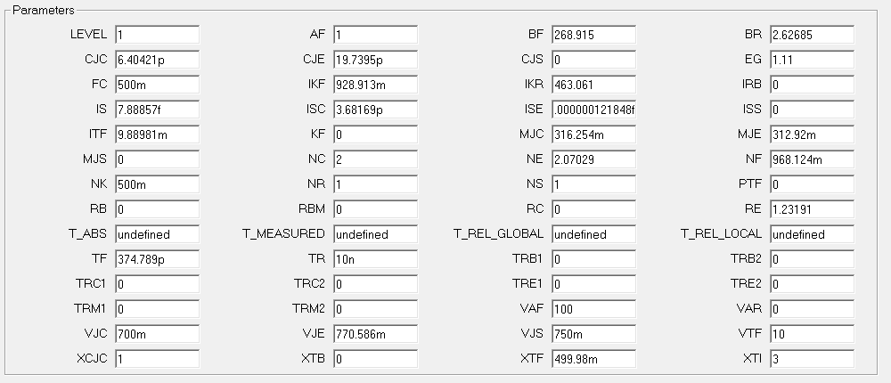

try this Jorge.
This is what I have, for the B version only.
