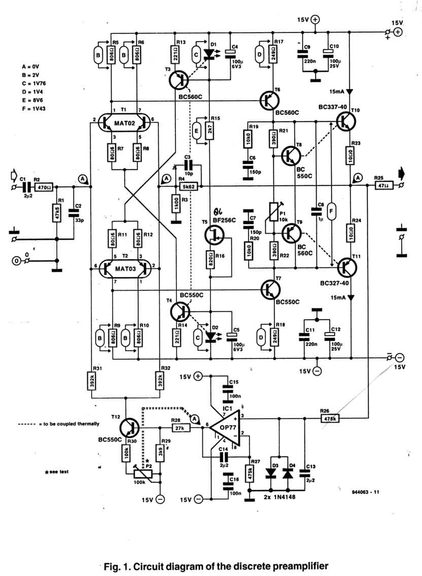

BC327/337 replacements
This is a very ordinary transistor but with a bit more current than usual. I doubt though that this is an important parameter.
You can replace these types with almost any transistor but if you explain more where in the design they are I can give you a more precise recommendation.
The "40" suffix means hfe more than 400 which could be tricky to find but it's not for certain that you need this. I have a bunch of BC550C and BC560C which may fit.
C = "40"
Hi peranders,
The transistors will be at the output of the ELEKTOR discrete
opamp.
Do u think the BD139/140 is overkill for that?
Udi.

peranders said:
337 can take a bit more current but I doubt that this an issue.
How come the 327/337 can take more current than the
139/140??
327/337 are rated 500ma while the 139/140 are 1500ma..
And if I'm using the 139/140 do u think I'll need to bias them
harder than the 327/337?
Udi.

.... 500 mA vs. 1500 mA which is more? 🙂
You can probably have the same bias but the base current will be at least 4 times more so pay attention to this.
I see no problem to use BC550/560 though, 15 mA => 225 mW => not too much
Forgive me for my ignorance in this area, but shouldn't higher
current capability should be a plus?
If I use the BC550/560 instead of the originals (BC327/337)
than I'll have less output current, am I wrong? so
why using weaker transistor will not cause problems?
Maybe It's my english (that is my second language), but when
u say "can take" a bit more current, you mean more driving capabilities, right?
Udi.
Ok..Now I understand. My mistake.
You meant that either the 550 or the 337 will have
no problems biased with 15ma (225mw out of
500mw that BC550 can handle)...
I'm thinking of using a buffer at the output..a discrete one
I guess..
I just wanna make sure that the opamp will stay in class A.
Thanks..
Udi.
