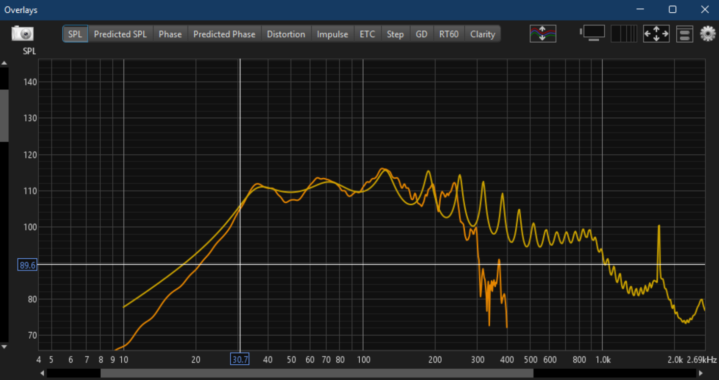

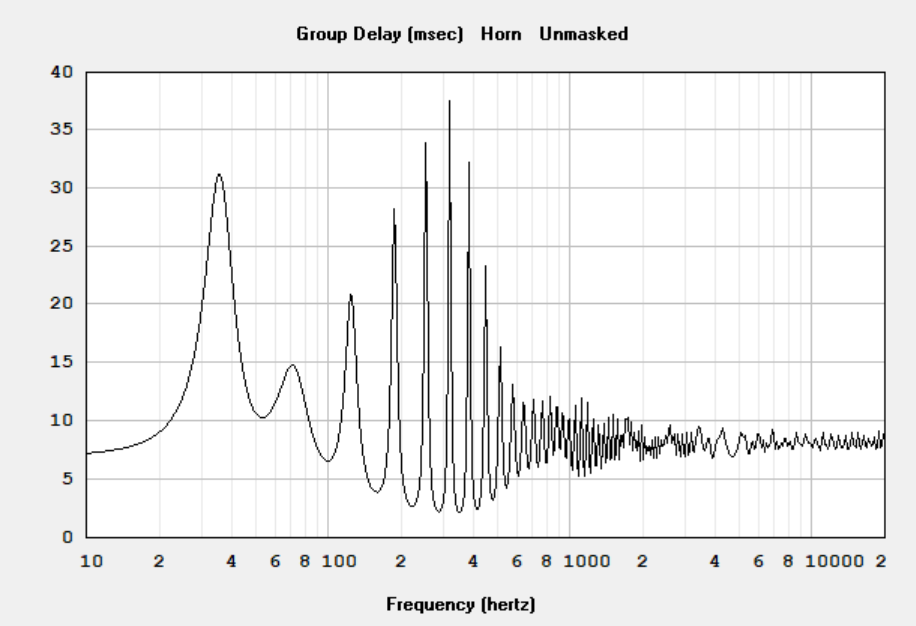

Hi all! I recently saw this post from @All_1 which prompted me to finally make a write up on this project. I started this over in the Speakerplans forum during Covid, but only recently managed to finish a build. I wanted to hopefully consolidate our knowledge on how to effectively sim boundary/baffle coupled style horns.
I've only had an hour to put sound through it, and got just one quick and dirty nearfield measurement so far. My laptop was then stolen so I lost some sim data and the measurement barring a few screenshots. I'll have more time in a few weeks which should hopefully include some outdoor measurements. Here's the build:

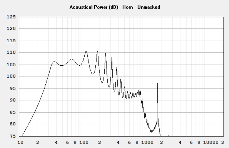

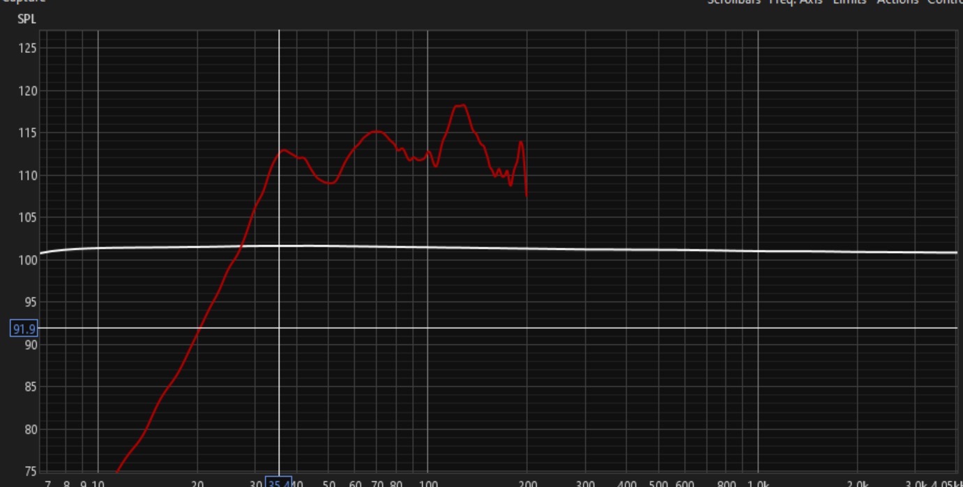

Here's the measured vs simmed response:
A few notes. I suspect the nearfield measurement is coloring things, hopefully making the response appear more like a 2pi measurement but tbd. Even so, a close response. The main thing for me was making sure that low corner was in fact there, since in Hornresp this required some guesswork (looking forward to diving more into this). The panel that's ratchet strapped on would start resonating like crazy at a certain point as well (I guess more reason to build the second soon) which more than likely also colored this not quiet measurement (UMM-6 tops out at 120dB I believe).

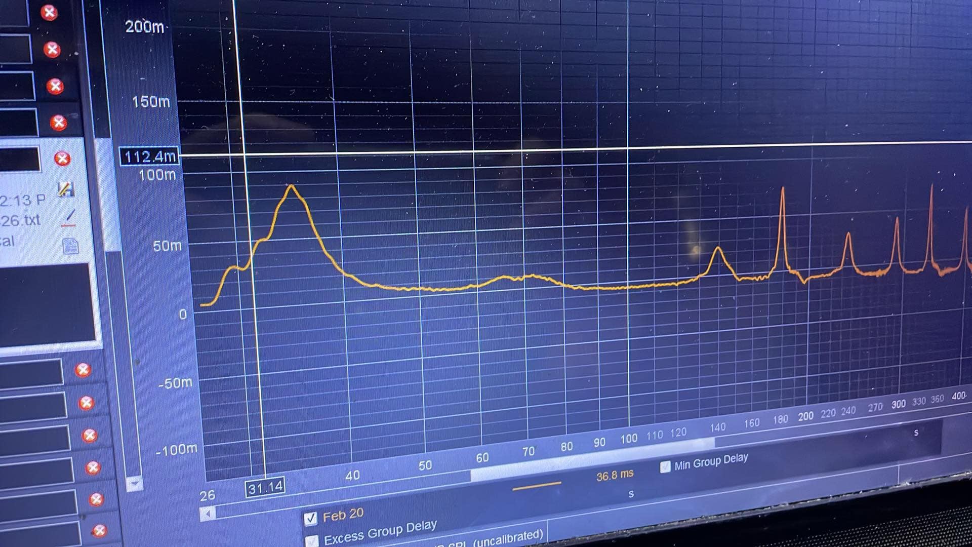

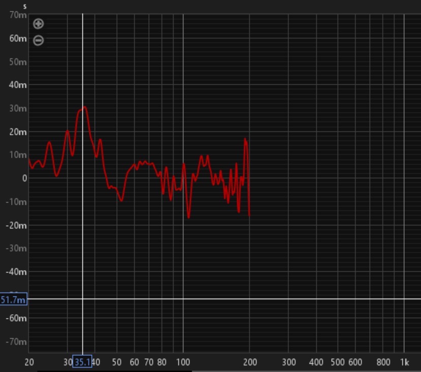

Here's the group delay measurement vs response:

Quick little update here. I was finally able to have a proper session this last weekend but due to snow was unable to get any outdoor measurements. Until I get those it probably doesn't make too much sense to try and correct the sim, but here's hornresp exported into REW to compare a nearfield measurement in 1pi. I suspect the rear chamber volume may be a bit smaller than initially thought due to the faster roll off and slight bump at the low corner. I was also unable to really push it at all due to windows and other objects rattling, but I'm certainly quite content so far (I'm sure builder's bias is playing a part). I ran a 32hz HP and slight bell cut at 67hz and I was even getting some decent weight from "Not Like Us", a root note of 30hz/Low B (that's low for the Grammy's!) This should be approximately 3 watts:

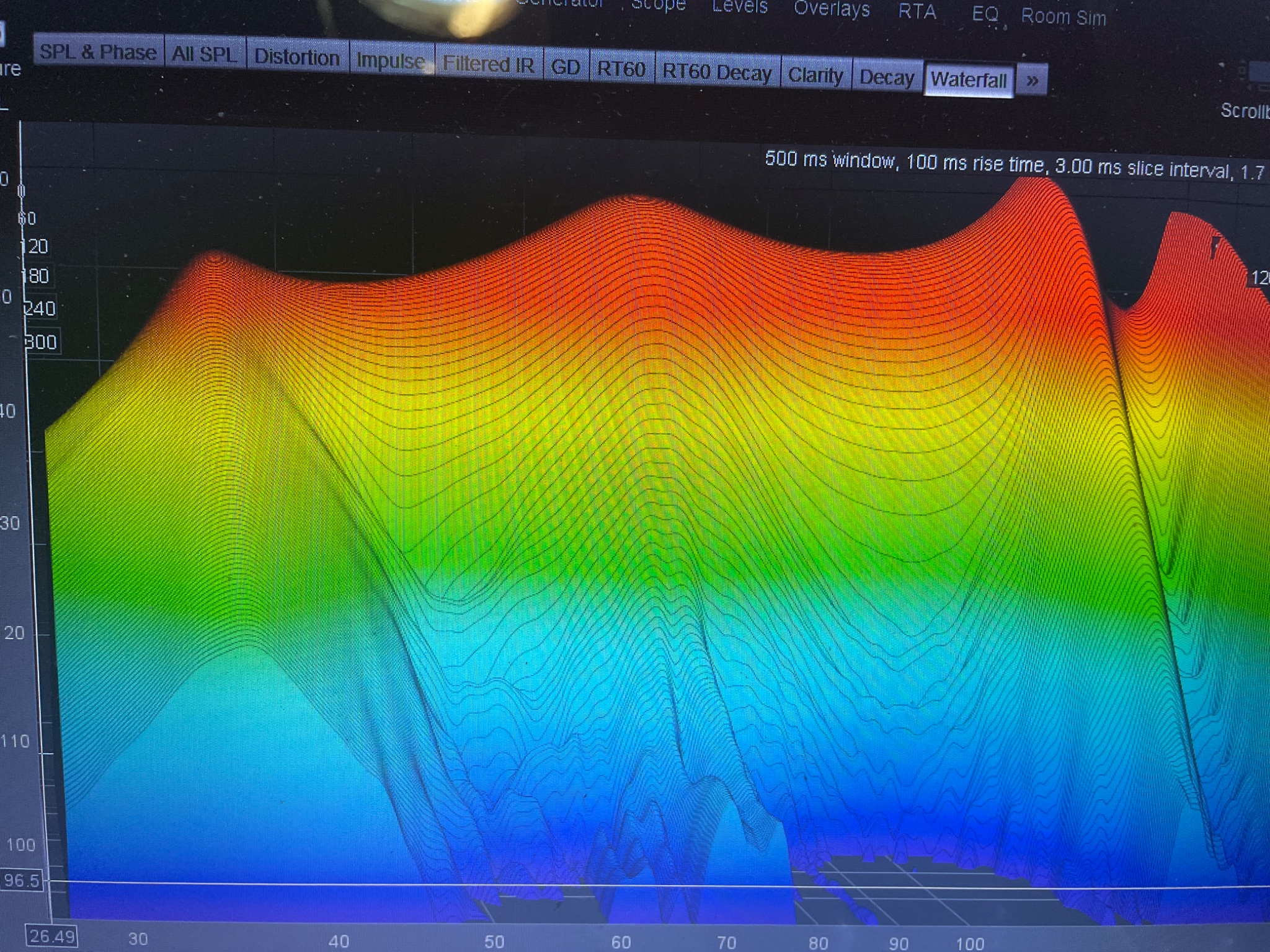

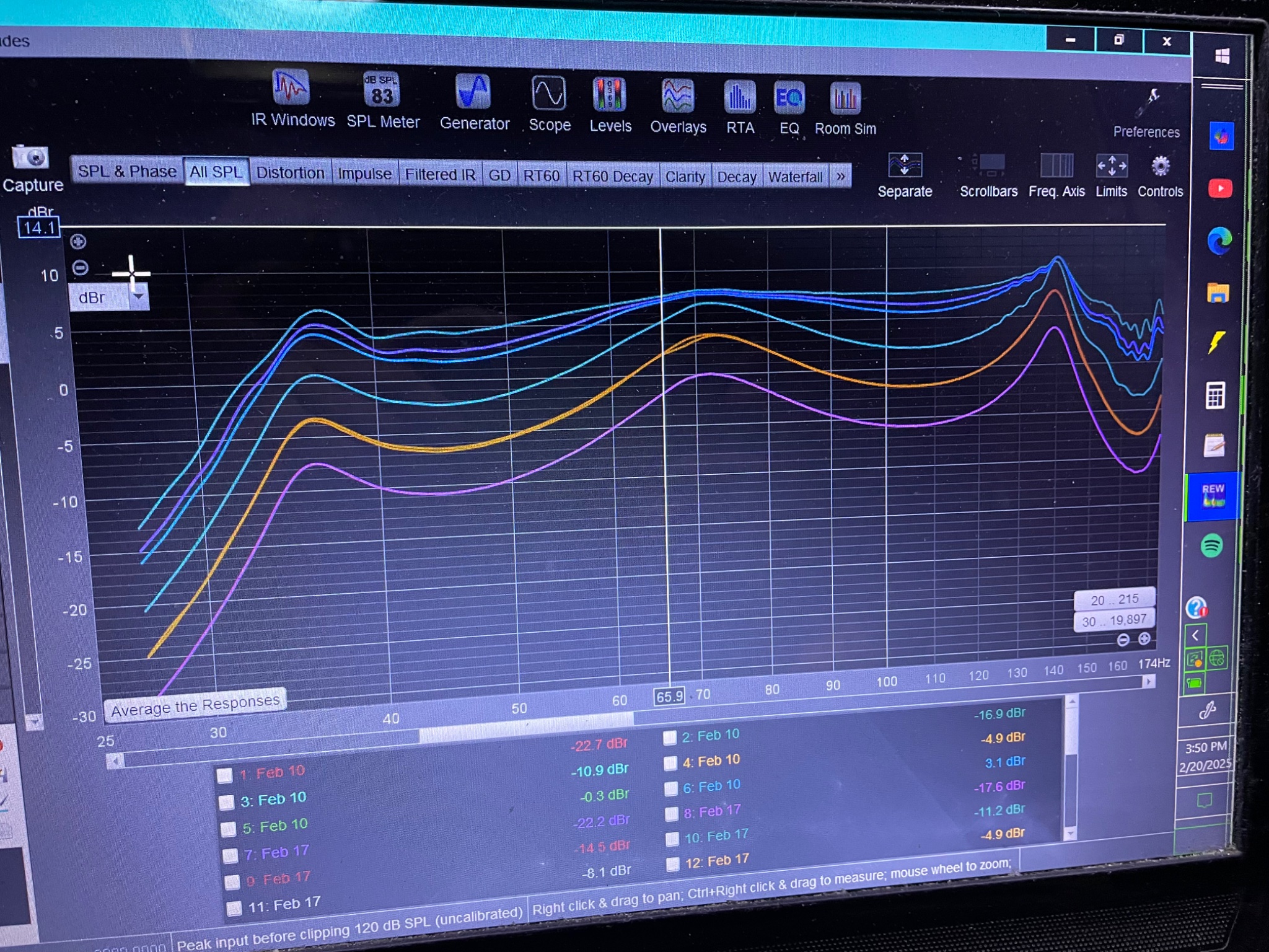

Do these sound a lot better than a tapped pipe since the other side of the driver isn’t creating a bunch of tomfoolery? Practically the same frequency response shape in mine, but it’s a goofy series qw pipe

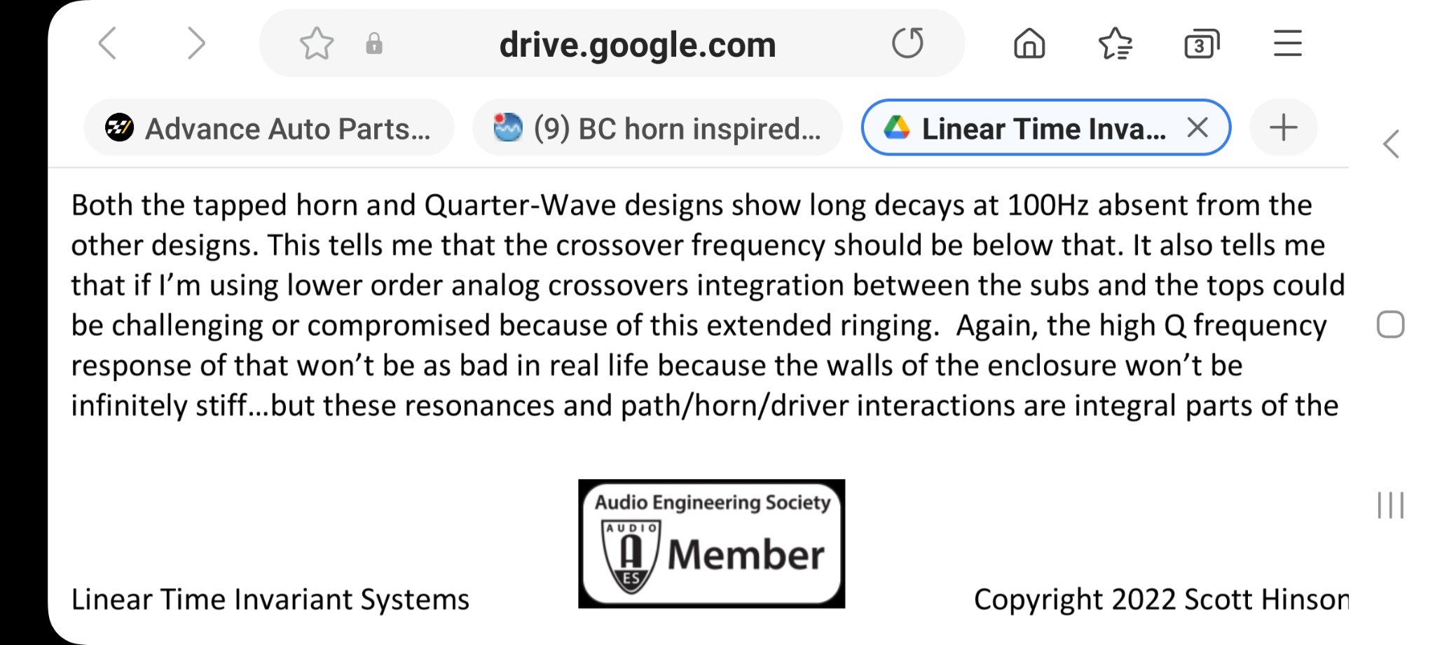

Woah neat! Very similar response indeed. Without hearing them side by side I couldn't say. It does look like group delay is a bit higher at tuning in the tapped pipe, but honestly I don't know of any reliable studies showing that you could discern the difference at those frequencies. Scott Hinson has a good paper comparing the different designs here: https://drive.google.com/file/d/1NJ06zwwOFmJIcNhJP6DEPeMqa8pnnKbS/view
