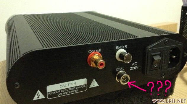

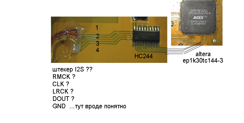

kuly Member Joined 2012 kdsdostup.wixsite.com/sarts 2013-02-03 12:05 pm #1 2013-02-03 12:05 pm #1 I bought... I want to understand where that? ? ? ..... where? ?Lrck?-BCK?-Dout?-SCLK-???.......i2s RMCK------is or isn't present Attachments 555.jpg 148.6 KB · Views: 80 IMG_7219.JPG 229.2 KB · Views: 77 IMG_7225.jpg 224.9 KB · Views: 78 IMG_7232.JPG 867.6 KB · Views: 88 ???.jpg 34.8 KB · Views: 80 kuly Member Joined 2012 kdsdostup.wixsite.com/sarts 2013-02-06 10:36 am #2 2013-02-06 10:36 am #2 production answered! ! ! if interestingly I report 0-GND.1-LRCK.2-Dout.3-BCK.4-MRCK (518fs) kuly Member Joined 2012 kdsdostup.wixsite.com/sarts 2013-02-06 11:13 am #3 2013-02-06 11:13 am #3 kuly said: production answered! ! ! if interestingly I report 0-GND.1-LRCK.2-Dout.3-BCK.4-Х there are versions is absent! ! MRCK (518fs) Click to expand... Status Not open for further replies. Share: Facebook X (Twitter) LinkedIn Reddit Pinterest Tumblr WhatsApp Email Link
