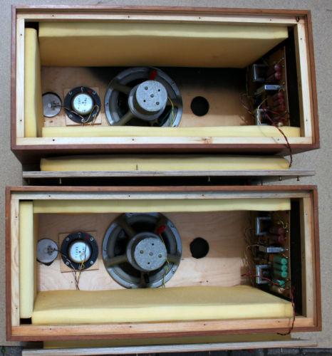

do anyone give practical tips how to assemble thin walled ply wood box if I don't want any screws to be visible? I'm going to saw pieces and cut side and bottom/top panels with 45 degrees angles so structure of ply wood shows nicely (no edges). Maybe I have to make "skeleton" of 20x20 mm bar inside the box. Front and back to be attached into that skeleton by screws. Front and back NOT by 45 degrees but like in BBC boxes. (like this http://www.sonicflare.com/01 - Harbeth P3ESR black and white - Title-thumb-600x324.jpg)
Yes, you have to build a frame to support it, preferably in beech and definitely not soft wood. Fasten the frame to the walls from the inside, and you won't get any visible screws. I used dowels and glue.
It's also recommended to use brass screws for fastening the front and back to the fillets.
Here is nice picture of old Spendor where frame is shown. It is easy to fasten frames to panels with short screws (and with glue). Harder is how to fasten sidepanels to each other if 45 degree angles are used and screws NOT allowed to be visible? It would be much easier if inner frames are done by one circular frame, not from 4 individual sticks.
Another problem is how to prevent box not to go into diamond. Maybe have to fasten back and front panels temporary to side panels.

Look up som photos of Harbeth, some of them show off the inside pretty nicely.
You can either build the framework and fasten the walls afterwards, or you can fasten the fillets to the walls and then glue everything together. No need for screws from the outside in any of those approaches. I went with the latter, and used dowels instead of screws.

About thickness, do you think that 12 mm baltic brich ply would be too thick if speaker dimensions are just 225x450x300 mm? Next smaller thickness is 9 mm, that is really thin but could it be better in this case (with 2x4 mm bitumen damping)?
I would normally never use the word ´fillets´, but it's commonly used in literature about the BBC cabinets. It's the wood used for the internal skeleton.
I've attatched a picture of the clamps I'm referring to. It's to hold the cabinet walls straight while gluing it together.
9 mm with 2x4 mm bitumen would fit the bill for your cabinet, no need to make it 12 mm.
