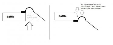

A couple of questions for Saturnus: you talk of the pipe created by front mounting, which is largely eliminated with rear mounting and rounding over the cut out. Firstly I cannot see how rear or front mounting the speaker alters the pipe. One has the pipe in front of the cone and one has it behind. Is it that the proximity of the frame to the cut out with front mounting creates what you refer to as a pipe?
Secondly, would rounding over the cut out when the driver is front mounted, eliminate a lot of the problems?
Third. A lot of the examples of rear mounting you give are professional monitors, and the measurements you refer to are at sound levels that most people in their homes would not listen at. At domestic listening levels are the problems less pronounced?

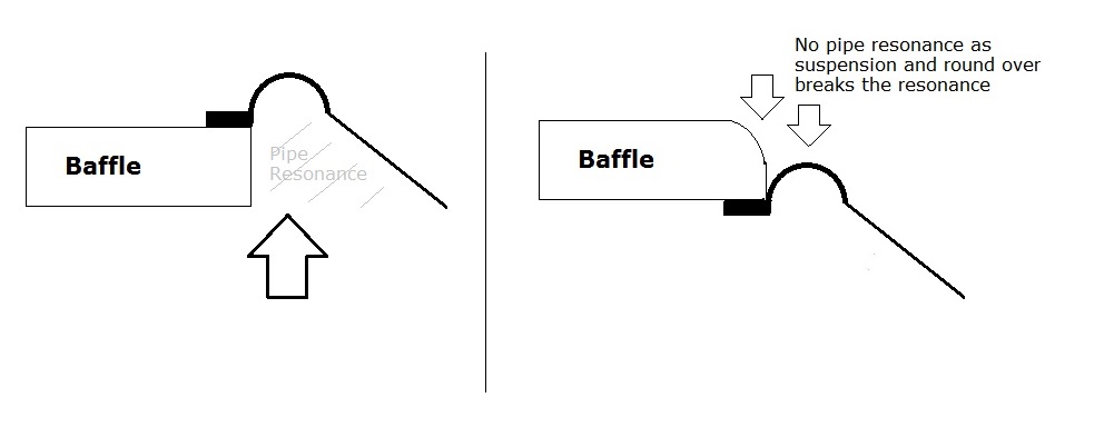

1) Forgive my lousy paint skills as I've tried to illustrate it. Also note that I have just placed the driver on top of (or beneath) the baffle. In both front and back mounting it is naturally better to flush mount it.
2) Yes, it would but not as much as just eliminating it.
3) The original question herein was for midwoofers. As they need to produce low frequencies the cone needs to physically move quite significantly which changes the physical characteristics. Measuring at 20V test signal equal 50W into 8 ohm. I don't think that is excessive peaks even for a home system (it corresponds to about 4W RMS with music signals). I'd figure it to be quite normal in fact. If a speaker designer only designs a speaker on how it measures with small signal values then how can he have any idea how it performs at reasonably expectable use conditions?

The cavity or pipe resonances may occur on the front side if the driver is rear mounted or on the rear side if front mounted. Rear mounting is, of course, the worse case as the cone can not act as a barrier to the effect. Cones are a fairly effective barrior, especially if cone mass is high.
Roundovers or flairs will help smooth response compared to front mounting, but even a wide flair, if deep, will impact response as directivity is increased for some band of frequencies. This is the primary reason why Genelec and others mount units in a large flair. They are trying to give narrower CD response to the woofer to widen a range of higher directivity.
This is a good approach if done well with a long and well designed flair. Just rear mounting a unit behind a baffle thickness is not the same, though!
